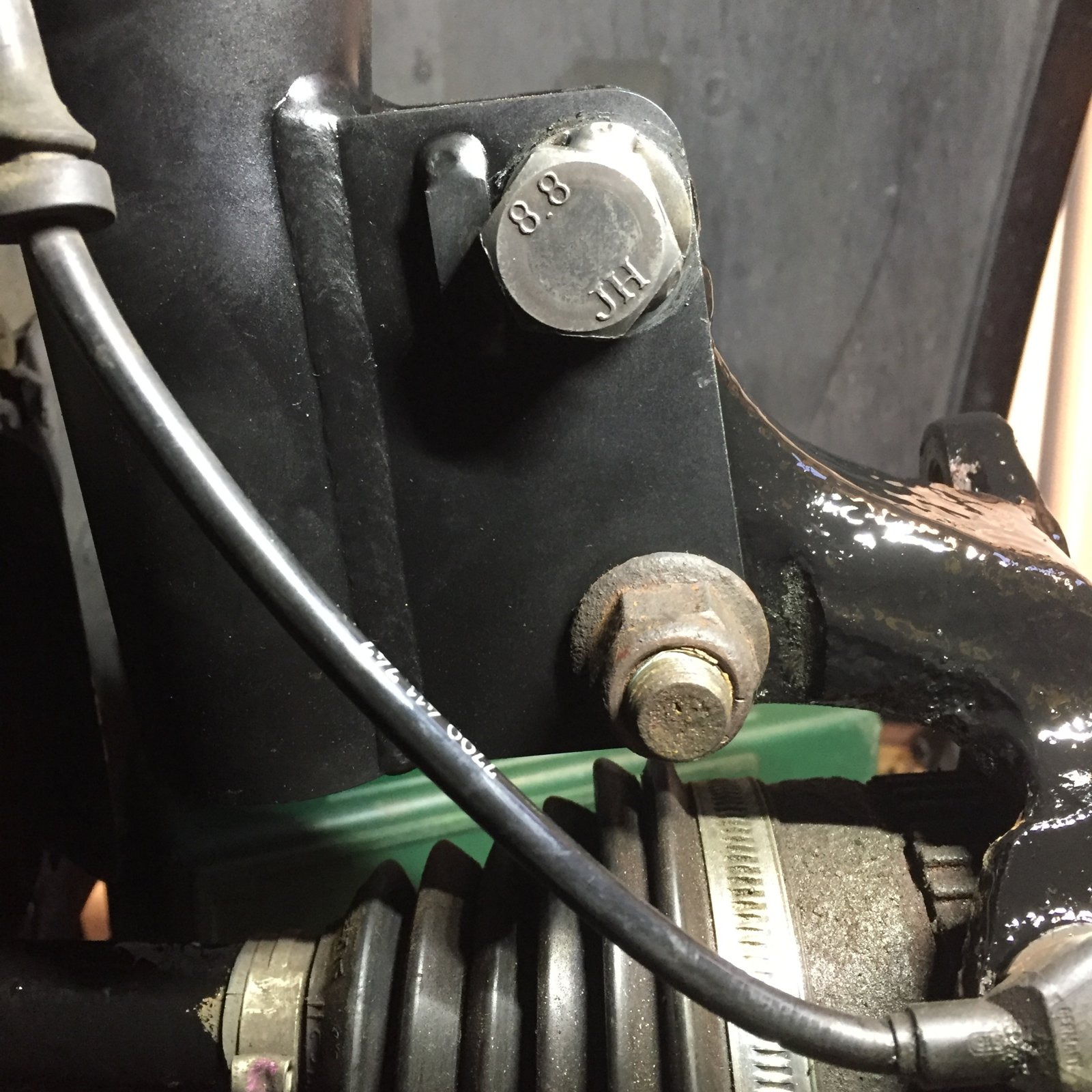

Evening people, is anyone running camber bolts with gaz GHA coilovers? I’m finding the little tab seems to get in the way. I can’t achieve more than 1.3 degrees of camber and don’t understand why. I’m using Eibach bolts. Any advice/help would be great. Thanks
Removed these?
Yeah just gets to a certain point and locks out, didn’t want to have to grind it off but might just bite the bullet ?
Let's have a look at how you're fitting them.
And how are you measuring camber?

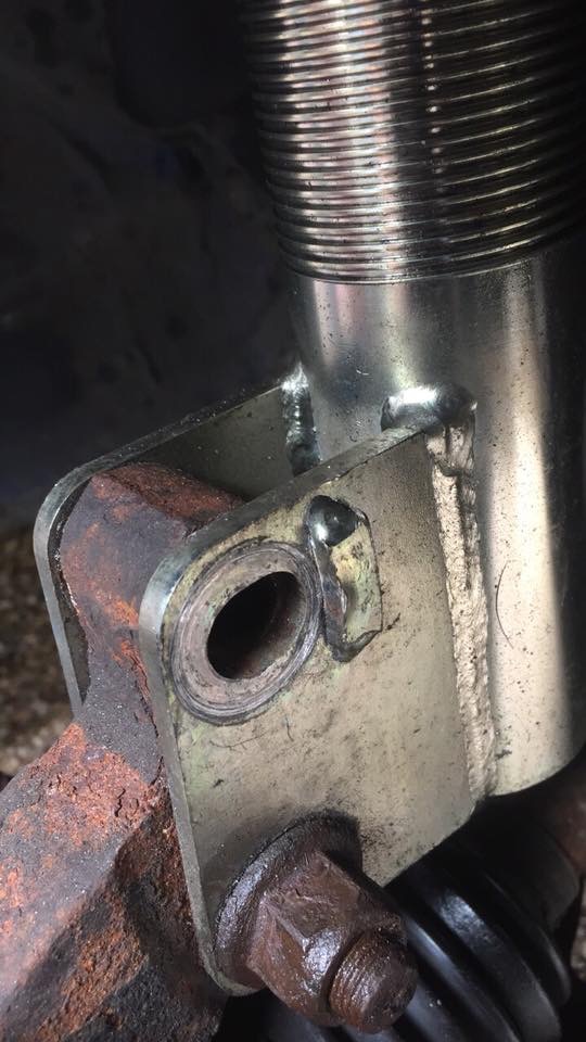

I haven’t got any pictures on my phone foolishly. Camber was measured on a hunter alignment machine. Here is a photo of said ‘tab’ though.
Someone has done it to use the style of camber bolts with the offset washer on the heads like Jap cars run.
I'm a bit late on this thread but I've got GHA's on my 172 also... went to fit SPC camber bolts and the washer that comes with the camber bolt was hitting the welded tab. Am I right in thinking it is fine to run the camber bolts without the washer provide? Sure I read that somewhere. Cheers
