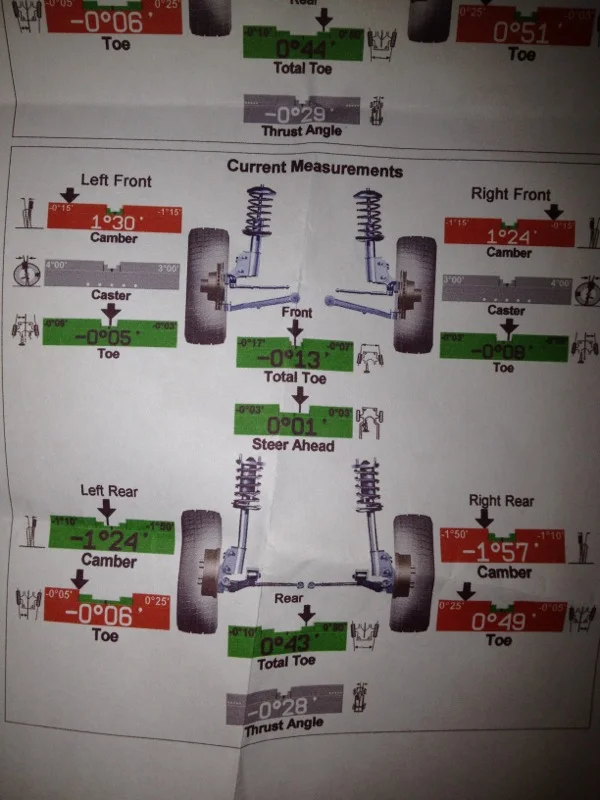

Just got back from getting tracking done and camber set up. Got a problem though that I hope someone can help with, basically when the steering wheel is straight the car is pulling to the left, but I'm confused as ive just had the tracking done and got print outs and stuff. Camber has been set up to 1.5deg as recommended on here. Can anyone help?
The people said the car is too low for the 205 45 tyres on it at the moment and recommended me getting 195 40's , would this fix the problem?
P.s car is lowered 60 front 45 rear.
  182/RS2/ Turbo/Mk1
Take it back, they just need to wind one track rod in slightly and the other out slightly so that the overall toe is the same but that the wheel sits straight.
Before doing that you could really spin the wheel all the way from one direction to the other and make sure that its straight when the rack is in its central position, ie that it has exactly the same number of turns from central to fully left as it does from central to fully right.

That is the current settings
  182/RS2/ Turbo/Mk1
Rear looks bad but sadly its not as easy to adjust, front looks ok though, ideally it should have been camber of 1'30 both sides (1 degree 30 minutes = 1.5 degrees) but thats certainly pretty close.
Looks like the reason its steering slightly left is just a lack of accounting for the unstraight rear when they did the front, im sure if you take it back they'll adjust it for you mate, they're normally pretty good at protyre places IME

Ah, looks like the same sort of printout most protyres give.
Im sure the same will apply thoguh if they are a decent company, they've not quite done the job right if your car is not going up the road straight with the wheel straight.
But like I said, check the wheel is actually on straight first!

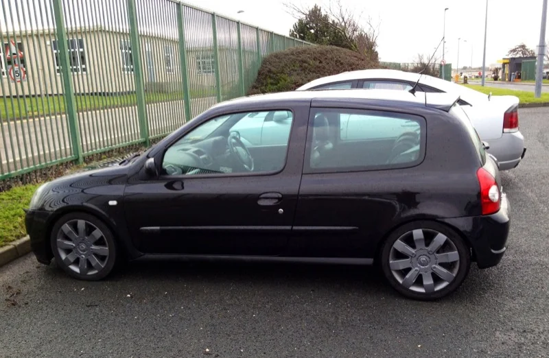

Just a quick shot at work, sits a lot better, very happy with them. Not sure whether to get the wheels done black or not, quite like the anthracite on that photo lol
  182/RS2/ Turbo/Mk1
Does look quite nice at that height, although personally I'd have probably not gone quite as low as that myself.
