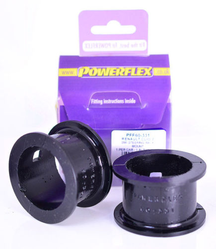

I have the same thing was steering bushes replaced both full steering arms and was fixed, the bushes looked fine aswell

Steering rack bushes or the steering rack clamp bolts have come loose.
