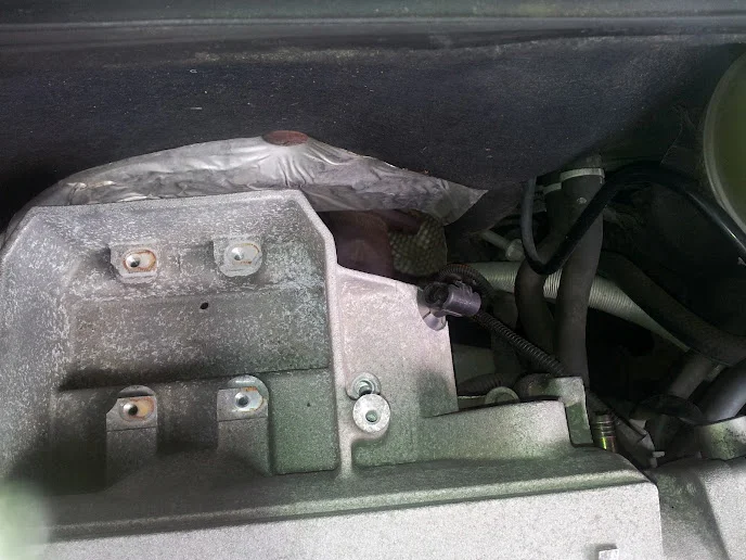

coil pack had nothing to do with securing the plunum to the engine. I think you've missed the 2 bolts at either side at the rear of the plenum
