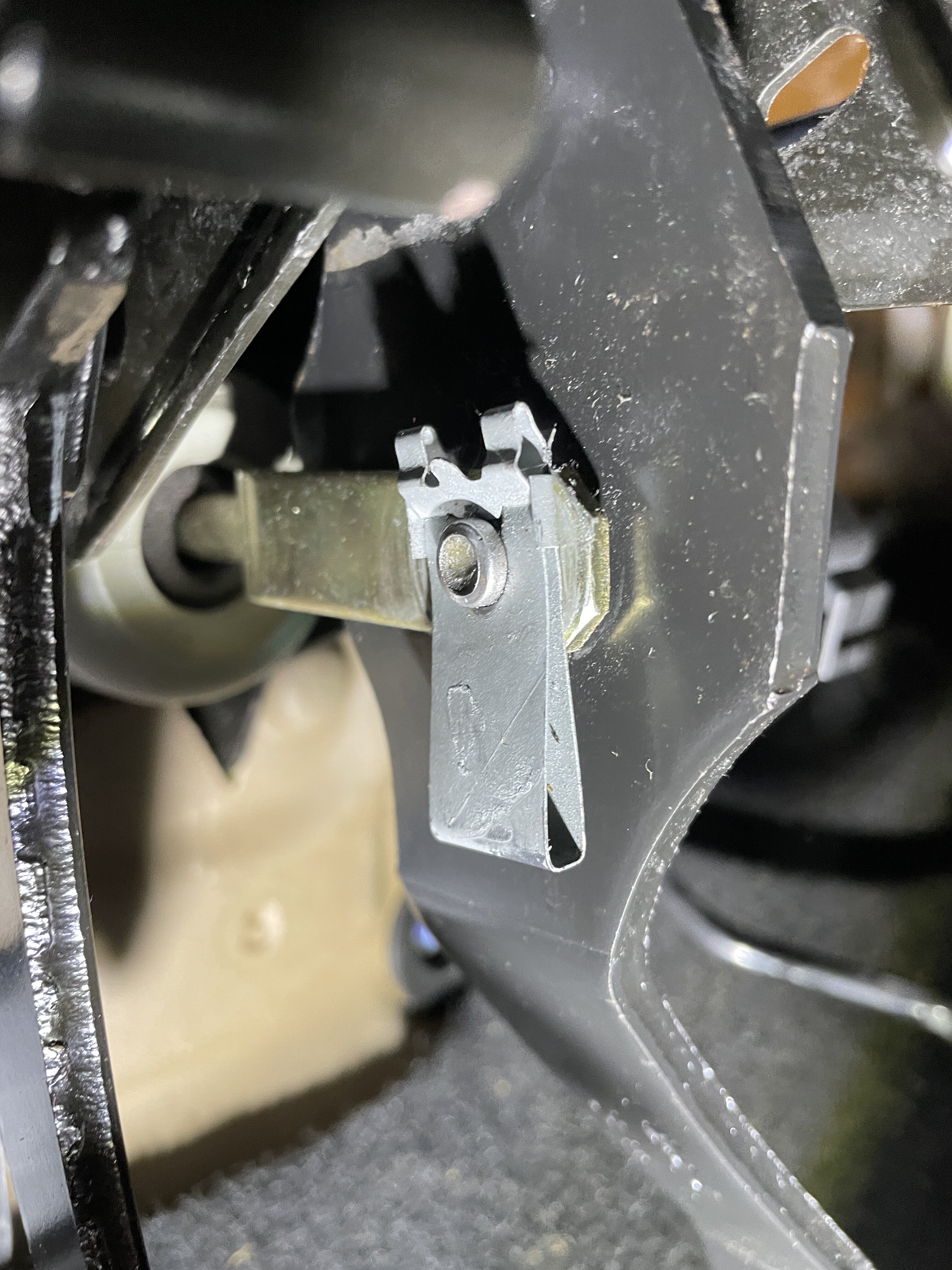

What I cant figure out though is how to remove the clip that holds the fork from the servo onto the brake pedal. Any one have any ideas?
Anyone know how that is removed?
  A6 Avant BiTdi, Z4MR
Sorry, probably not explaining it so well. When you push the socket onto the ball, it takes some force, then suddenly it 'pops' on. That was what I meant with the click. One of mine on the new linkage now takes no force to push on, so is lose, which I could probably live with 'IF' I could get the clip on, but I can't, hence looking at removing the pedal box, and at that stage I will fit another new one, so everything is tight with or without the retaining clip.
Just after anyone's experience of removing the clip in the photo - not sure if it just pulls off, or need to lever it upwards, so a new one is needed on refitting, which would allow the brake pedal to be detached from the servo bracket/forks.

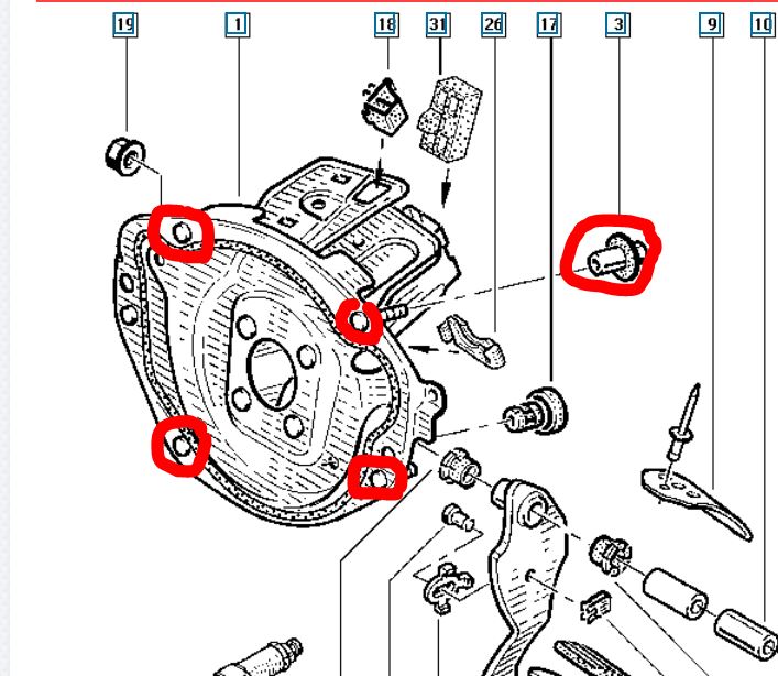

Found a picture of one removed
It looks like there may be 4 nuts holding the pedal box to the bulkhead

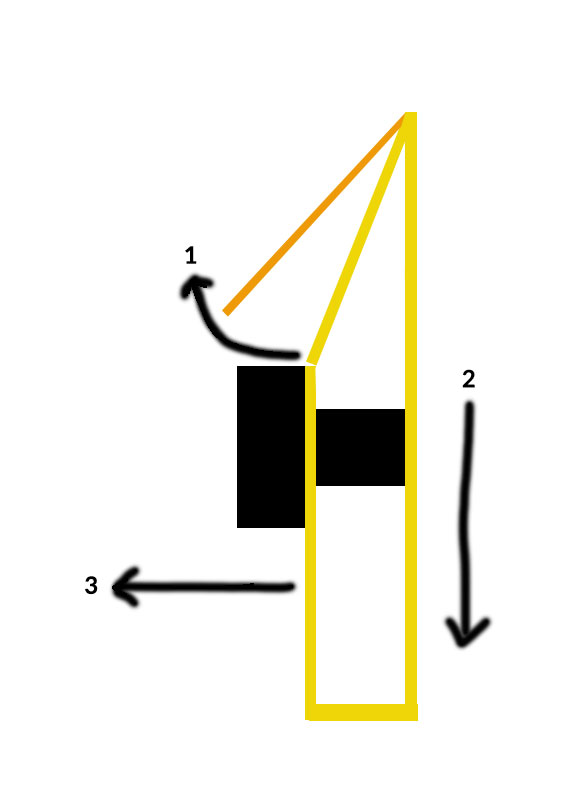

Looking at the clip, it looks like the top part of the clip pushes against the collar of the bolt to stop it sliding off.
So you'd just need to prize forward the top part of the clip over the bolt head so it's clear, then pull down on the clip and then forward. Long nose pliers perhaps?
Hard to put in words really.
Thanks, that is really helpful. Thinking I'd probably sprain the clip removing it, and as you don't want the pin to drop out of the brake pedal, I have ordered a new one to fit on replacement.

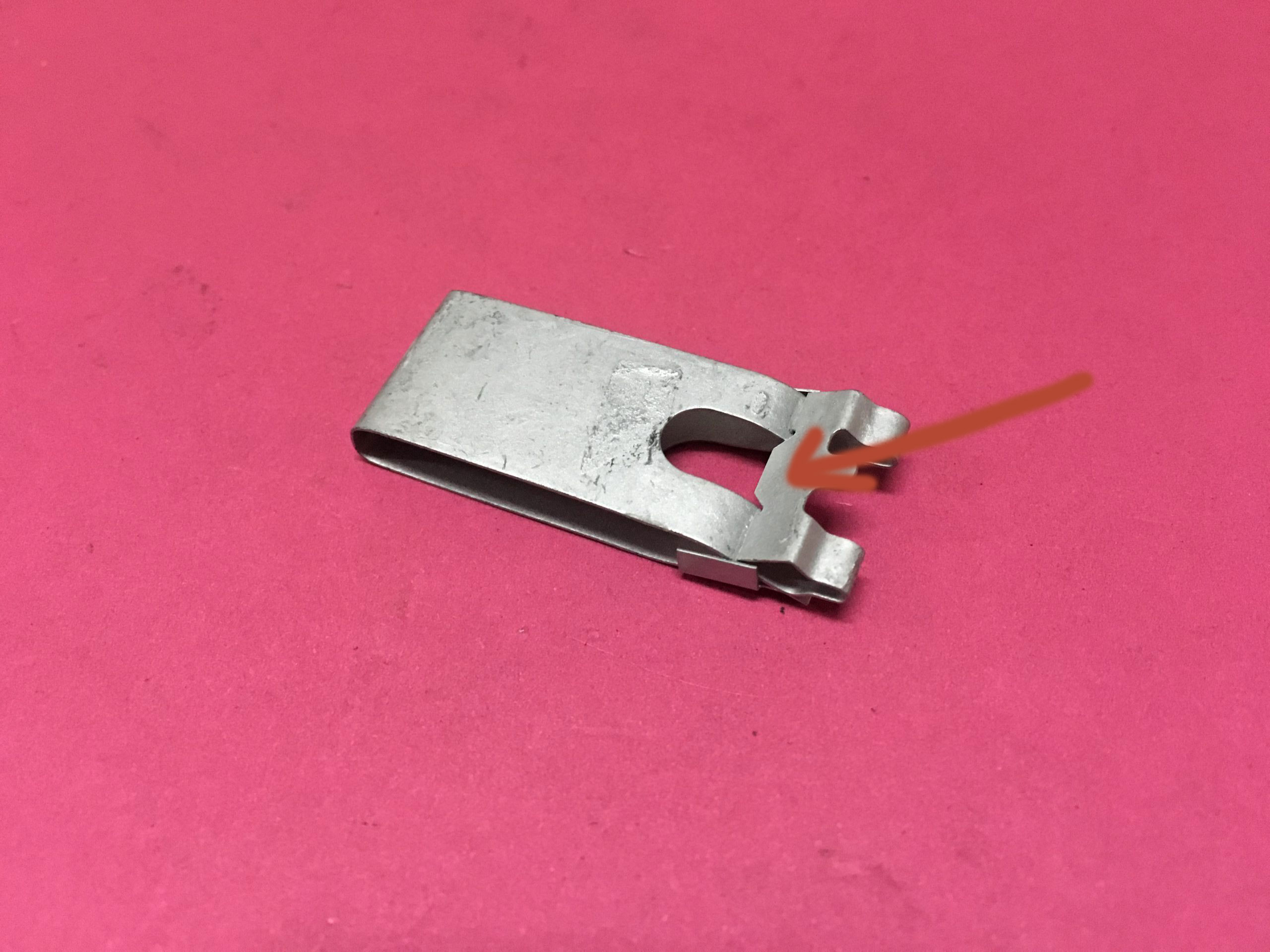

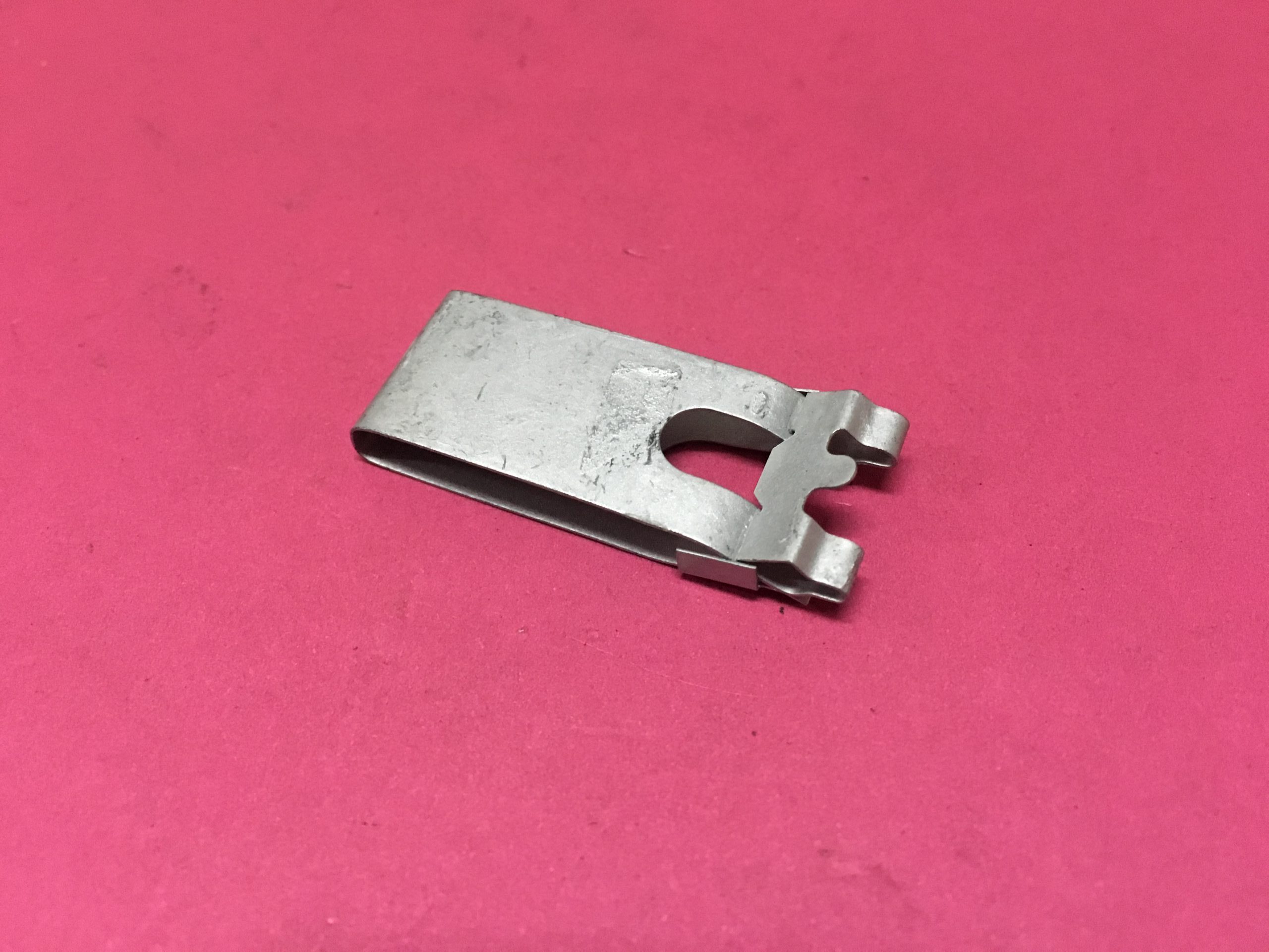

Just wrapping this up, the clip does come off as suggested, lever the front section up, and it slides off.
I fitted a new one on re-assembly, but probably not required, no levering required, it just slides on, and clicks once past the lever up tab.
