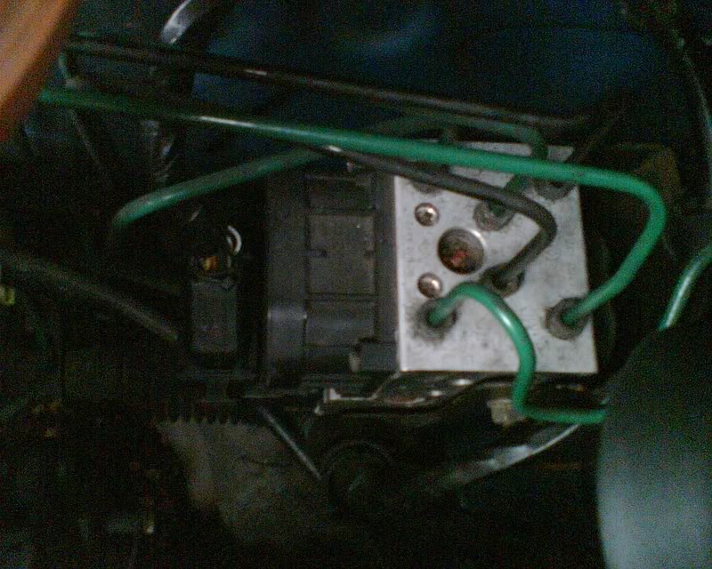

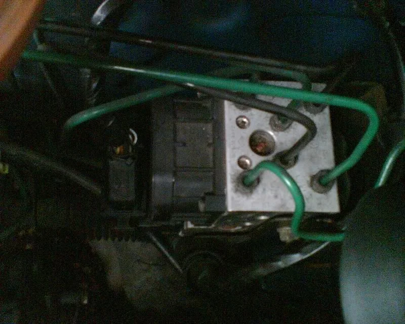

Dan - do you mean this metal box? Remove the green wires, then under them the wiring will be damaged? The engine wiring loom was replaced a year last june under warrenty.

no, thats not it mate. I know there is a pic on here somewhere of what i am on about, hang on i will try and find it.

Also for future reference the pic in this thread is of the ABS distribution block.
this is the gay thing that rubs through the loom
  K20 EG Hatch
if ur looking at the block, its at the back, think of the part in his hand but the other way round lol, u cant miss it, seriously!
