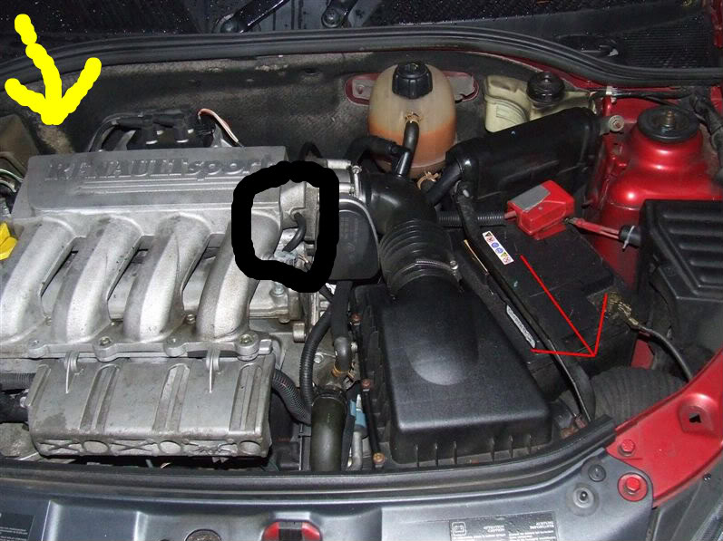

Picture this on the car
That smaller pipe goes behind the coilpack, almost underneath it.
And this one
Circled in black, I think if that ones disconnected at either end it causes high idle.
  2003 Clio 172 Cup
My pipe is definitely connected to the point underneath the coilpack. The other pipe that you have circled in black is also connected, but I dont know if the other end of this pipe is connected properly.
Could this also be the cause? And where does the other end go?
And this one
Ah i'm with you now ;)
That doesn't make a difference on mine when removed. The front one will though.
