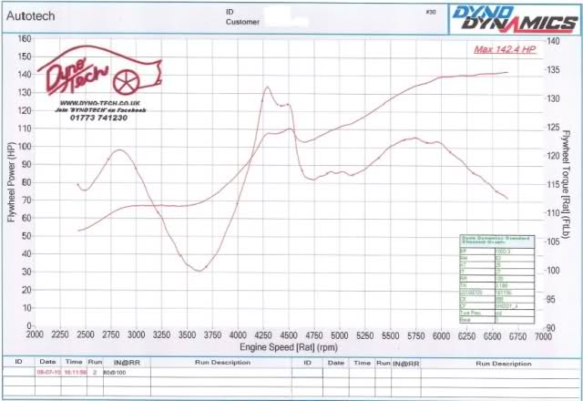

I have had the car on the dyno today (dyno dynamics) and it pulled 142.4 bhp and max torque was in the low 130's, but the torque curve is absolutely all over the place at 2800 it is at around 120lb/ft.. this then drops to just under 100 at 3600 when it rises sharply to 132 ish at 4300rpm then drops again to about 115 at 4750 rpm. Will upload images when i've scanned the graphs in on monday.

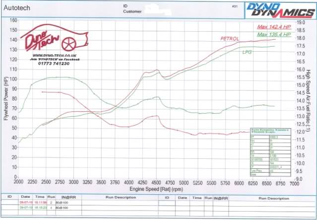

My car first went into the garage just before christmas and I've took it to several places to try and get it to work and it's cost me a fortune and none of them seem to know what's wrong with it. I was convinced it was all in the map but the AFR seems fine (will post images as soon as i've scanned them). I know my car needs a remap but obviously I want it working properly before it gets done.

Above are the scans of the dyno run. As you can see the car also runs on LPG, the LPG is set up pretty well and is not the source of any of my problems as it behaves like that on petrol and LPG.
Today I have bought a new TDC sensor/crankshaft position sensor and replaced it and it make no difference.

Petrol AFR is the lower one, not the higher one as described in my post earlier. Im red green colour blind and the lines are red & green so sorry about that!
Just had another attempt at the pics.

that's running very rich which will lose you a fair chunk of power. I'd put it mostly down to the ECU having the wrong idle parameters for 172 cams tbh. You're going to need a full custom remap, it's not going to run nicely until you get it done
