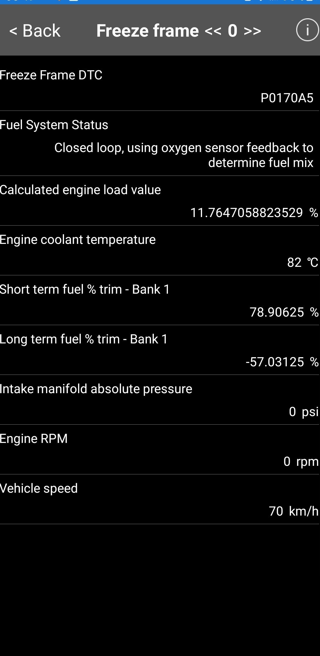

Hello all, I'm having troubles on low rpm about from idle to 1200 when i accelerate engine shakes and is dying sometimes it can cut off. When i keep this in mind im able to drive normally. After clearing codes these always come back in one day then car is sluggish. I have replaced many things like: coilpack, spark plugs, throttle body, both o2 sensors, valve adjustment, new timing belt and water pump, new air filter, new seals on inlet manifold, rocket cover seal, new battery, new map sensor, new crankshaft position sensor, new knock sensor. Pressure on cyliders is about 13,5 to 14 bar on all. Fuel pressure is 3bar constant. Car starts like it's new either cold and hot. It's not taking oil at all. Freeze frame always has weird values like for example here 0 psi map sensor and 0 rpm. I really have no clue.
one thing i find weird is like cracking one audio speaker i though it's maybe weak signal and it didnt bother me thst much it's not very loud. Can it have connection with my main problem?
