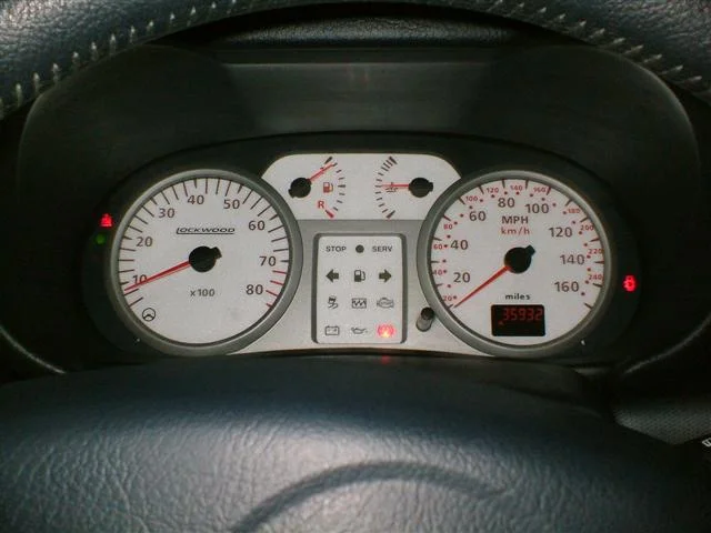

i just changed the plastic sheet to a richbbrook one, basically get the dails unit out , lever the needles off , swop the sheet then replace back

thats with lights on but i had flash on too , in day the writtings in black

looks good bojo, how hard is it to take the needles off, and get them back on? How do you take the black sheet off? do instrcutions come with the kit?

at night they just look like standard ones , e.g u carnt see the white n numbers are in amber orangy ,
once u get to the needles use 2 spoons n lever em off, they will feel slightly stiff just be gentle as u can, to replace by pushing back on, but not allway
when u get em make sure all the side airbag , fog lights all match up , i had to cut mine as 2 was in different places.
the original sheep is stook on but peels off faily easy
the instructions provided are good , sept there made for a mk1 dash and the mk2 has some extra srews behidn the silver twim
