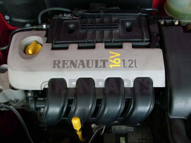

Is the engine in yours a D4F712? does it look like this.
If so, then there are plenty of guides for the things you're looking to do.
