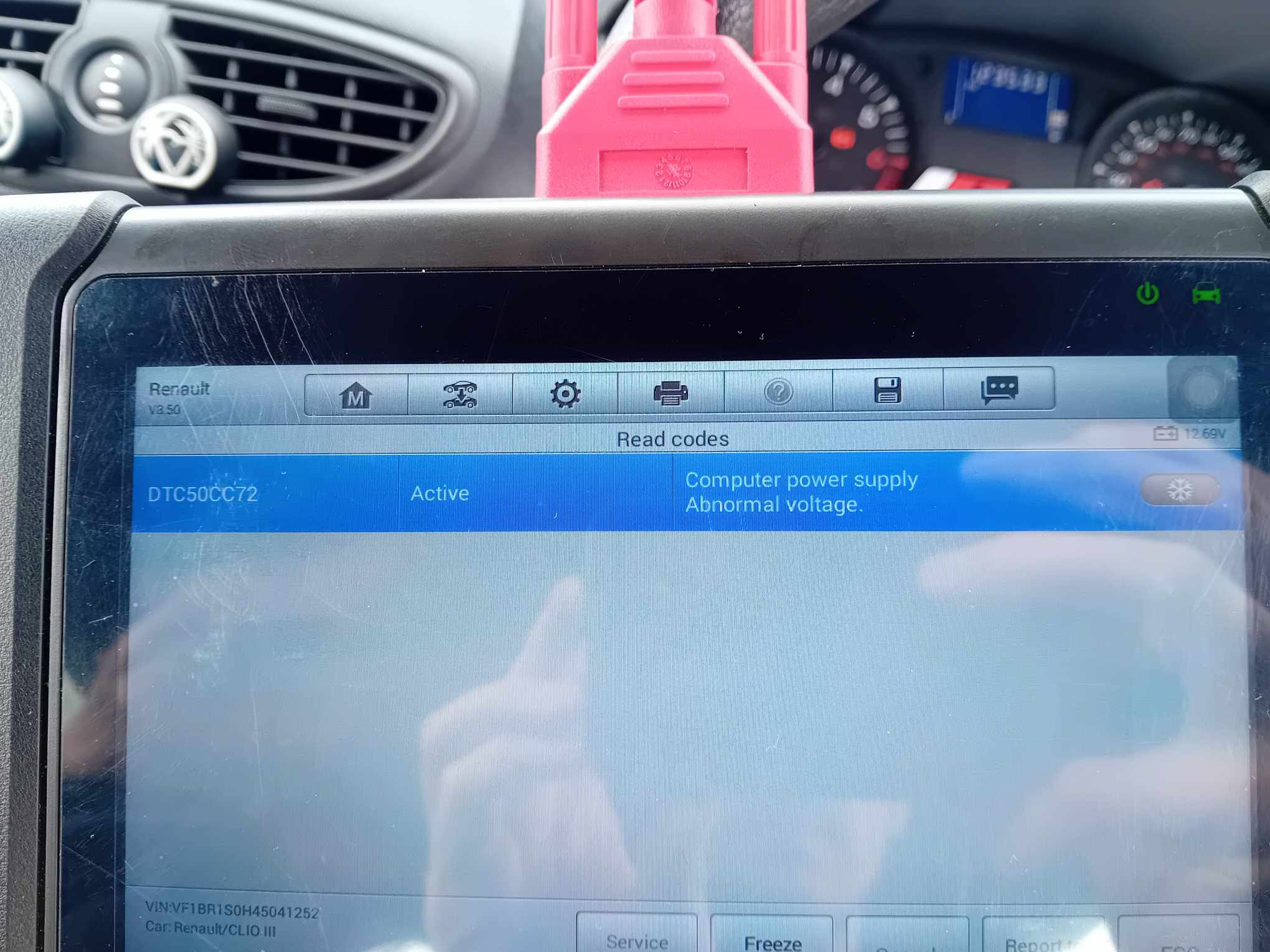

The ABS module isnt happy either after the last battery draining and dying, it throws a code saying theres low voltage to the module - code: DTC50CC72 (photo attached too) - when i turn the ignition on, the car beeps at me twice, the ABS light is on, service light is on, stop lights is and orange EML is on, but would this lock out my starter circuit?

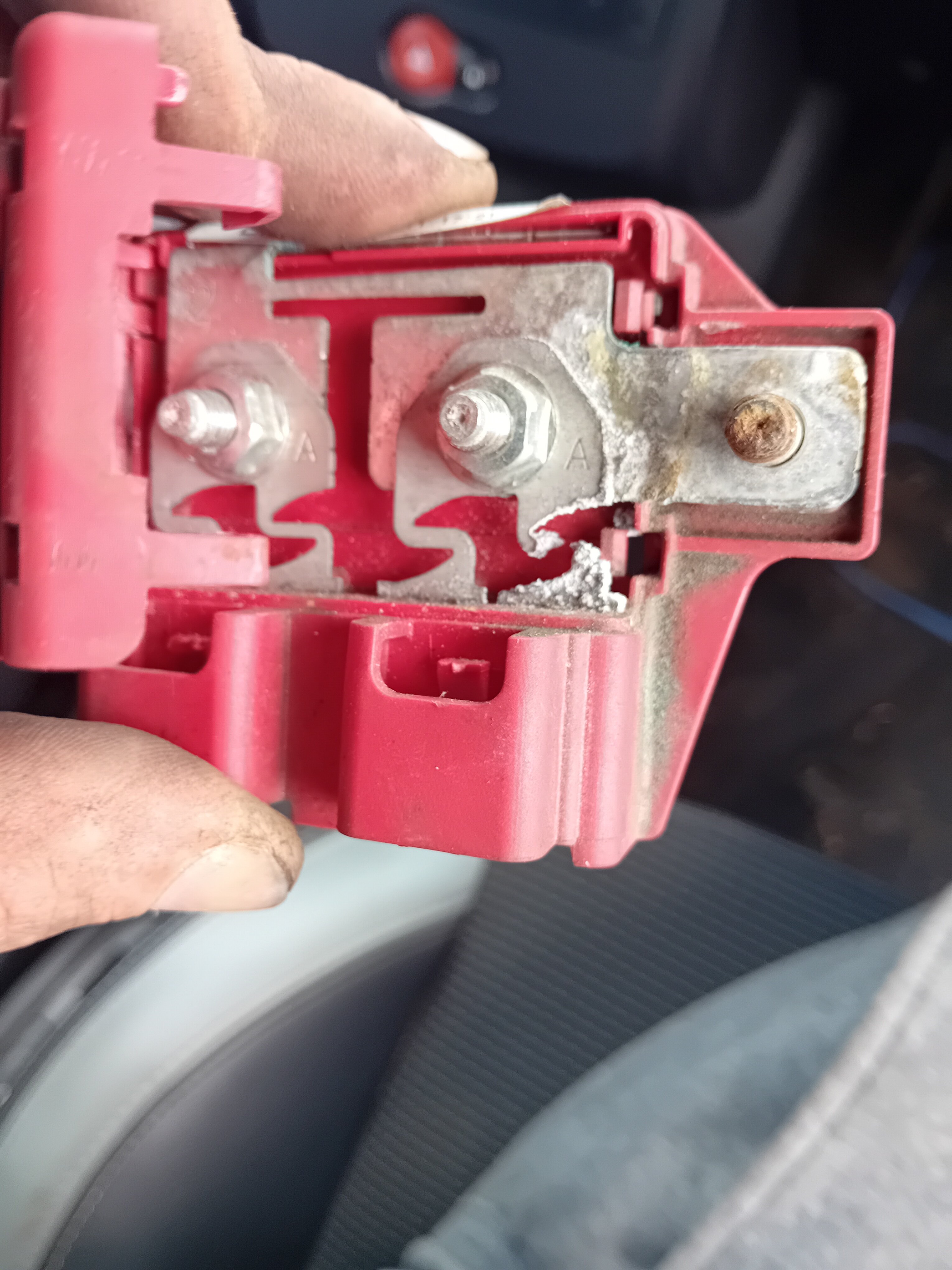

Never mind, the terminal fuse is goosed
Put a jump lead on the battery negative to somewhere on the engine block will tell you if it’s an earth fault.
Immobiliser light flashing at all?
Ive just found a knackered main fuse... which i didnt even know was a fuse! I live and learn...
Immobiliser was flashing, goes off as normal though.
Im gonna get another fuse and HOPEFULLY i have a working car after that!
Cheers for the pointer RSRowe 🤘
No problem. Just double check you haven’t got any cables which have rubbed.
I’ve seen it twice now where they’ve rubbed through and arc out on the block.
