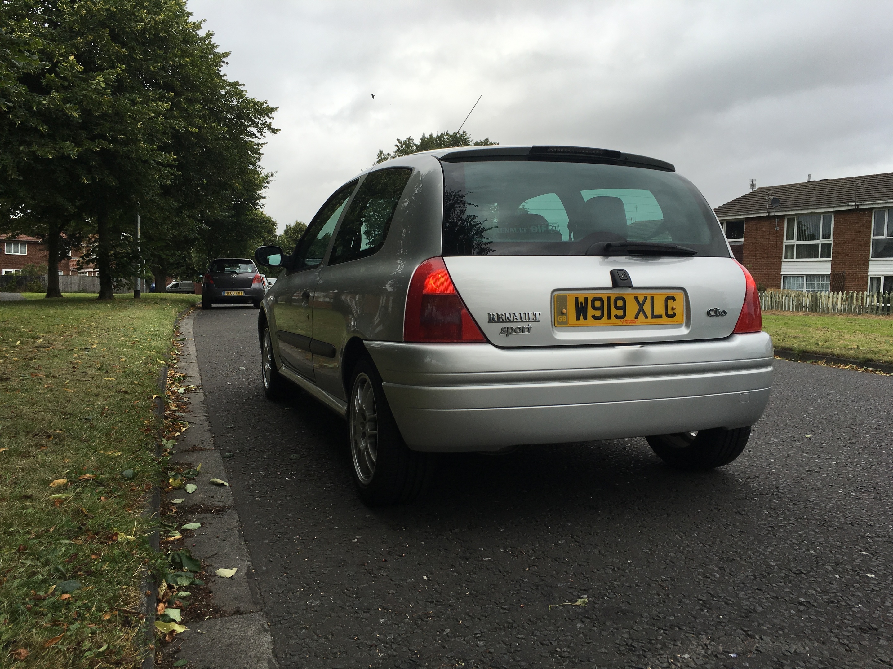

In 2012 after a 2 year gap of owning a performance car (2 young kids), I realised I was missing my hothatch addiction and so set about scouting the cleanest ph1 I could find.. with the rule being it had to be fully standard... after a few months I landed on this one with 72k on the clock and a full Renault stamped service history...
So... roll on 4 years to 2016 and it's now on 103k miles and has been rock solid.. never let me down and drives great...

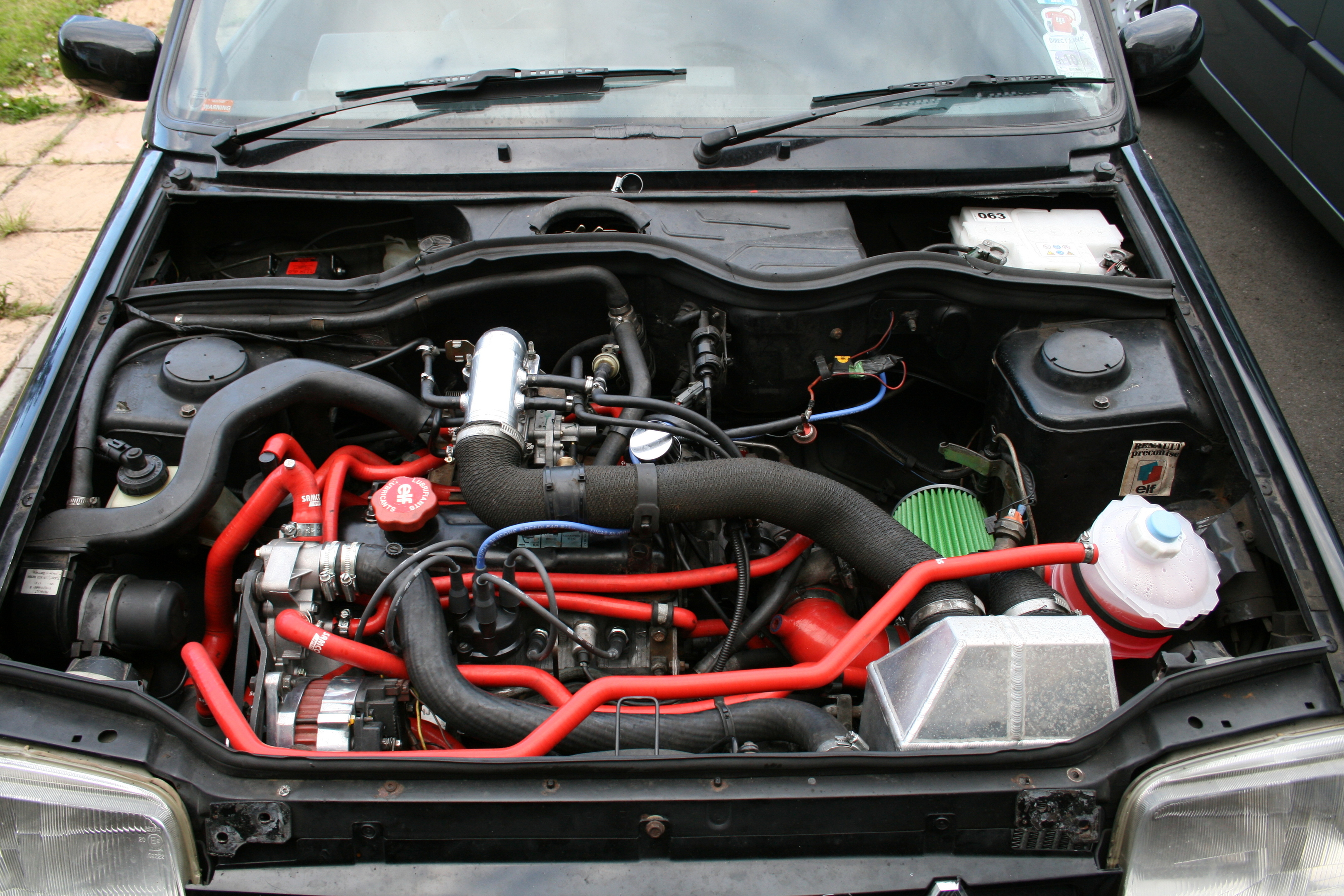

This was my last effort on my 5 turbo (sold 2010)... complete full engine rebuild, pistons, new carb, electronic boost controller... I have no idea why I decided to sell it... took £2k for it, now probably worth £10k... 1 lady owner from new etc... hoping the turbo ph1 will help me erase this life mistake.

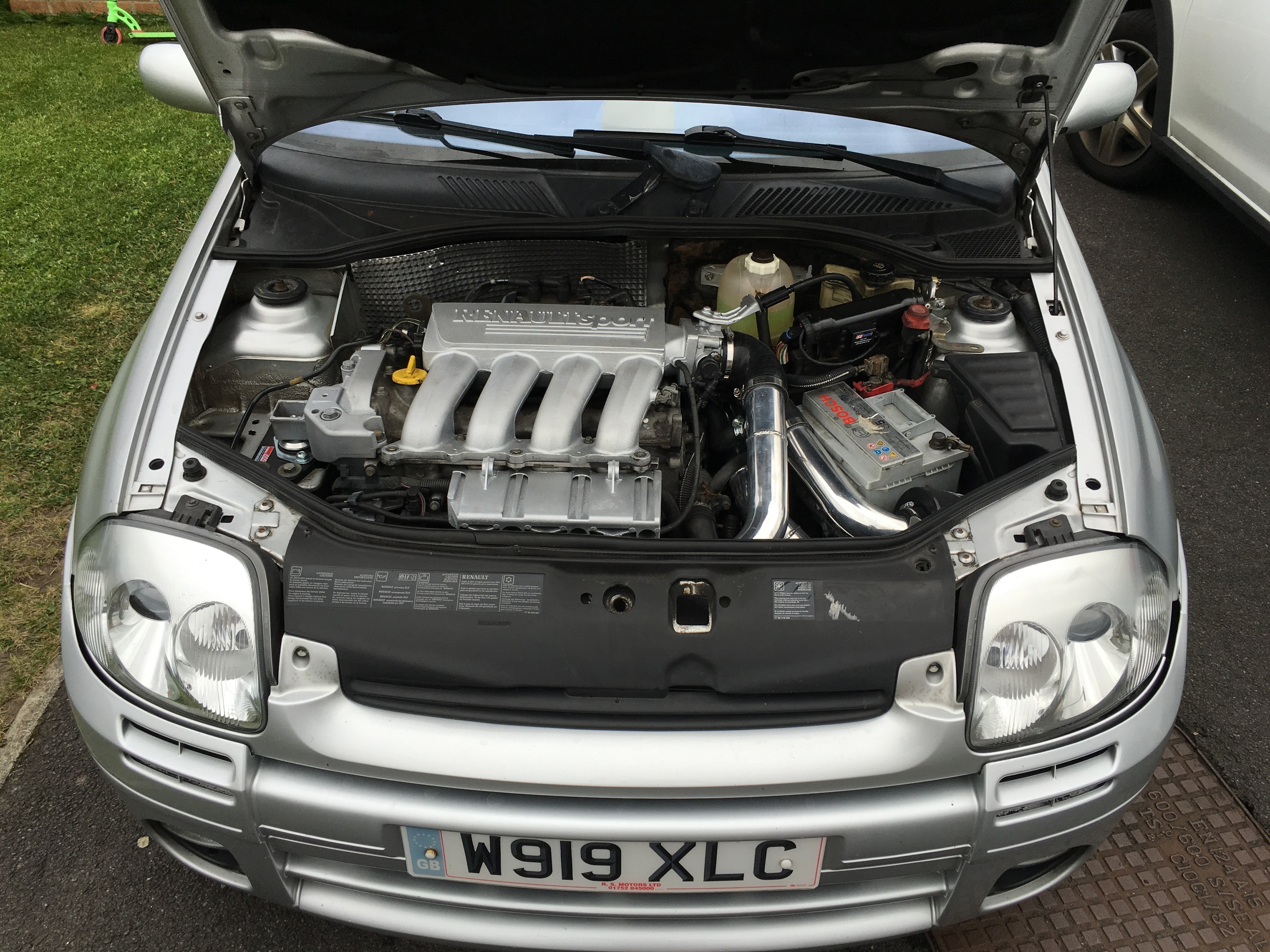

Ok here we go...
So engine converted with the following spec, work undertaken by clioturbo:
  • Garret GT2554 turbo, cast manifold, megane 225 injectors, front mount intercooler, airfilter
  • EFI ECU Module running 8psi
  • Stainless steel downpipe / decat
  • New valeo clutch kit
  • Aircon delete kit / new aux belt + tensioner
  • New cambelt + dephaser fitted
  • New radiator fitted
  • Vibra-technics engine mounts
  • Custom heatshield around turbo/exhaust downpipe
  • new spark plugs, oil, filter
Whilst engine was out I also had it generally cleaned up, I had oil leaks in both the sump and the gearbox which were rectified during the conversion.. rolling road gave slightly lower figure than the expected 230bhp and was attributed to the current crappy eurocarparts exhaust system by Chris @ EFI.
Due to a slightly sticky throttle body, this was taken off.. cleaned up.. adjusted and refitted by myself.
Next plans are to get a performance 'ph1 stealth' type exhaust to help release the full power, boost gauge has been ordered and to be fitted... also have new clutch and accelerator cables to fit. I also have a slight bit of bubbling on the roof which needs some paintwork attention... booking in this week.

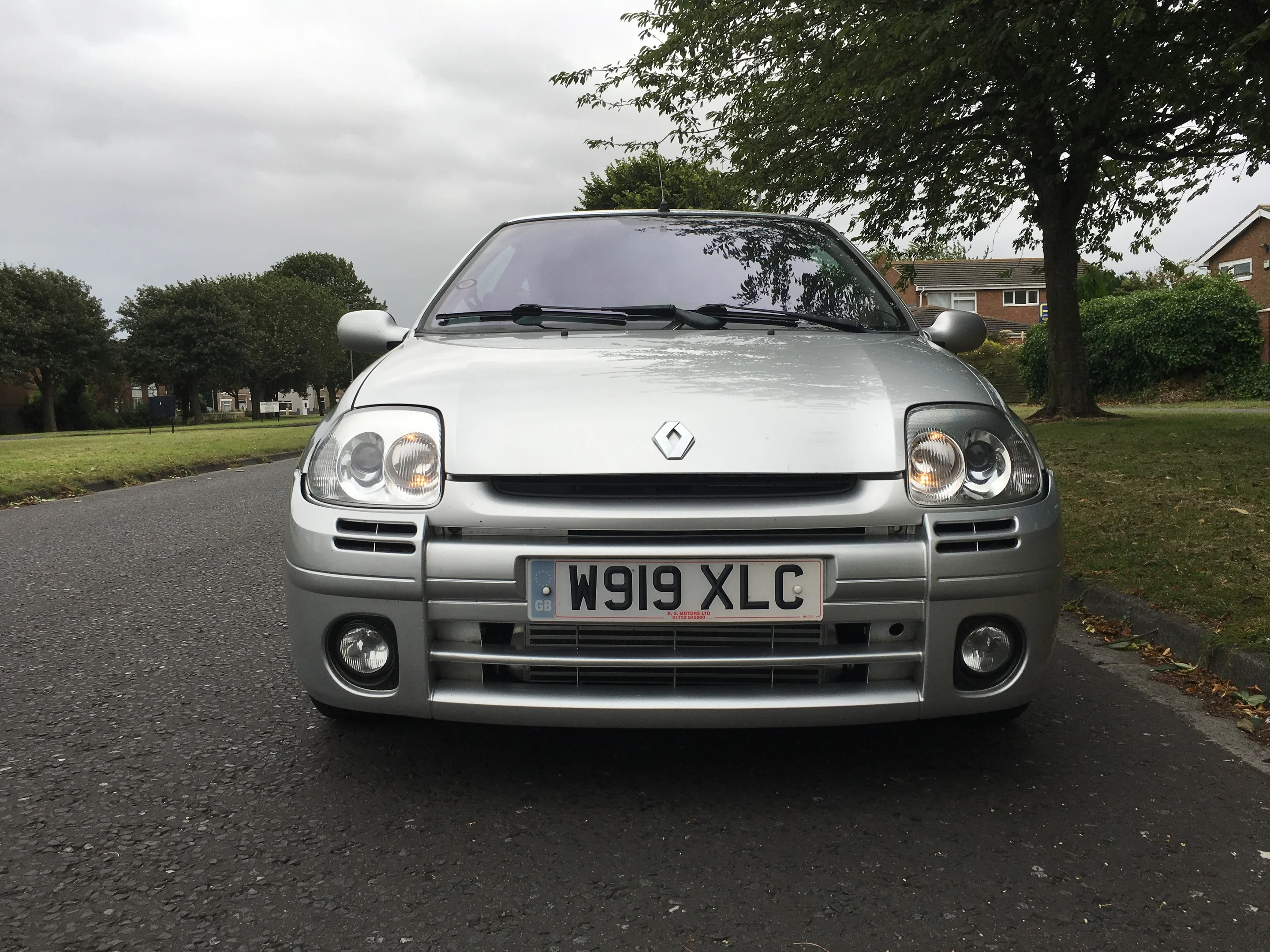

I basically wanted to keep my ph1 completely standard looking, both outside and inside... I like the original OEM look... nothing gives the game away other than the front mounted intercooler if you look closely... or the wastegate chatter on a boosted gear change...
EFI's boost module had previously only been created/mapped/setup for a ph2... therefore this had to be set up and created for me on my ph1.
Driving it sounds and feels just like my old 5 turbo (only faster)... turbo spool up air suction sound... wastegate chatter when you let off... the car has much more low down torque.. no longer feels like you have to rev the nuts off it above 5k to get peak power... even though it's the low blow kit ~230bhp feels fast (at least to me).. I opted for this for a few reasons.. namely the cost involved, the retention of most standard components.. the use of a standard clutch.. I can only imagine how nuts the 280 or 330bhp must be, I can't actually see how it would be driveable at that power in 1st/2nd/3rd ... in the wet, even with Michelin ps3s on full boost mine can't keep the power down properly until 4th gear.. 1st and 2nd is still wheelspin in the dry...

I get why your doing it, but the standard ride height is comical! However, it looks standard but packs a punch!
Have you thought about the 182 manifold? Makes decatting an easier fix.
I'd also think about having some black stickers on the front bumper grill as it's missing them, blacking the intercooler for an even more subtle look and even orange indicator bulbs!

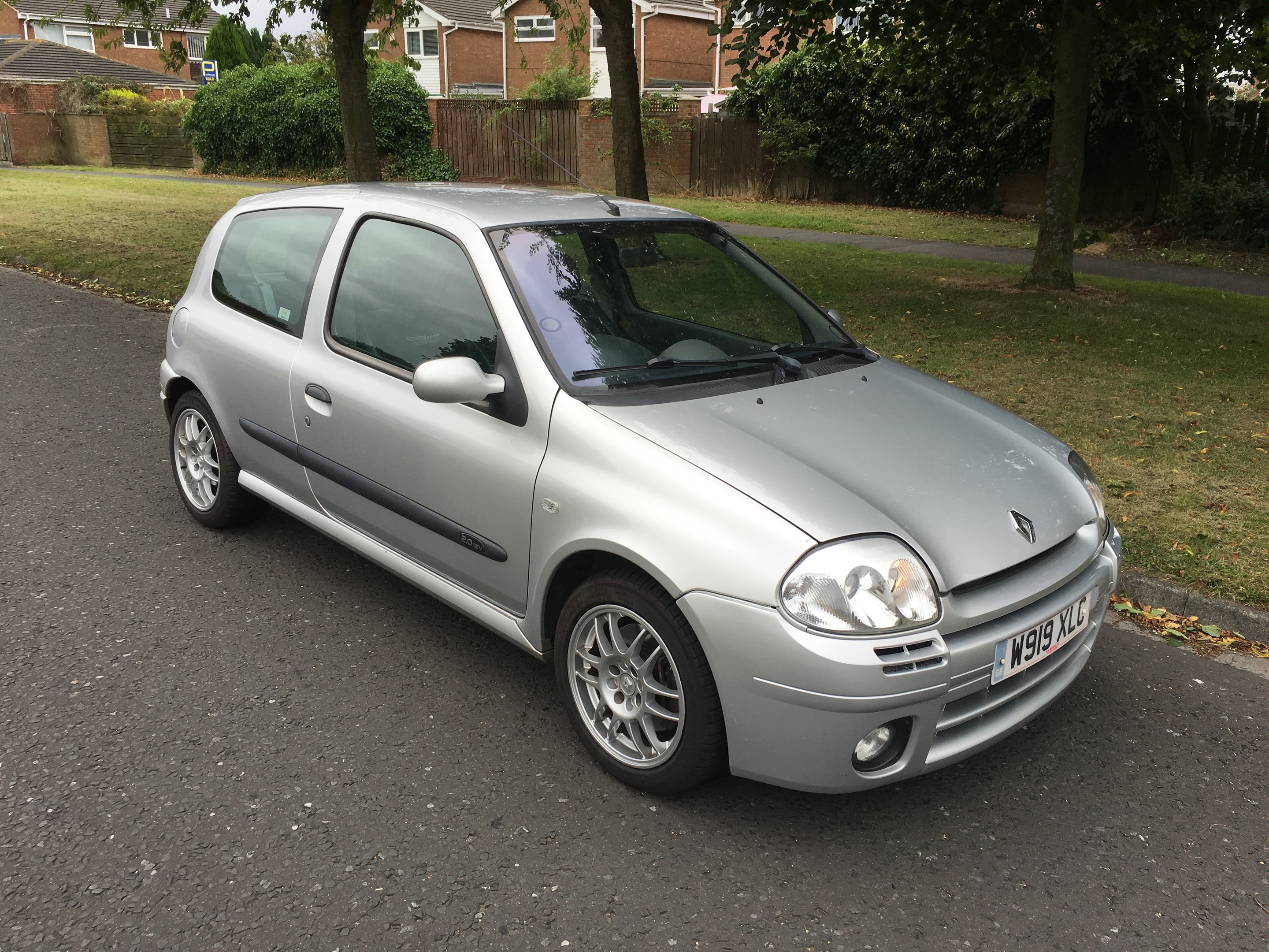

:)... car is currently de-cat.. I just need a new centre section and back box...
Curious as to what the black stickers are though.. hadn't noticed that.. and can't see any difference looking at library photos...
I did have the option of a black intercooler, but opted for a silver one only to signal to the trained eye it was turbod... and yes, orange side repeaters may have to go on... the clear ones were already on when I bought the car... even more shockingly the previous owner had fitted phase 2 rear lights which were instantly removed.

If you look at my grill here, it's black all the way in. Normal if there's silver parts, the bumper has been painted. (Where the toy bar is, on both sides)
I also meant orange indicator bulbs in the headlights too.
Just makes it look more standard.

Oooh, yeah I see now - thanks for this I was not aware.. so the black on the bumper - this is a sticker?.. or painted black... I'll be sure to add this to the list of jobs.. and yeah, orange side repeaters and bulbs too... it's going back original...
I like your car also... phase 1 all the way!! ;)

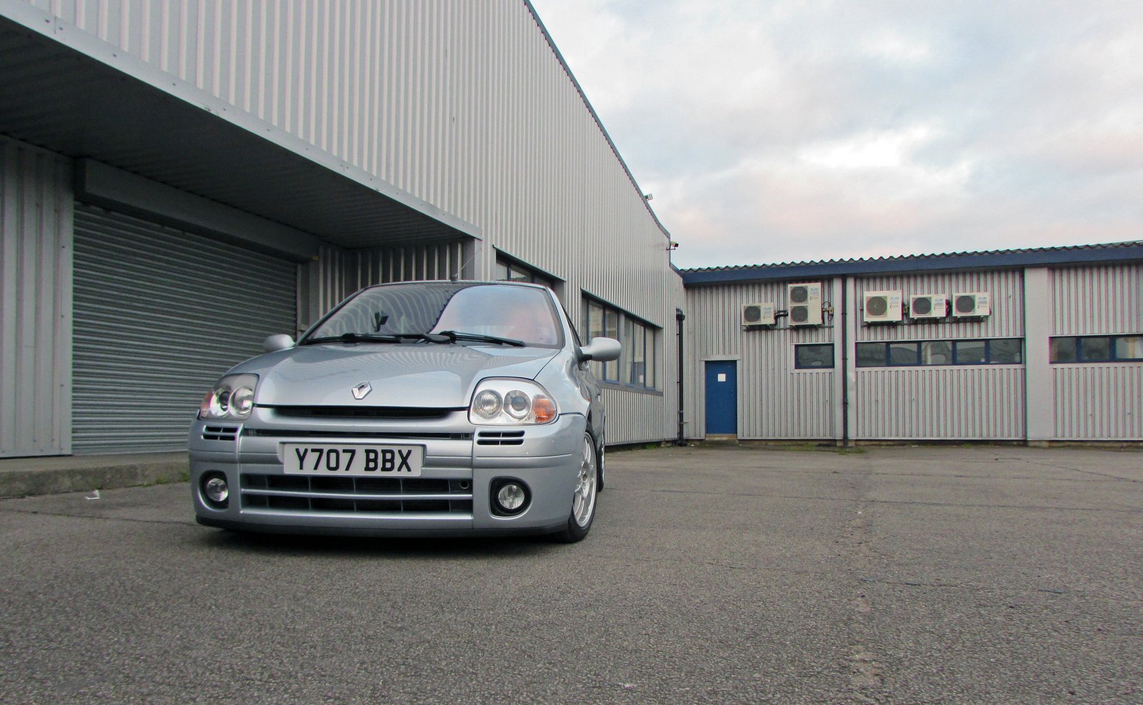

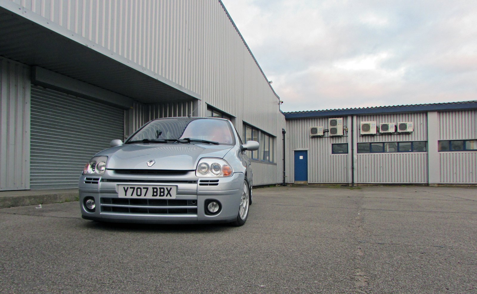

I have a photo of your car with mine that i nicked off andys facebook, im also having the lowboost this week.
So what was the exact bhp figure? And How hard can you push first gear?
  Titanium ph1 turbo
Hey!... I think I saw your car in the workshop when I picked mine up... is it lowered with black/dark alloys? (just from memory)... well mine made 220bhp on the rollers.. but my standard/crappy exhaust is causing a loss of power which I'm about to sort asap... even with 220 though it's awesome.. 1st gear is a tricky one because as soon as it hits boost the needle just goes off the clock so in a split second you're having to hit 2nd gear.. I can't imagine full 1st gear launches are good for the gearbox/mounts... even 2nd gear on full beans is a handful... the power just keeps coming, even up to 6k revs... might be slightly different in a cup though as I know ph1 gearbox has slightly longer gearing (as far as I know)!.... if you came from standard 172 before, then you won't be disappointed with the conversion... whats on your shopping list of work to be done?

Not having the black bumper inserts is a indication the bumper has been replaced or sprayed.
You could originally buy the bumper sticker set from Renault but it's no longer available.
Pain in the rear to cut your own stickers as well as the towing eye areas are a offset shape.
  Titanium ph1 turbo
Hmm wow thanks for this, learn something every day I guess.. I'd never even noticed!...
