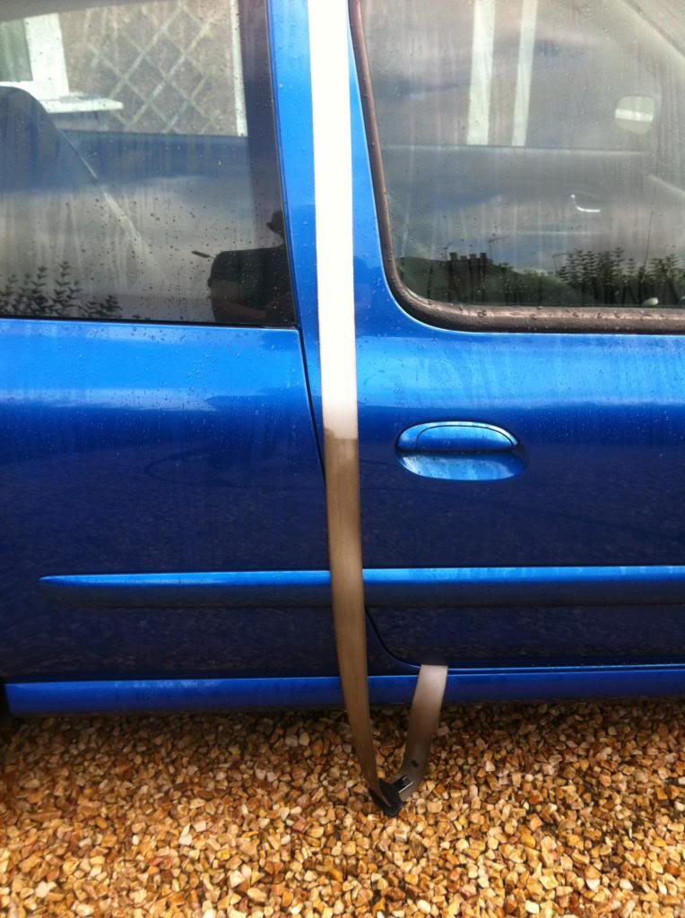

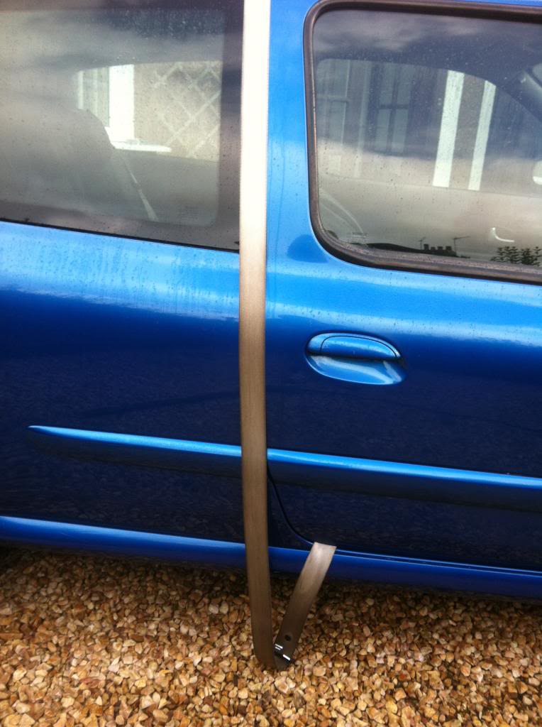

Pull the belts out as far as they will go, close the door to trap them, then get some all purpose cleaner (I mixed it in a spray bottle with hot water) spray the belts on both sides and work in with a nail brush. Let it soak in for a good 5-10 mins as long as your not doing it in direct sun light/hot place. Then was a pressure washer to rinse them off and leave the belts to dry before putting them back in the car.
Mine come up like new doing this. Only took about 20mins to do both side as well. Will get photos up if I can find them.....

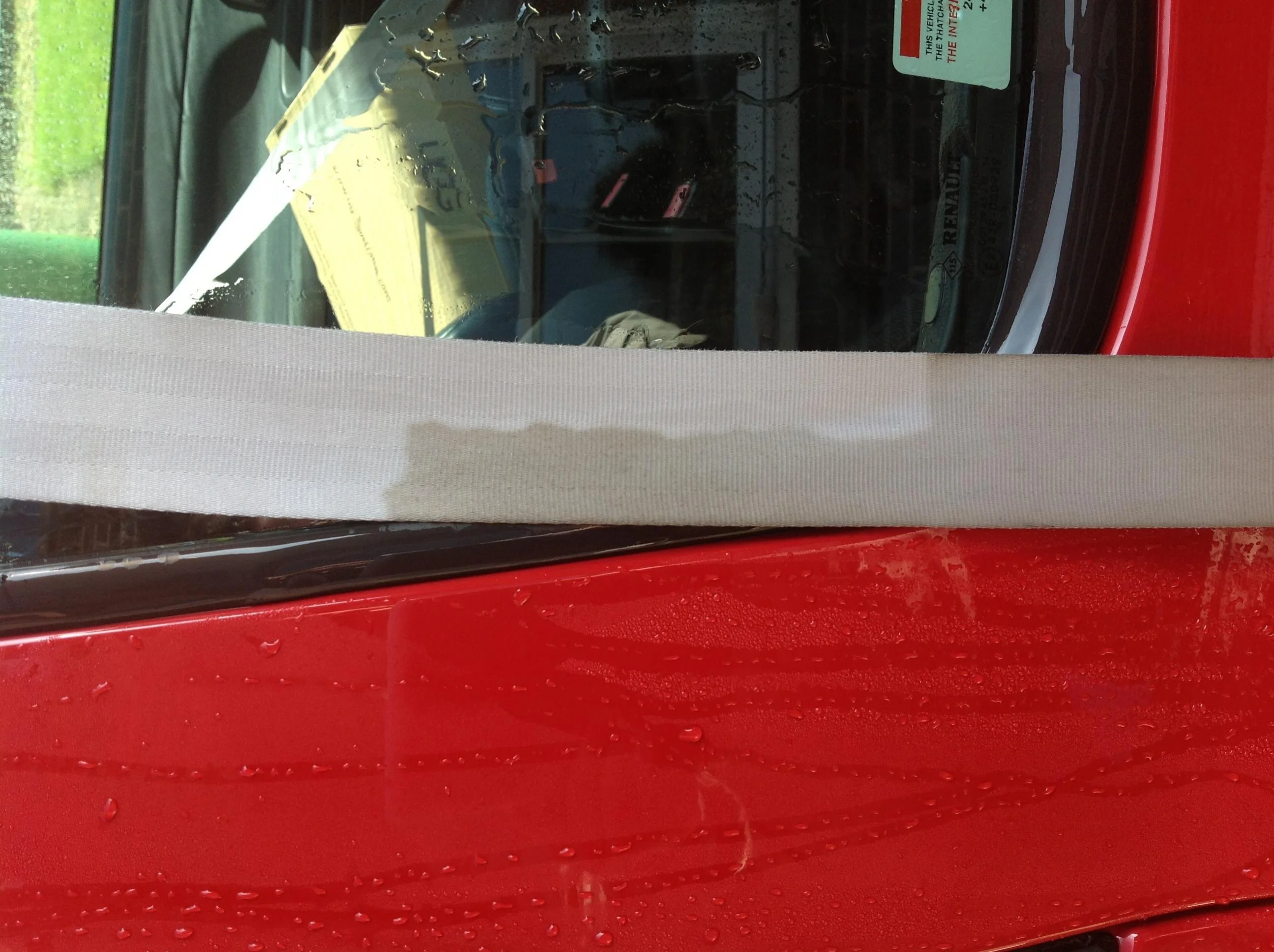

Before:
50/50:
Yeah the belts were quite bad, but tbh they didn't look THAT bad till I done the 50/50 :eek: :lolup:
But come up like new again :D Can imagine doing it by hand with microfibres/clothes would take a while!! If you have or can get hold of a pressure wash I would definitely use it ;)

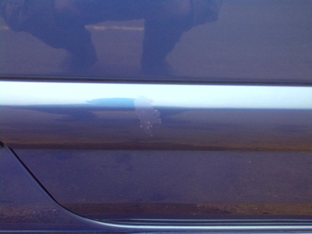

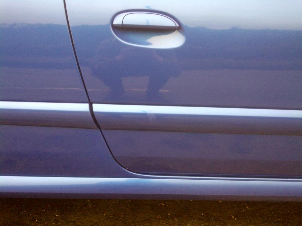

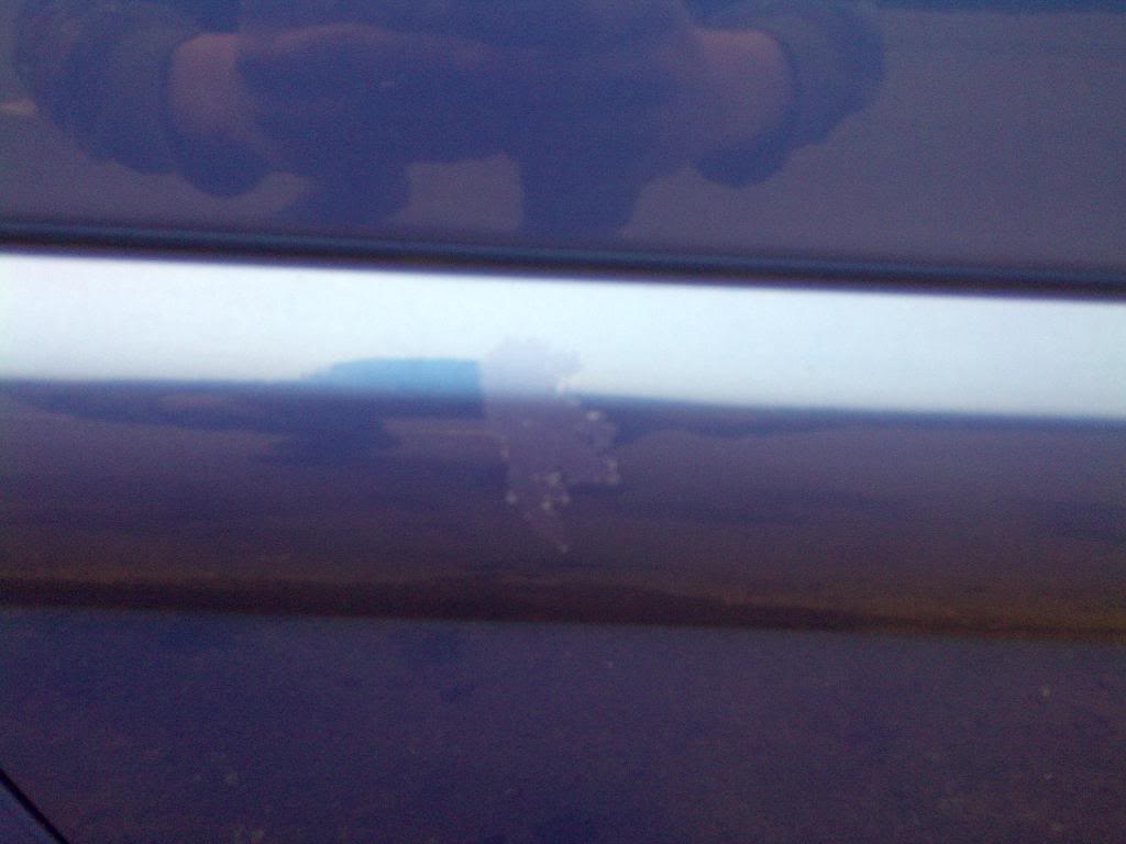

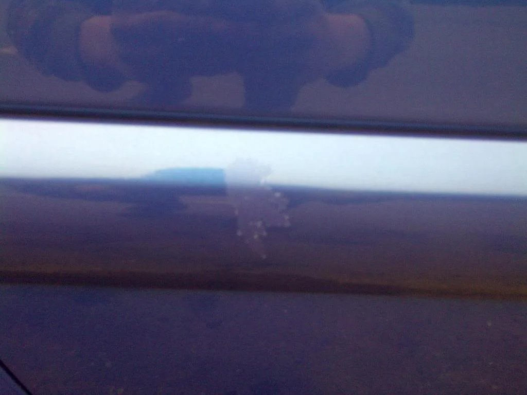

i'd advise to put some tape or something on the little plastic bit on the belt as when i pressure washed my belts on one side of the car its been flapping about and rubbed the paint off the bump strip :(
