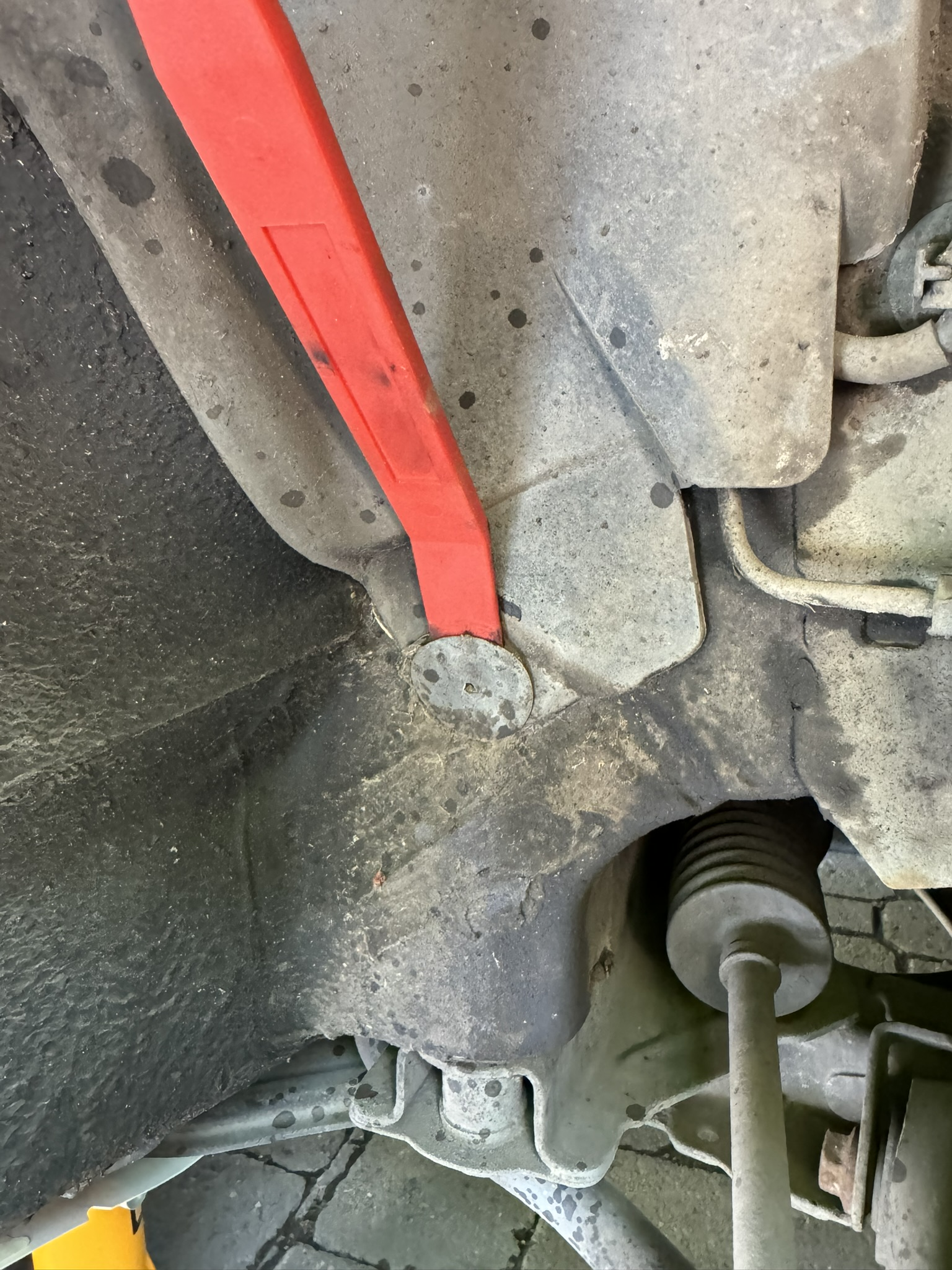

Trim tools at the ready (essential, buy them NOW if you haven't got any!) - I started popping off all of the retaining plugs and unscrewing any fastenings that were keeping the liners in place.

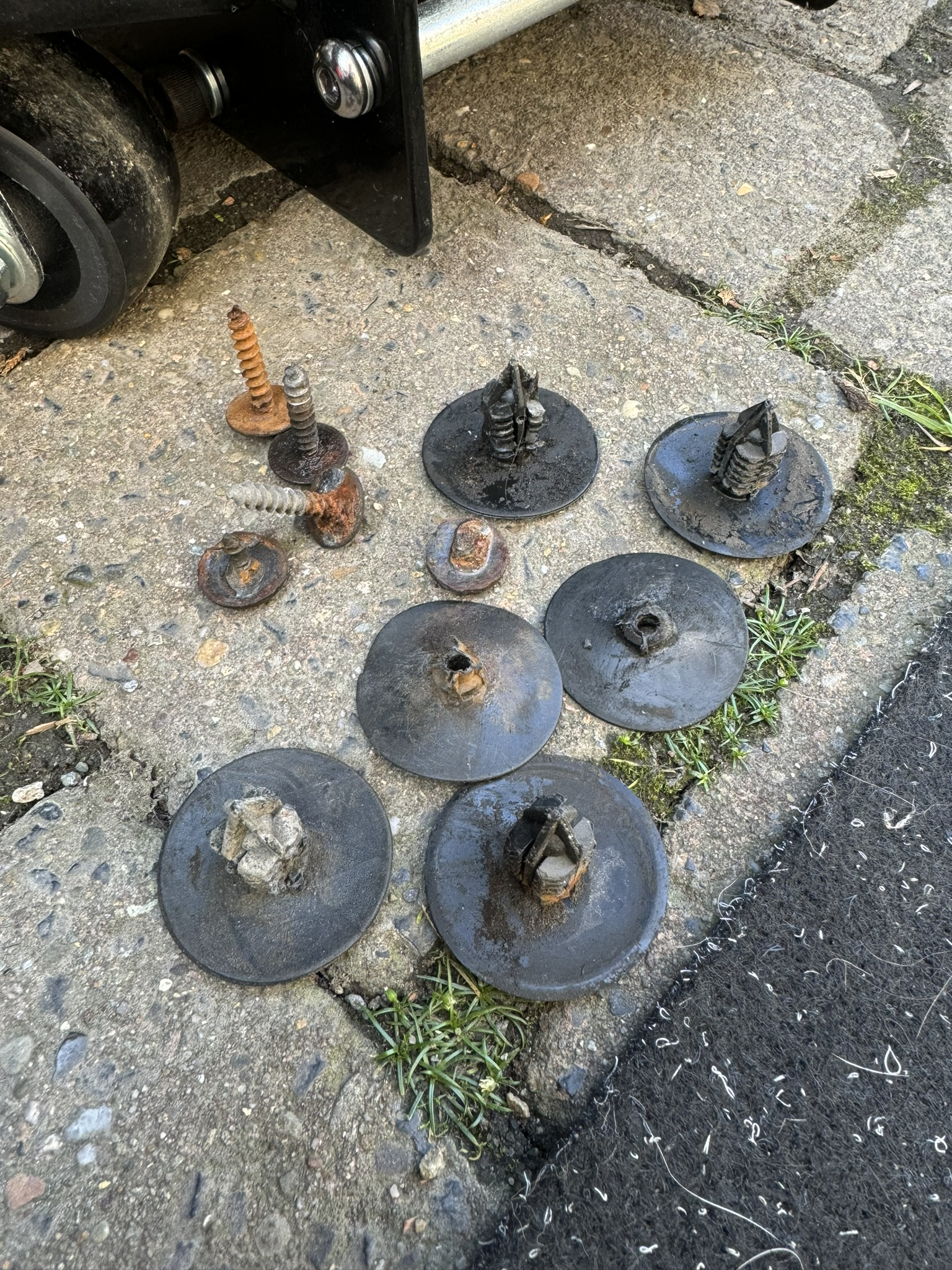

The majority were knackered, but as mentioned with a new set of everything to hand, none of that concerned me.

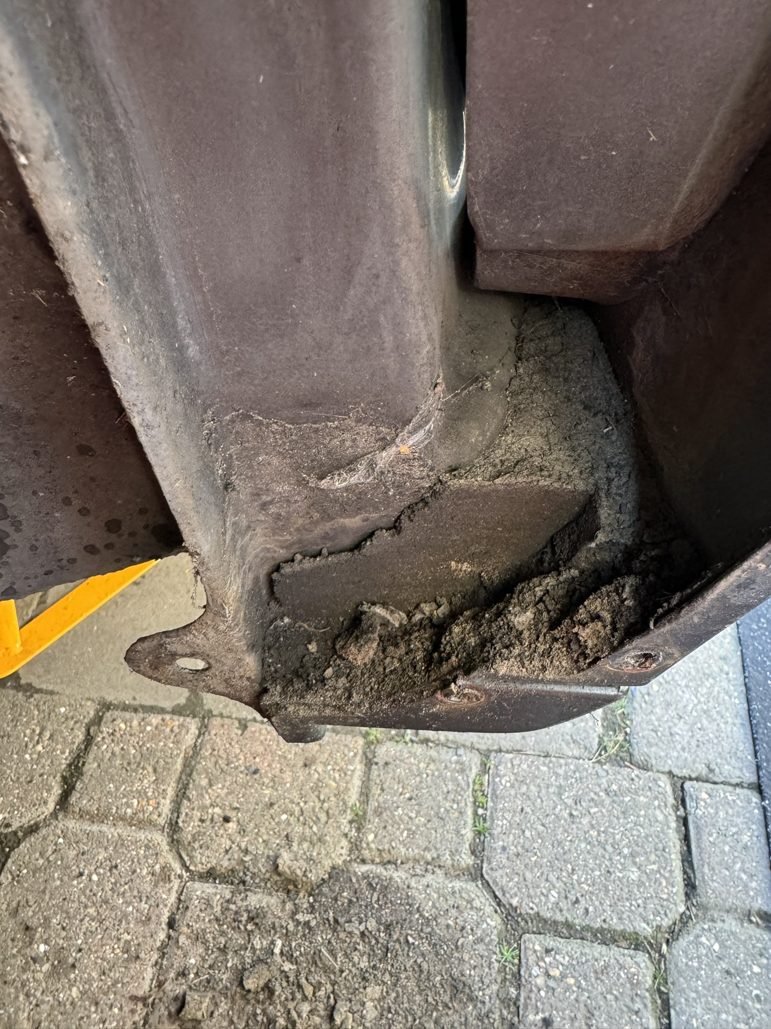

The silt build-up behind the nearside liner was excessive - just glad that the majority of contact points around that are plastic. Managed to dig a fair amount of crap out of there, compared to the offside which was clean due to the recent'ish work.

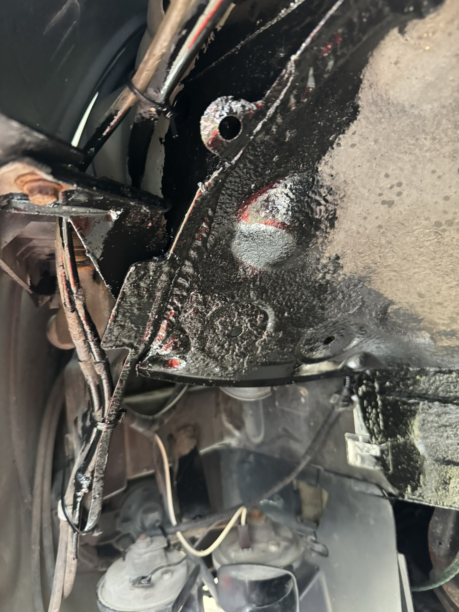

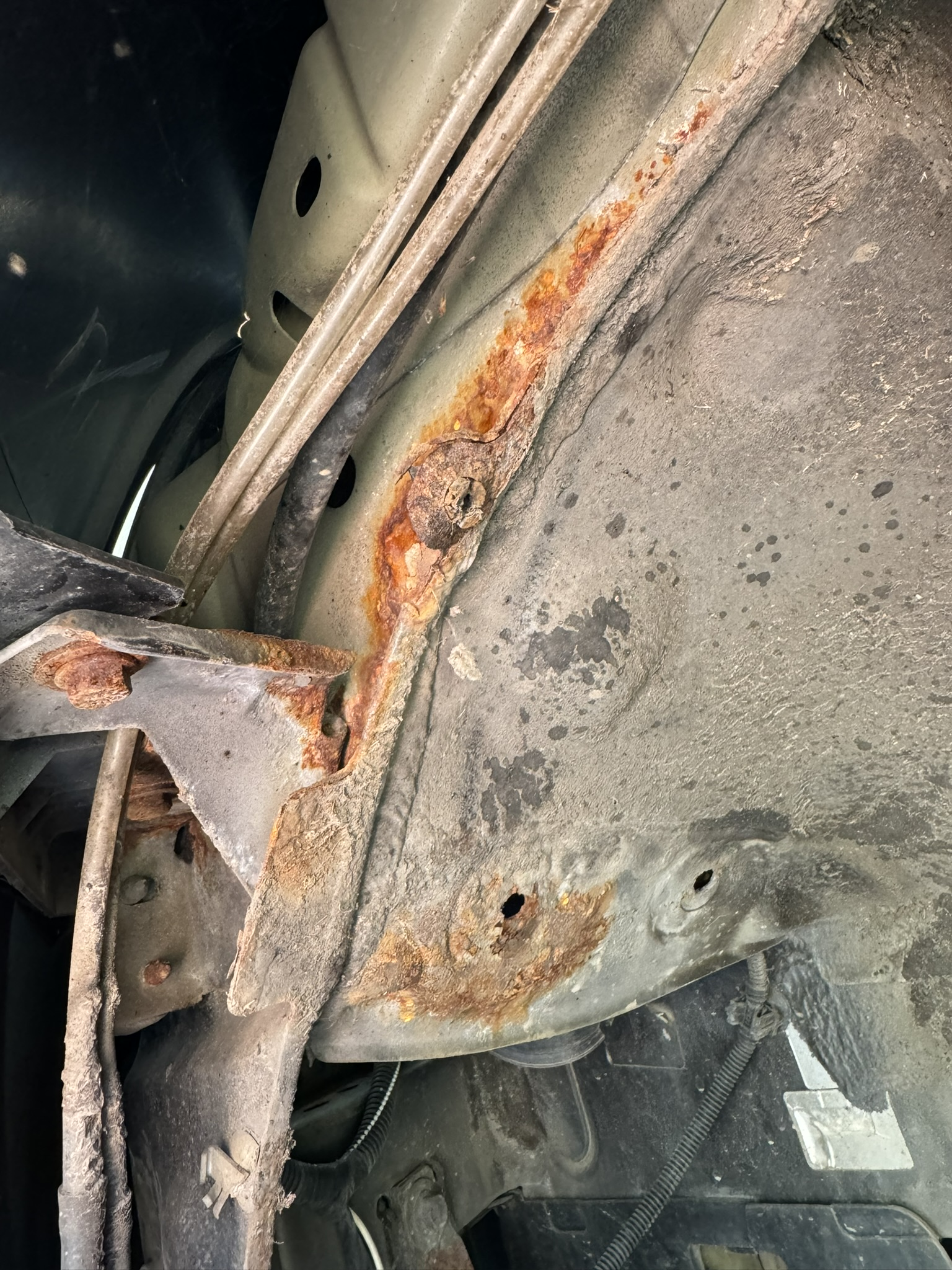

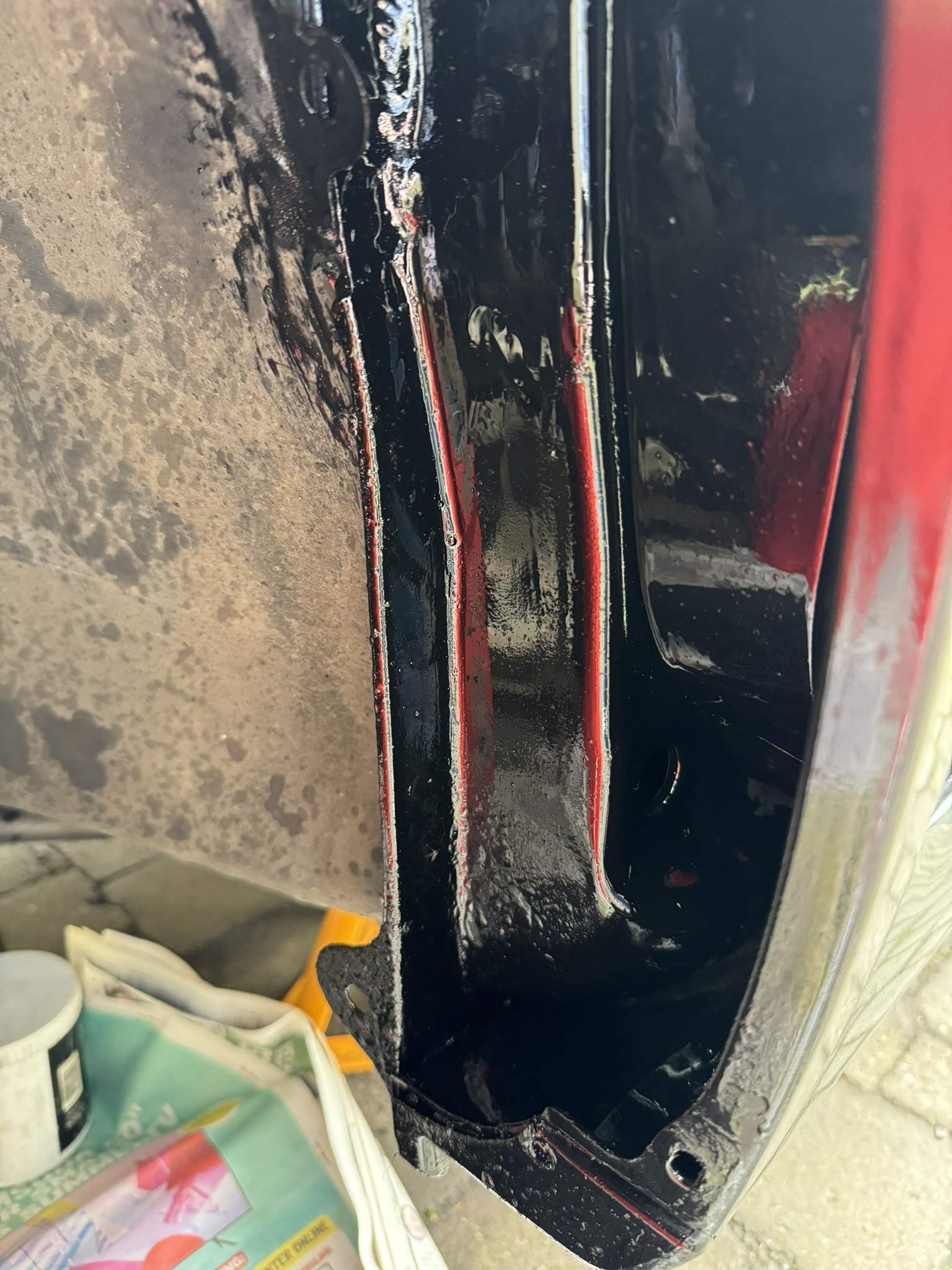

To my pleasant surprise, the only visible corrosion on the nearside arch was this. I wire-brushed as much off as possible and coated it in POR-15 - which although not a perfect solution, will definitely be better than left as is. With the lid off the POR-15, I painted other areas with it too - just as an extra layer of protection whilst I was there.
The weird red bits on this pic are due to a red carrier bag that I'd fitted over the brake assembly.

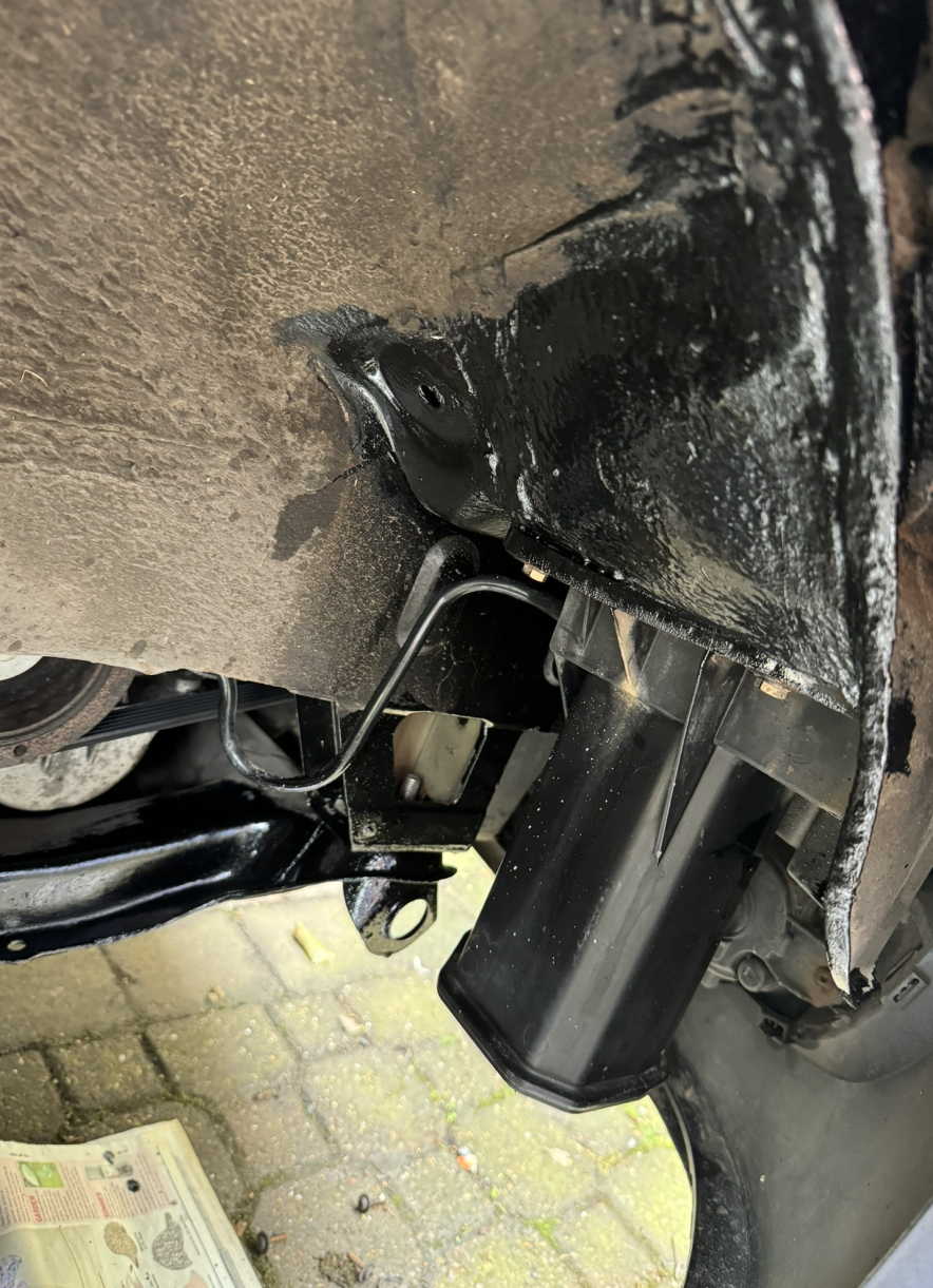

Having been left to dry since Saturday, I went to reassemble the liners back this morning. As usual - the first side took me about 15mins to make sure I had everything lined up correctly, before committing to any 'proper' attachments - then the other side was barely 5mins in comparison.
All in all, a good bit of knowledge gained and dare I say enjoyment from actually doing it. Knowing that the replacement clips and fittings are so easily available and cheap as well, means that I'll have no worries about trying to retain rust-riddled Torx head screws and the like in future. I also managed to fit my new Citroen (?) bonnet washer nozzles that I had had lying around - and they are much better than the OEM units.
