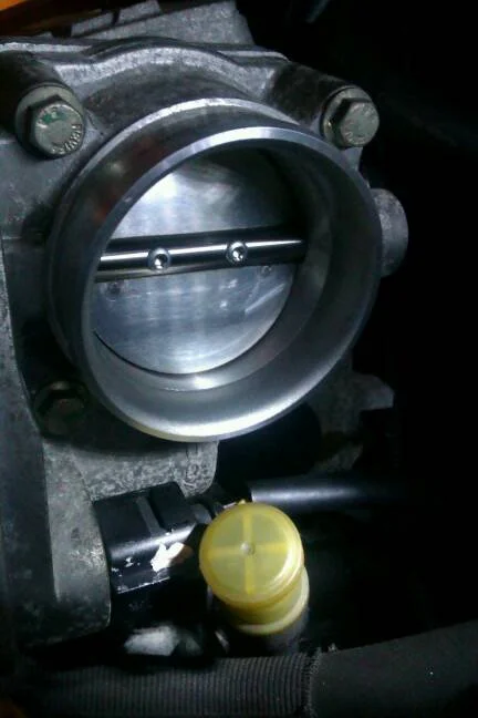

I cleaned mine this week, it was fairly dirty but this is how it looked after a bit of wd40 and elbow grease

Did this today - it was not that dirty but its clean now, made no difference lol oh well, didnt cost me anything to clean it up!

just took the air feed off, unplugged the switch from the bottom of the TB, un-screwed the 2 bolts at the bottom with a 10mm torque rench bit, then did the top two, then it comes straight off. then use the carb cleaner and jobs done :) mine wasnt that dirty to be fair. car sounds nuts when you rev it with the air feed de-tached though :p
