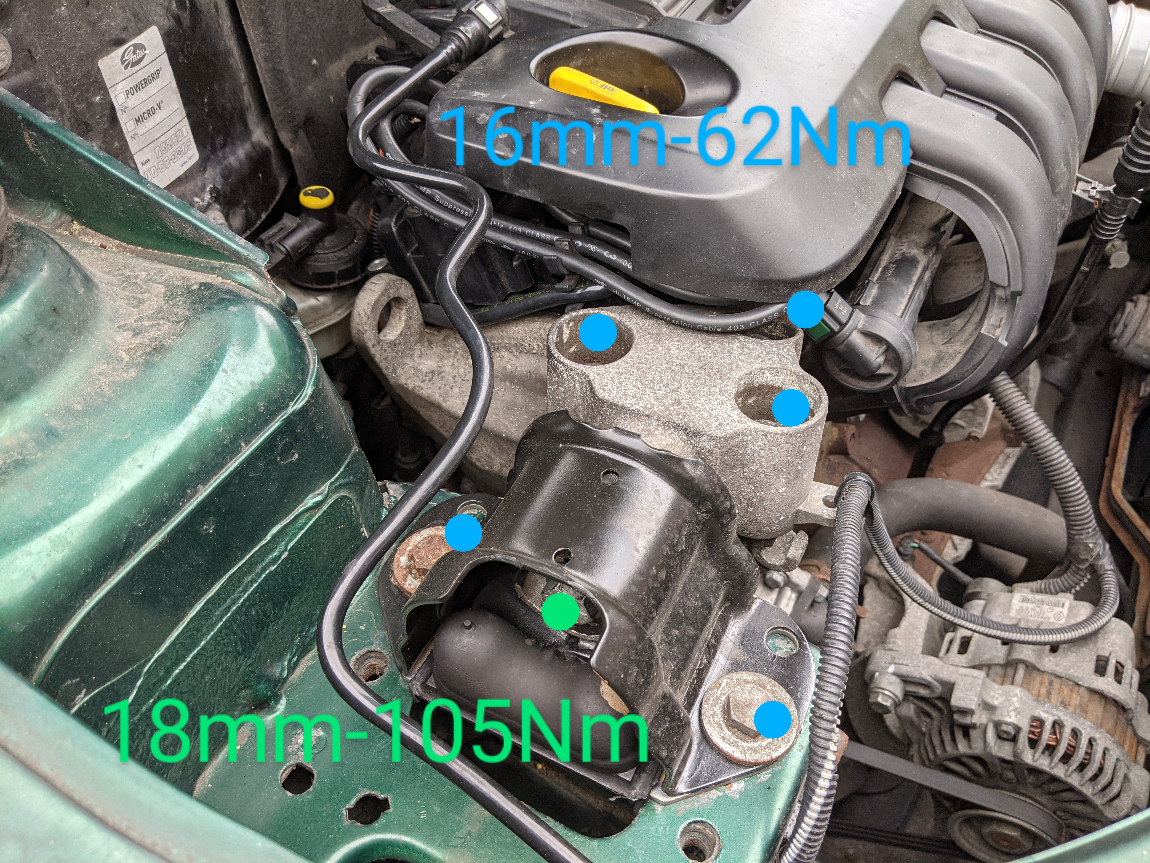

You can just about see behind them, lots of room at the front as you probably know. Grab hold of the engine while off and cold (best grabbing something metal rather than the plastic inlet) and give it a shake and see if it moves. I have replaced my mounts recently and there is very little movement when done by hand.

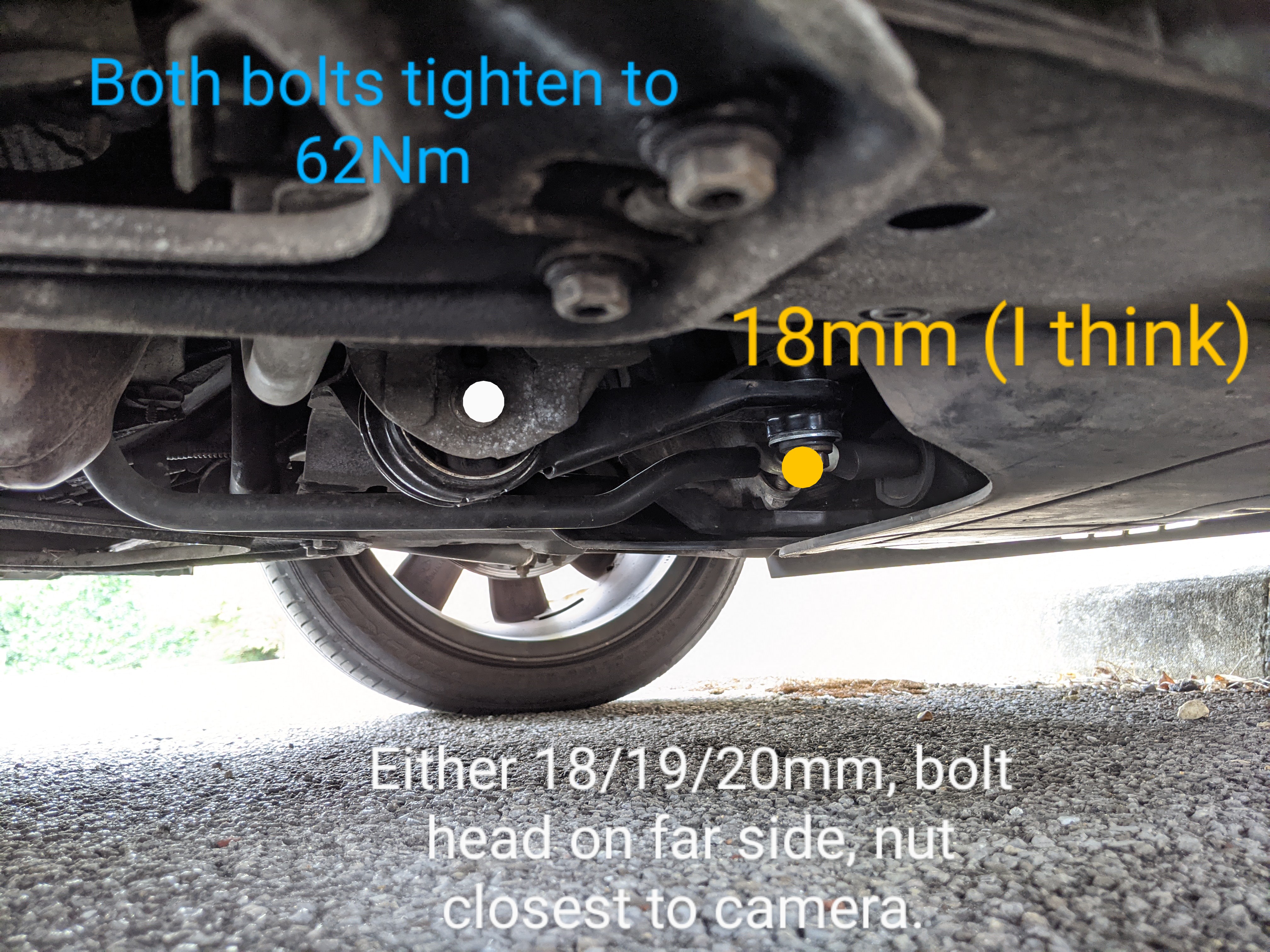

If its on accelerating it may be the dogbone mount at the back of the engine has perished. Every time you bury your foot down the engine may be twisting and banging around in the mounts.
There is not too much to these engines so I would start checking the mounts and see where that gets you (especially if they have done 128K miles)

Really easy, the dogbone is just two bolts under the engine. Unless you are really flexible you will need to jack the front up to get at them.

I can grab bolt torques for you after work if you need/want that info

I checked the top mount with sockets, the bottom is from memory.
I think the nut on the back of the dogbone is a size up from its bolt. I think I put an adjustable wrench on the nut and undone the bolt with a socket.
(My socket set goes upto 20mm so it can't be larger then that)
