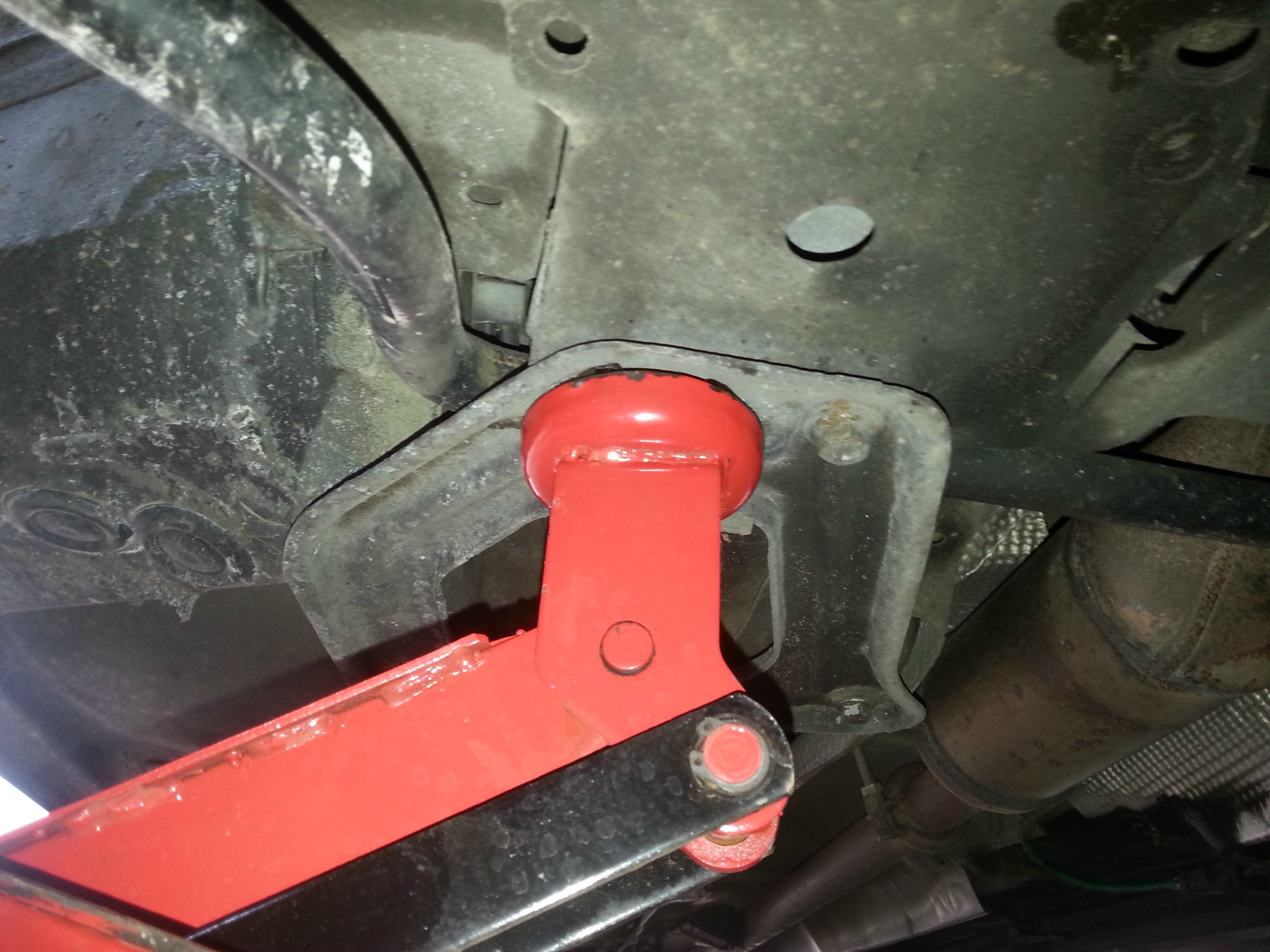

  Suzuki Ignis Sport
I see. I think someones used that plate you can see to the left of the picture. What is that? It's a hexagon shape. Will definitely try there mate.
  Suzuki Ignis Sport
That's good news then! What's that part called then? The chassis rail? So I'd put the axle stand beside the jack as close as possible? Thanks guys!

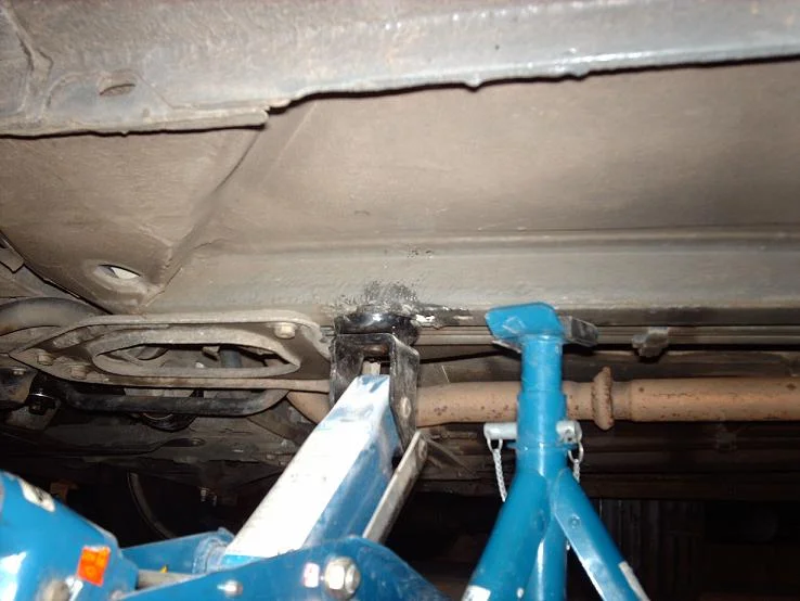

  PH2 Flamer
And when using axle stands, should always have a leg pointing to the outside. To stop it toppeling over when jacking up the other side.
What i was always told anyway. In my eyes that pic with the blue axle stands is actually wrong.

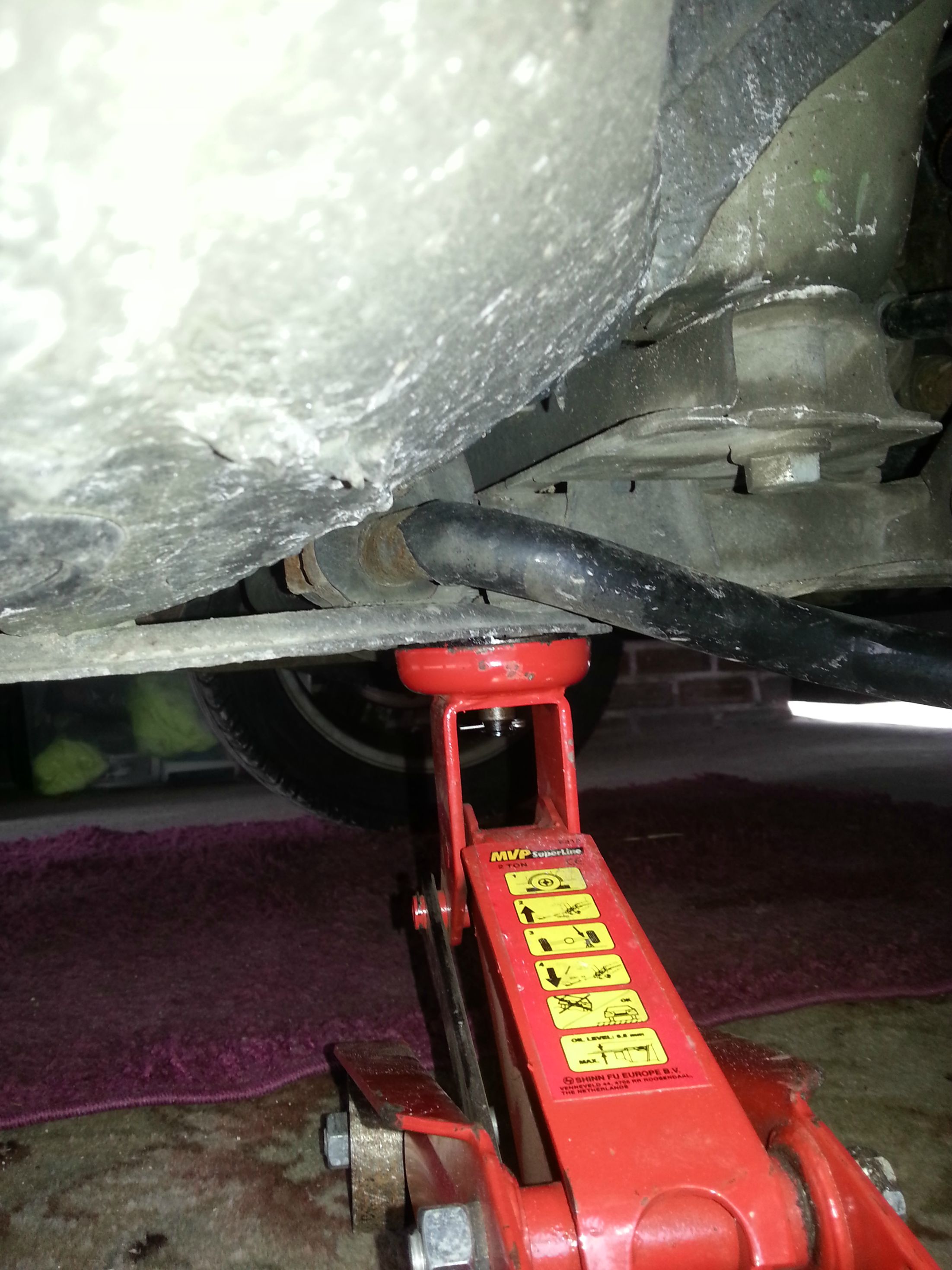

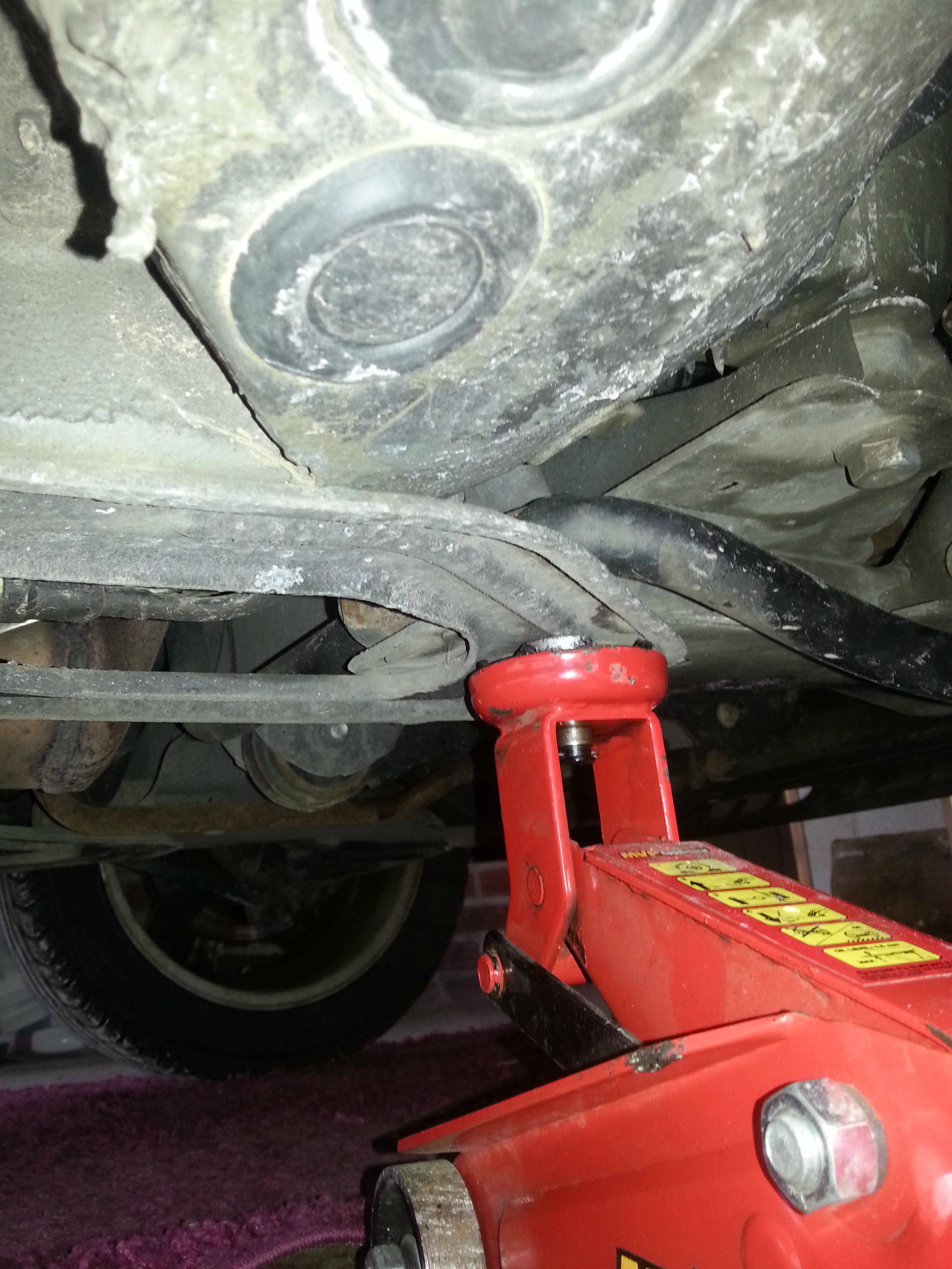

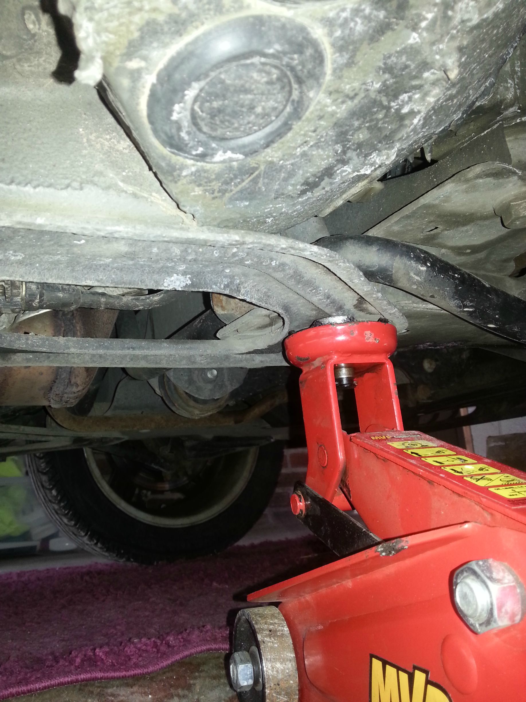

Here's what I've used.. Tell me if it's ok to use this place.
In your first picture on the right hand side next to the ARB there is a bolt head which I use for the jack then the chassis rail for the axle stand, personal preference though
