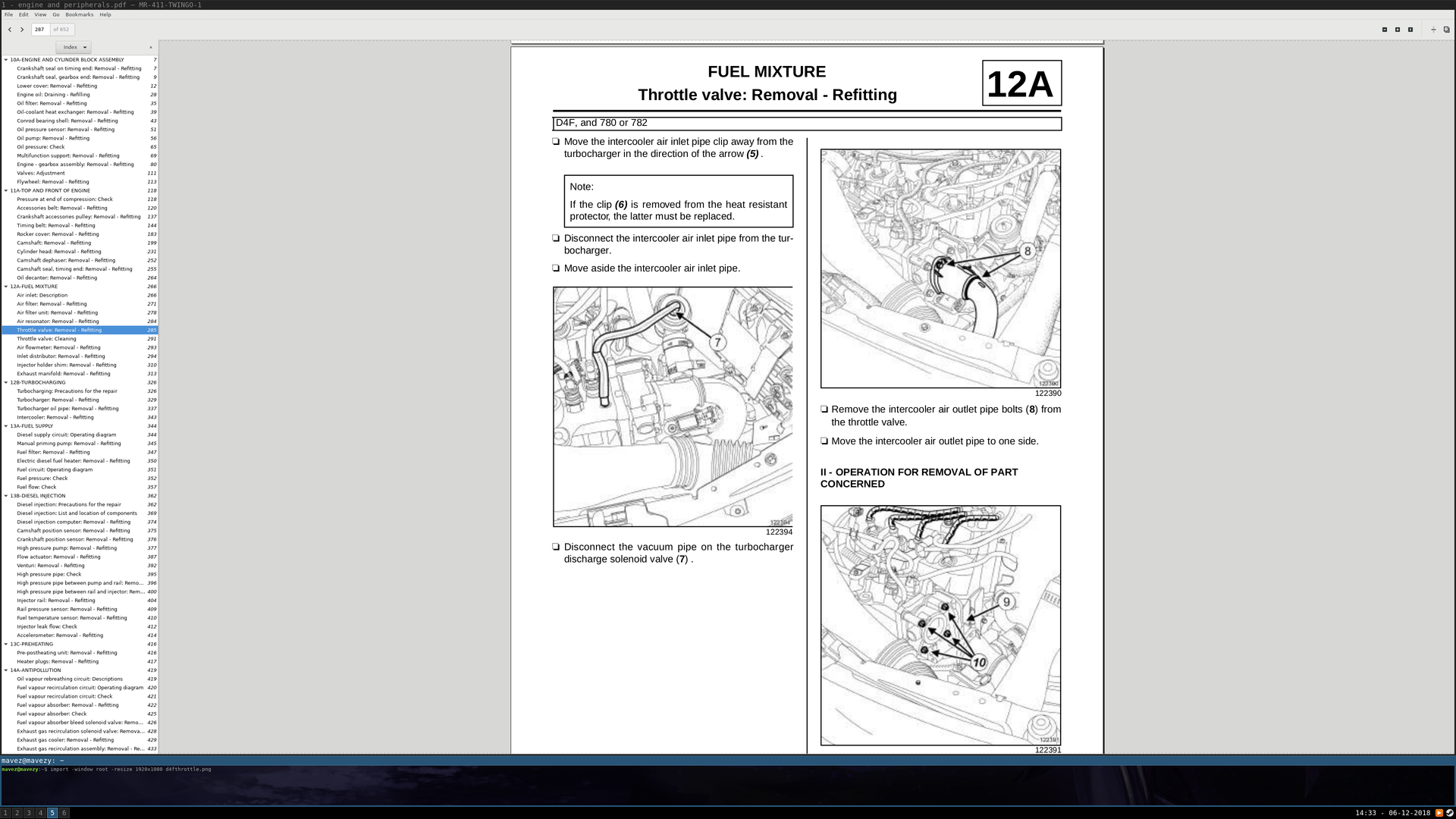

this might be helpful

Should just be two bolts to remove the intercooler air outlet pipe then the 4 bolts attaching the throttle body/valve to the inlet manifold.
Na I had a CD with Renaults Dialogy software a while back and it has all the maintenance and repair manuals n stuff. that one is for the twingo but it has all the d4ft stuff as well. I can send you the pdf if you want.
