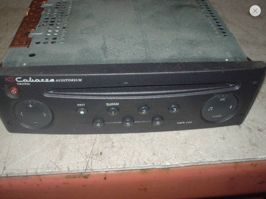

You will need a Tuner list model, the Cabasse Auditorium models were slightly upgraded to standard.
I had a Cabasse unit until it stopped playing cds. Chucked in an old alpine one and it sounds so much better.
As said you need a Tuner List NOT Update List as this is fitted to late year 182's and Trophys.
Cabasse Auditorium is an upgrade on both models.

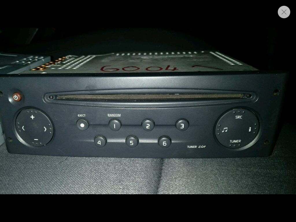

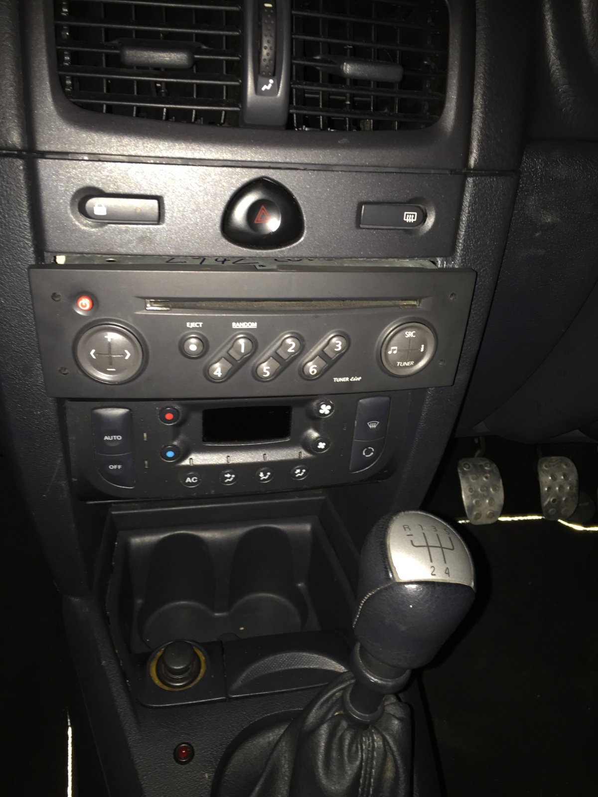

I've one from a mk3 Clio and it won't work at all And I've a megane one that looks identical but it's too wide.
I'm epic failing here.
Cabasse is an upgrade on both models.
If it's an early 2004 182 you will need a Tuner List, with or without Cabasse Audiotorium (your decision).
I've a tuner list and it looks just like the Clio one. Until you slot it into the dash.
Pulled it from a mk2 megane.
You need one of these 2:
You also need to make sure the recess that the cd goes in has a flat lips/mouth as this shows it is a Clio 2 CD player.
Sorry mate but yep that's your problem :( wrong stereo, buy one as per my photos but make sure it's a Clio Tuner list.
