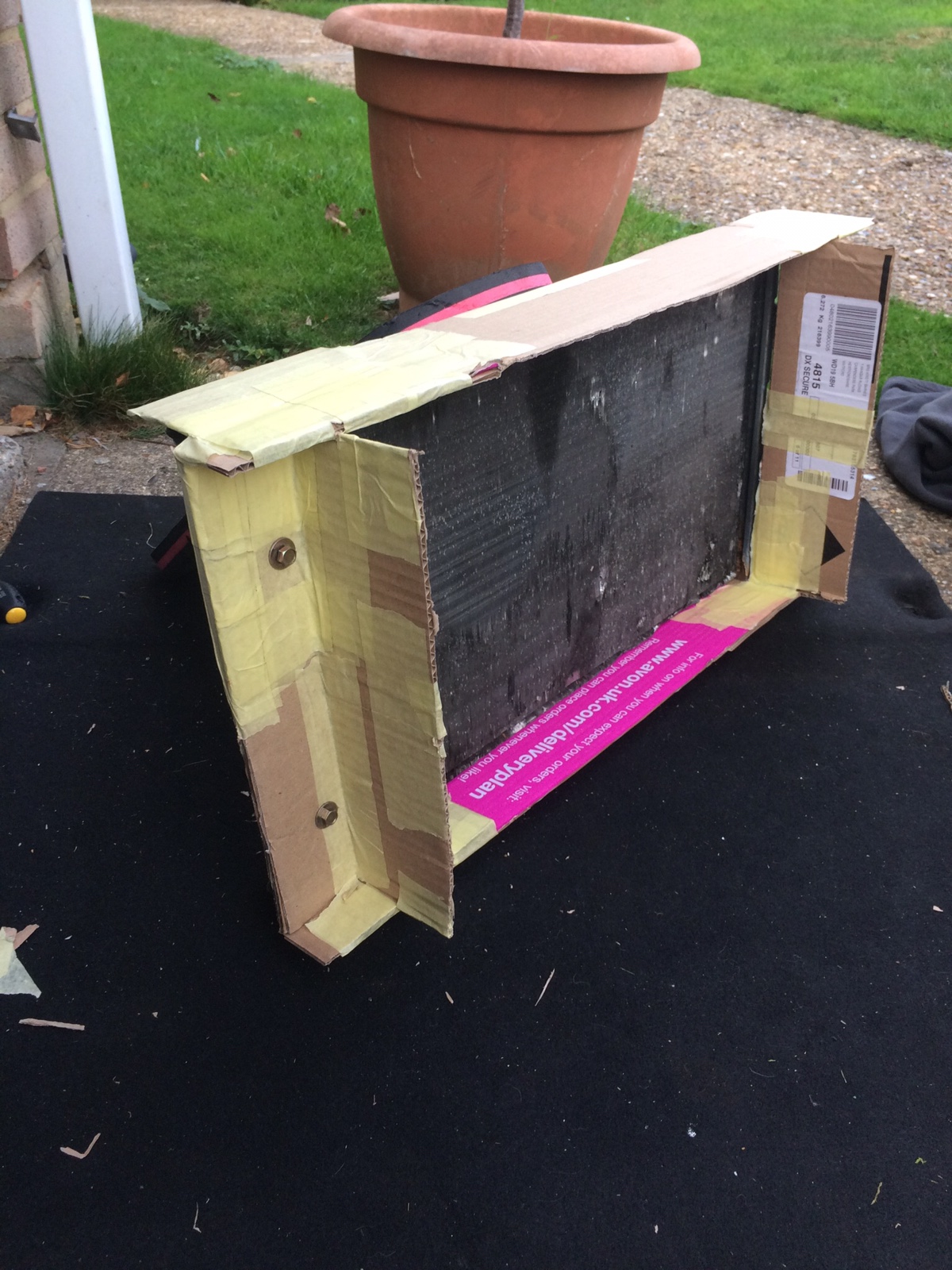

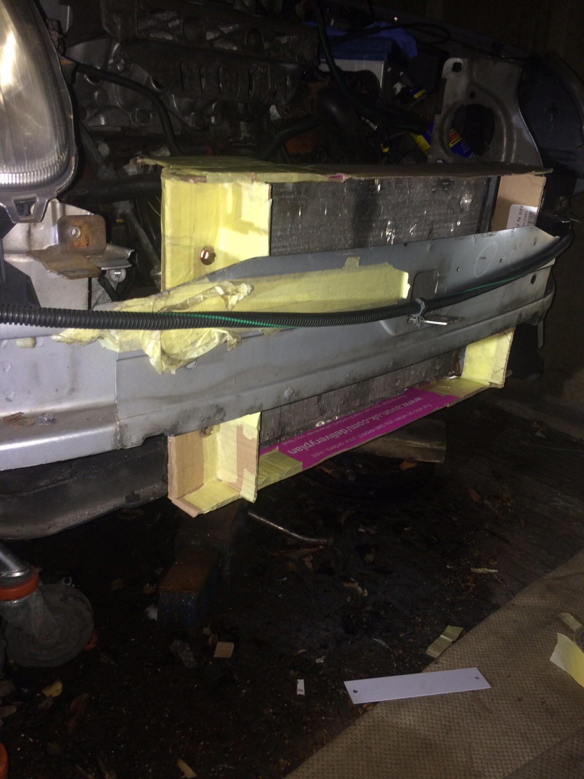

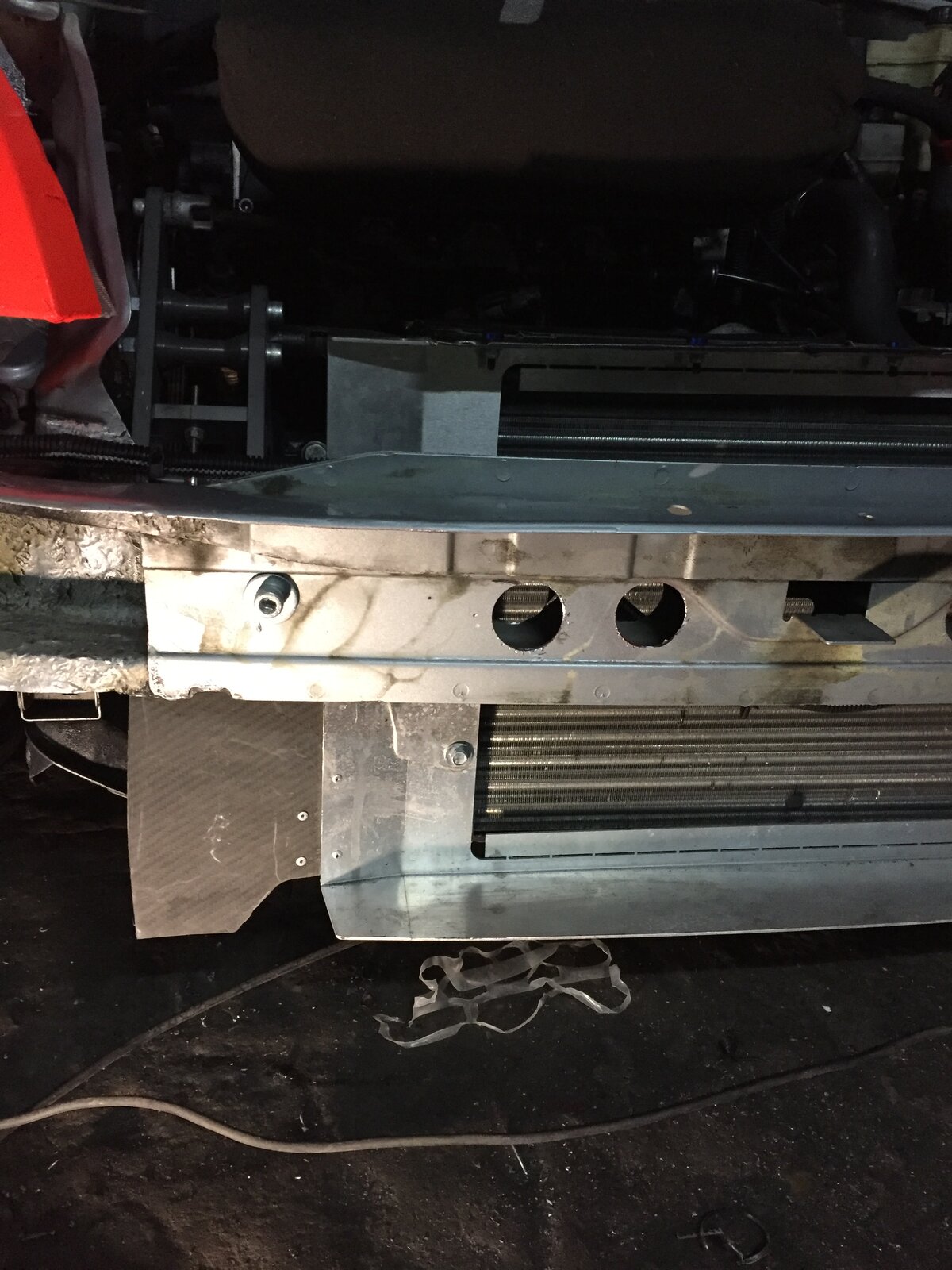

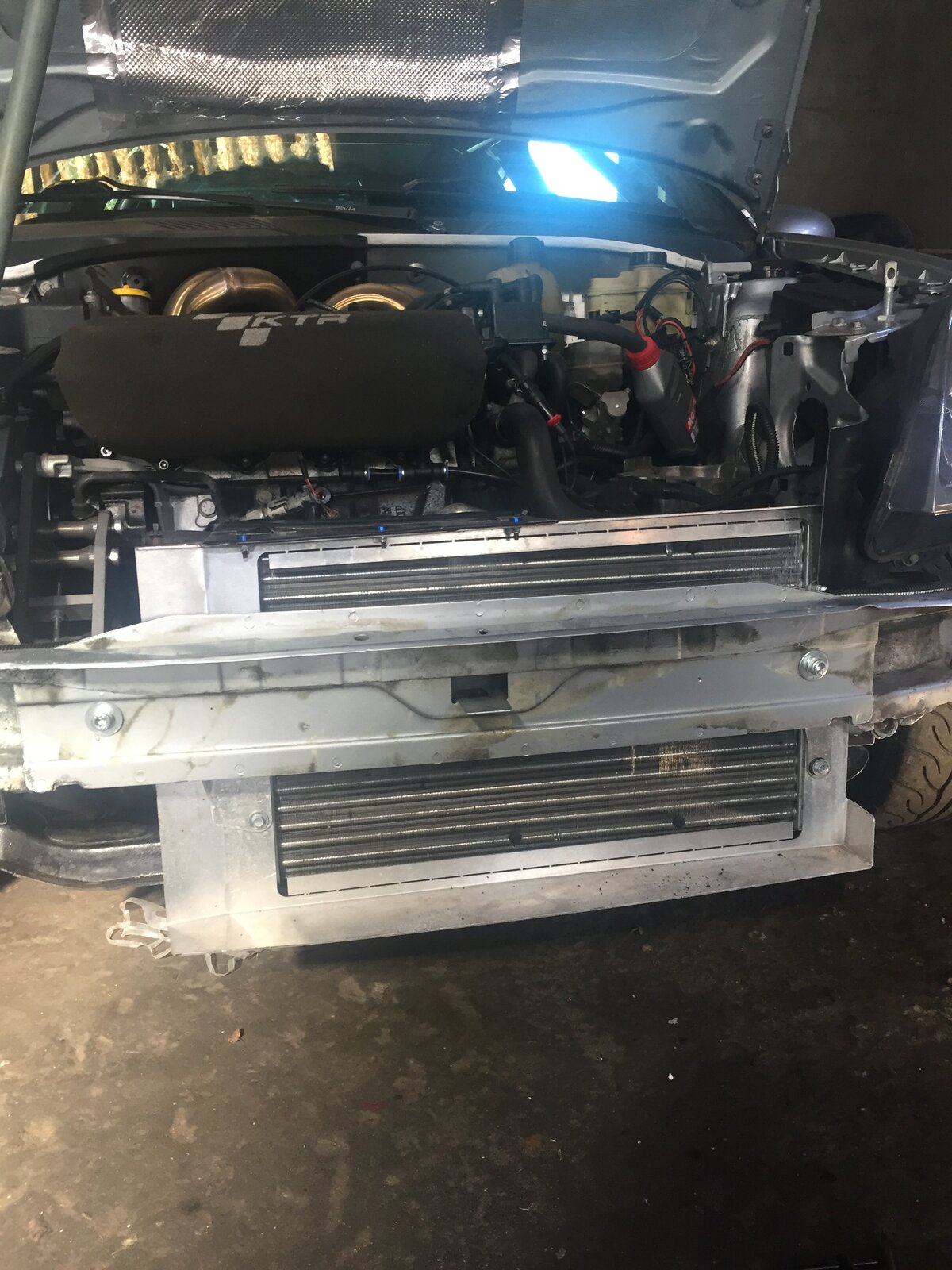

I run Itb’s also , at SPA I saw 120 degrees oil 105 coolant , so backed off , now I’ve fitted a 13 row and also a shroud around my radiator , I won’t be able to test again until warmer weather, but I’m out at Snett in the 10th Nov so I’ll report back then .

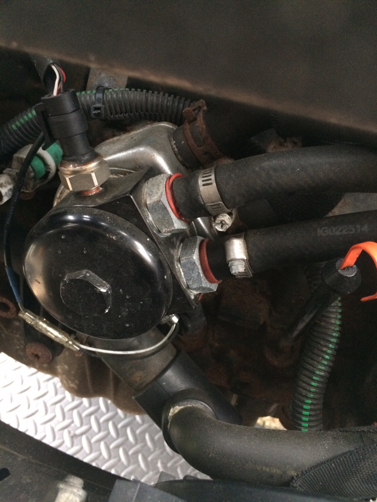

I run both coolers.
A modine oil to water cooler off a megane and the 13 row external .

It’s actually the other way round I had it .
Modine cooler was fitted first without 13row external cooler .
It was getting hot with just that and no fan shroud fitted. So it was kinda pointless on its own .
But now it’s in conjunction with the other supporting mods like the external cooler and the shroud I see results I know that , as after a serious run on the motorway full chat the oil and water are at 85degrees .
So I’m hoping all is good.

Ok ,so the results of temps at snetterton.
Oil maxed at 108 degrees
Coolant maxed at 97 degrees
I’m running water wetter by the way.
15-20 mins runs , 5 laps on full chat where Snett allows full chat lol
