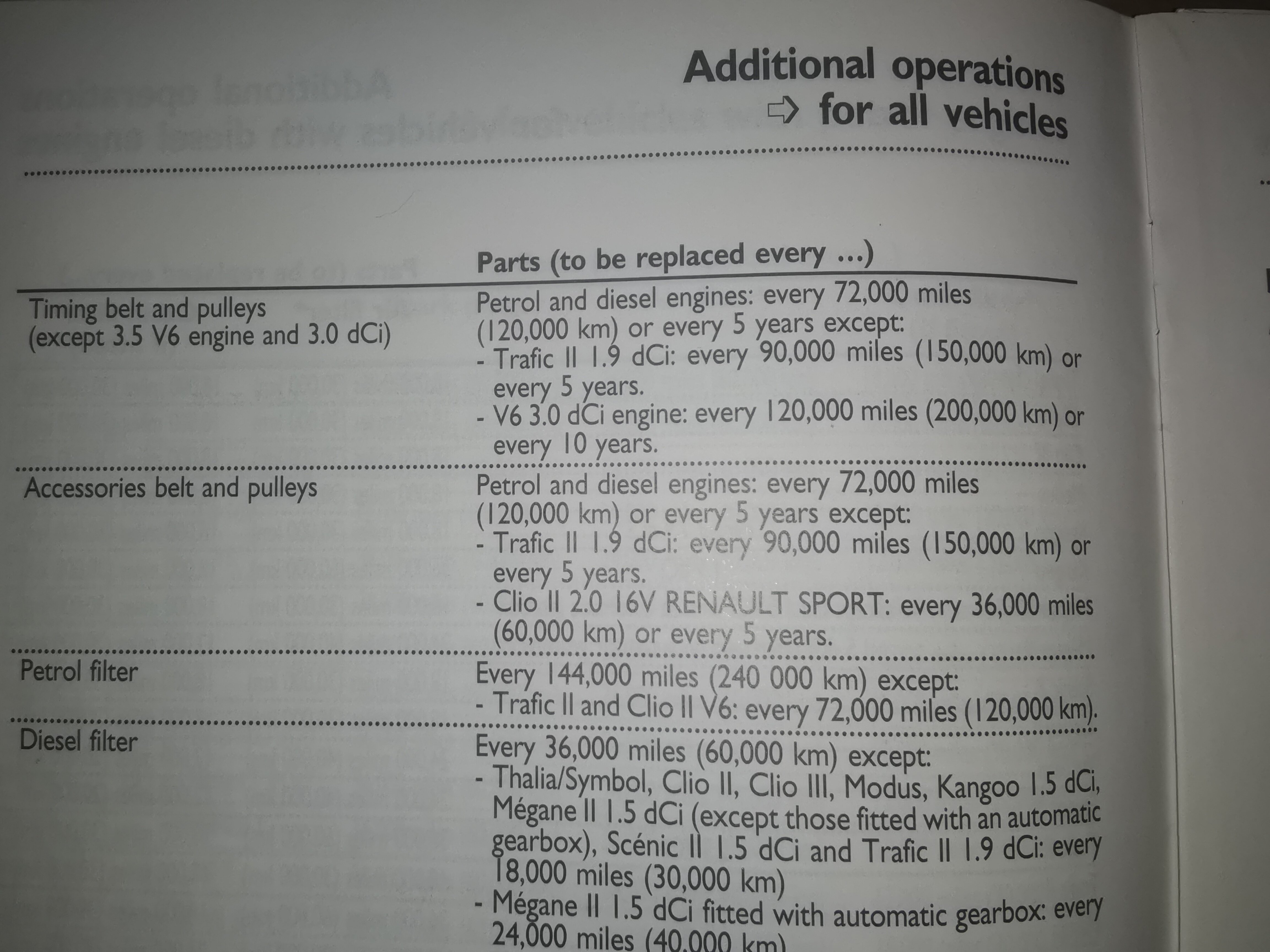

The fact it's due a belt anyway means I'd just replace it all anyway! Aux belt and tensioner long overdue they are 3yrs 36k, just add a crank pulley on top of cam/aux kits and water pump.
MRBILLYUK
  FF Jeden Osiem Dwa
I've had almost all.of my aux pulleys start to fail the last few years, that does sound a similar noise but generally the pulley starts to wobble where that one looks ok.
On a 1*2. Aux belt and pulleys is every 5 years or 36k miles. People automatically assume it's every 3 years with it being 36k and the timing belt being every 5 years and 72k.
