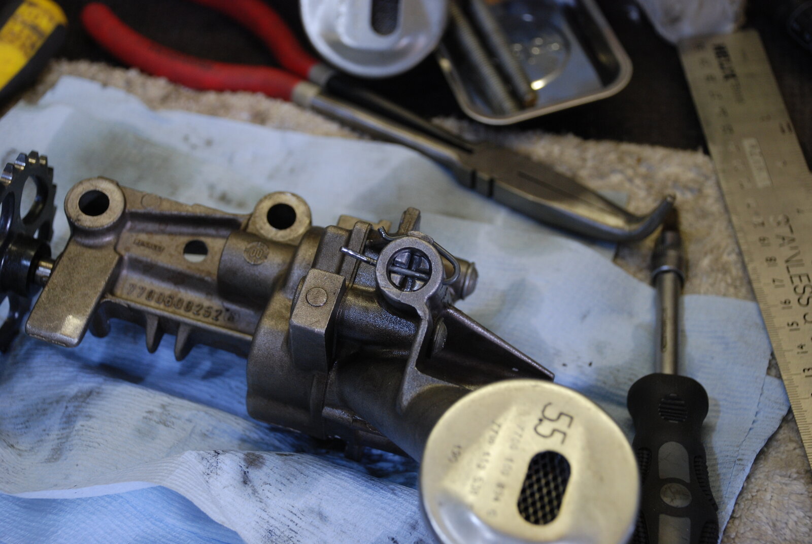

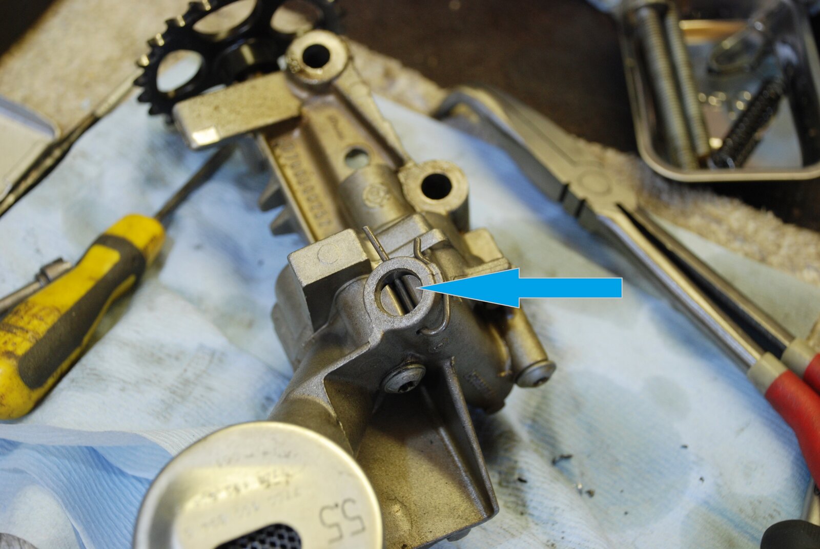

Haven't counted the teeth but it's standard 172. I've got a couple of them, both the same.
oil pressure mod effectively increases the tension in the spring in the pressure relief valve helping to keep the pressure up.
