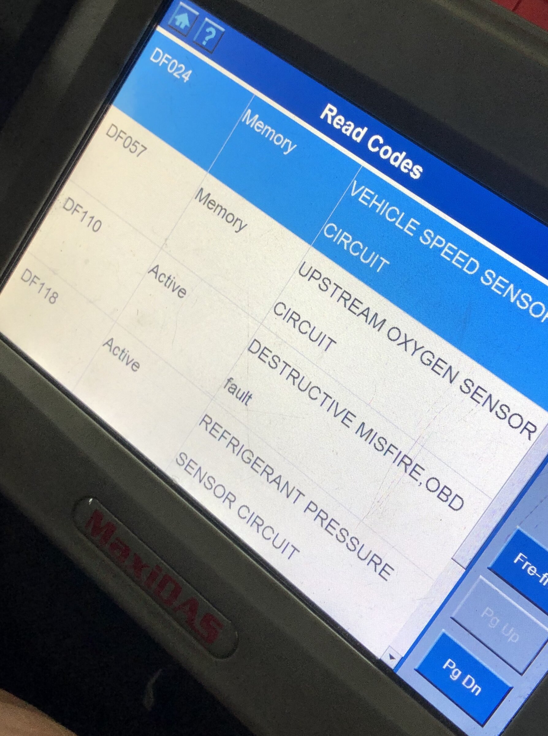

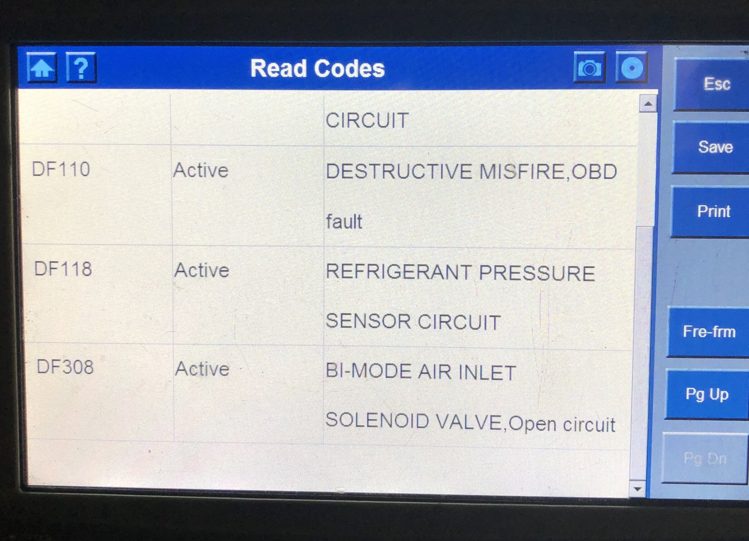

My EML came on at Croft last weekend on my 182. The car ran fine all day apart from 2 short misfires. I’ve put new plugs in, changed the coil pack and leads off another engine that I know are good.
Today I’ve plugged the car in and it’s come up with the codes in the photos. Codes DF110, DF118, DF308.

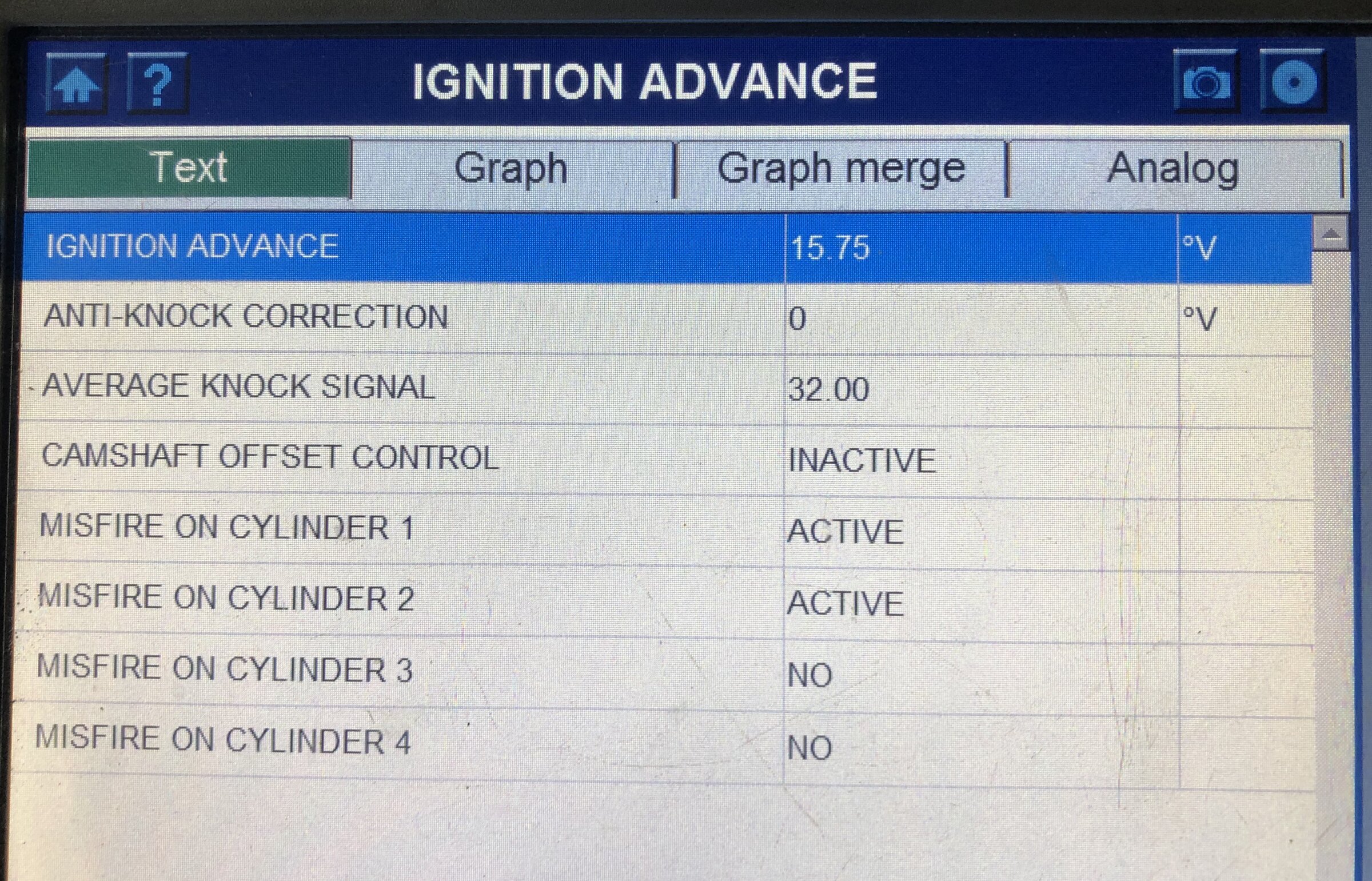

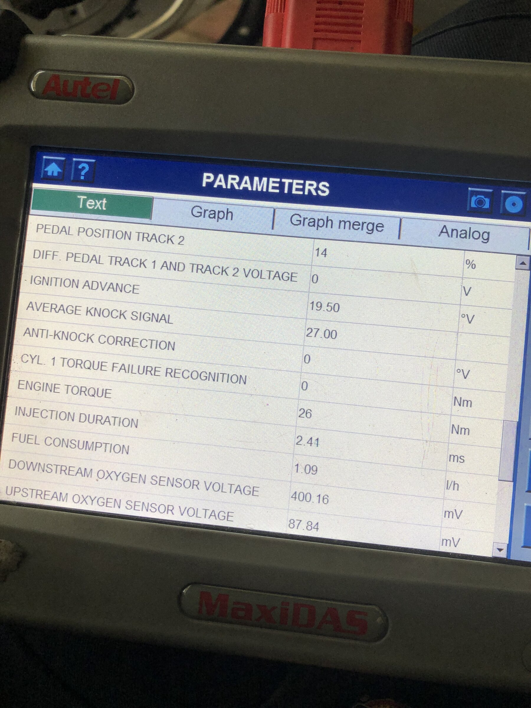

The downstream oxygen sensor voltage doesn’t change from 400.16mV. Is this faulty? Shouldn’t this fluctuate on a live reading while the car is running?
Also misfire on cylinders 1&2... is this related to injectors?
Any ideas would be appreciated!
