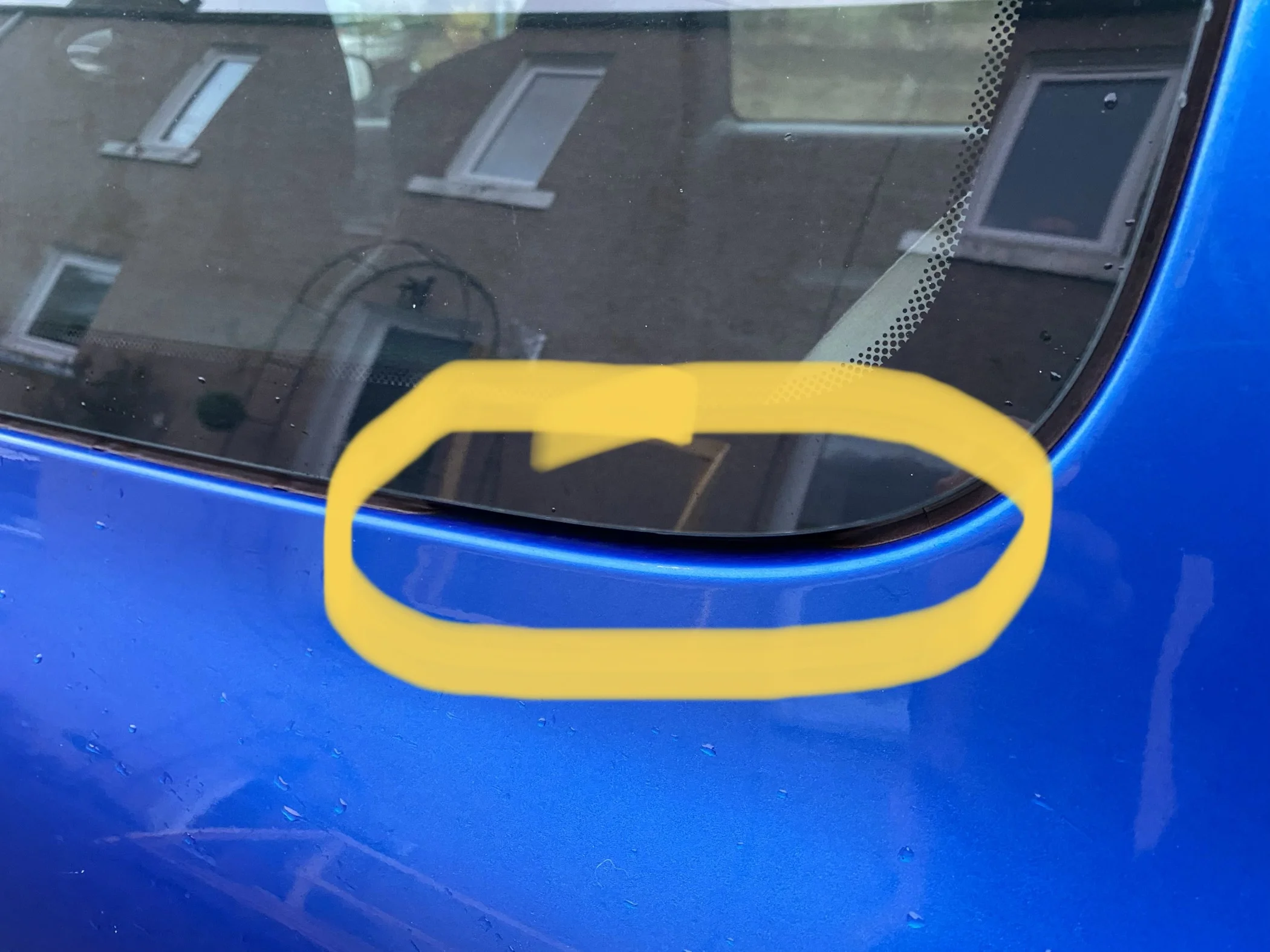

I’m hoping the collective minds on here can help out with this one.
I’ve been working my way through sealing all the leaks in my Clio 182. Pretty much spot on now, however, I just want to double check these rear quarter window seals.
From what I’ve read the rear quarter windows are bonded in and so the seal can’t be replaced without a new window.

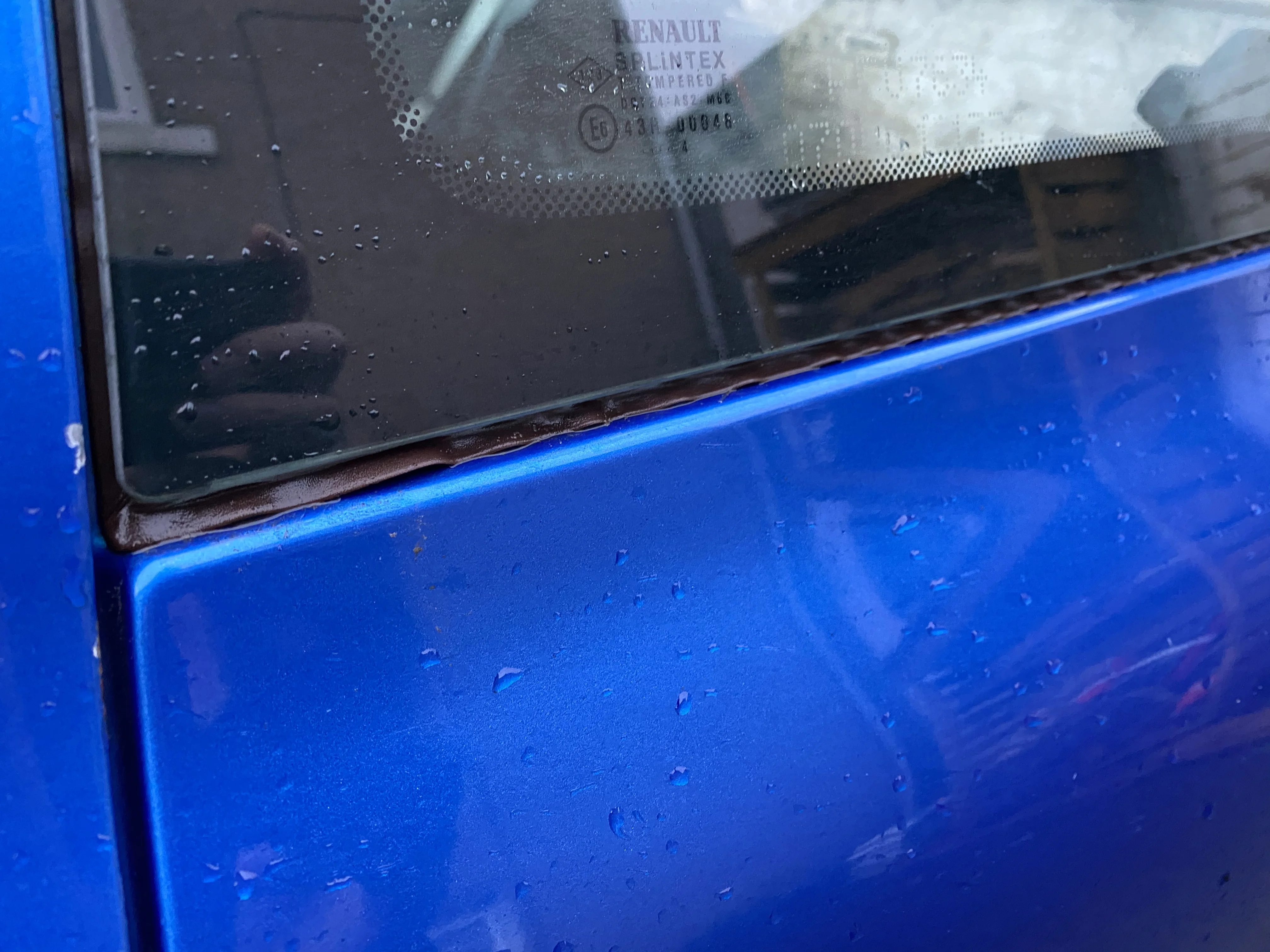

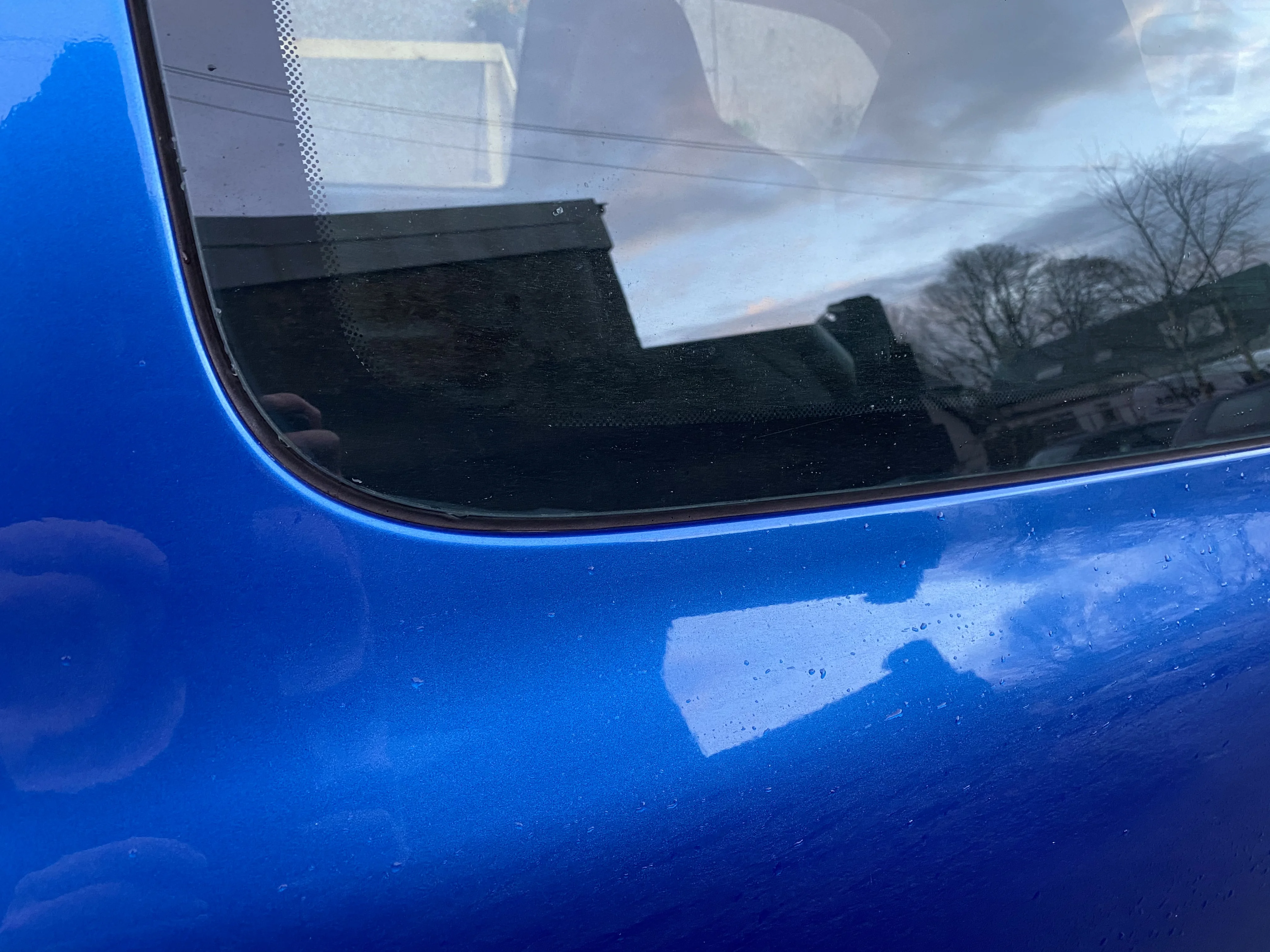

The seals on mine look awful - see pics.
So my question is how should these seals sit? Are they folded back in under the window (circled in the first pic) or are then meant to sit flush with the body like the remaining pics?

Supposed to sit flush. Mine are awful too but don't leak.
Think that section just shifts water away, doesn't actually make the seal
HaveaCuppa
I’ve pulled the tucked in seal out so it’s all sitting flush now.
No leaks so far so either so your right about it not being the actual seal.
Cheers for the help :)
