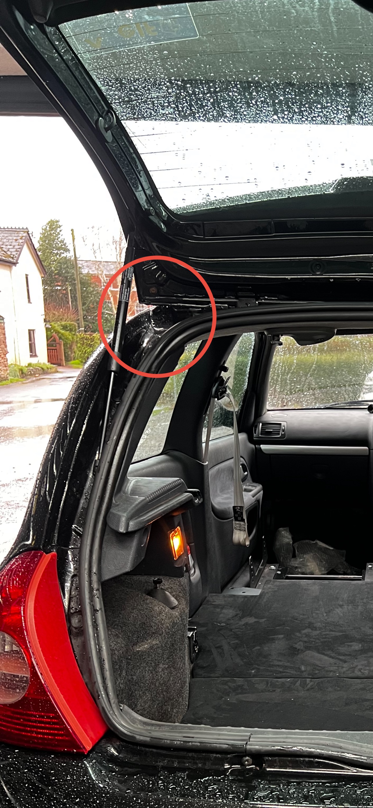

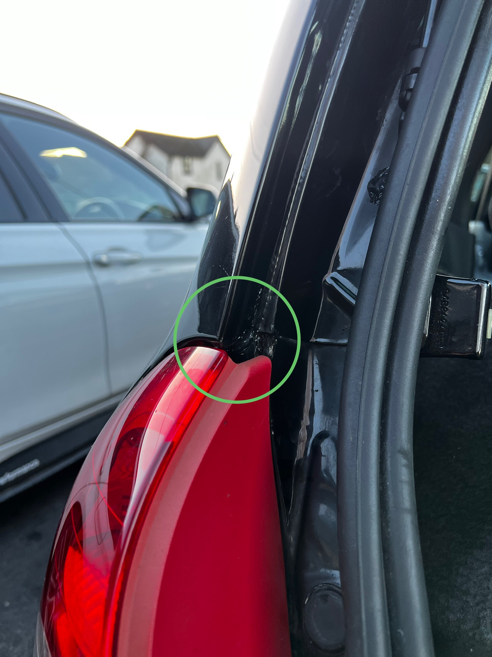

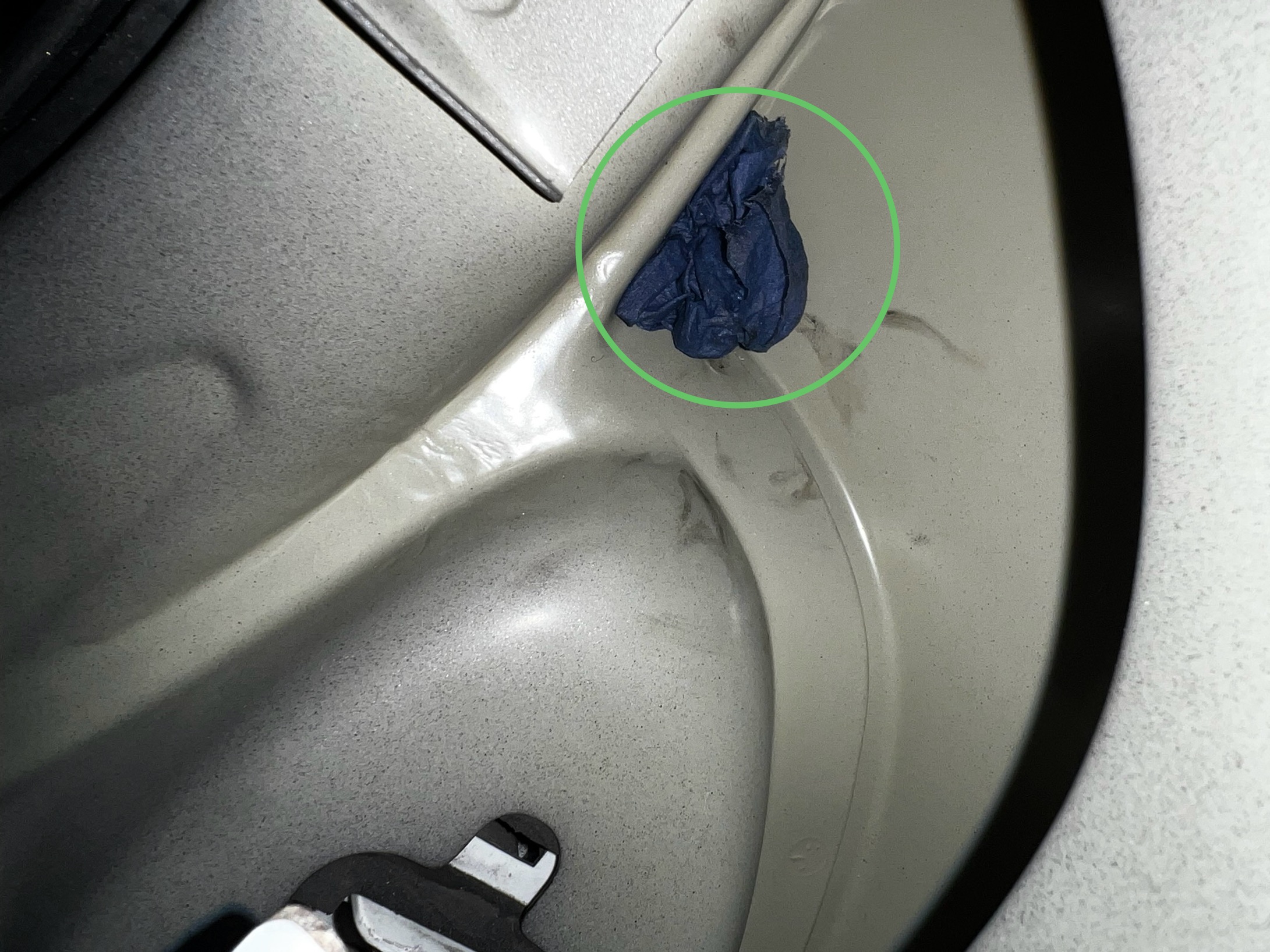

I have an ongoing leak at the rear of the car, on the corner where the top of the taillight meets the boot. I’ve searched every forum I can, siliconed the boot stops, checked any cracks on the spot welds, siliconed them, taken the trim off on the side/rear of the roof (not sure what it’s called) re-sealed the spoiler and I just cannot for the life of me work out where it is getting in. It’s almost like it’s inbetween the inner/outer skin of the car? It’s getting rather annoying as everything, headlining etc is bone dry and I can’t put my cage/false floor in whilst it continues to leak.
I’ll put some photos below of where it’s getting in. If anyone can give any pointers, will be greatly appreciated. Cheers.

might be worth mentioning, from inside the car, we cannot see it leaking any higher up than where the tissue is in the photos. But, it does seem to leak in when pouring water over the centre of the car in the panel gap where the boot meets roof.

Thanks for the response Marc. I’ve already sealed the boot stops, and re-fitted the rear light a couple times. But where the water is getting in is a good 2-4” higher up the car than the boot stops/hole for the light connectors.

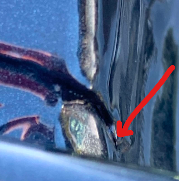

UPDATE - I believe I’ve now resolved my leak. I ran the hose up the side of the car starting low and working my way up until it began leaking. It was in fact somewhere near the roof rail, took the plastic trim off and there was a hairline crack right on the corner where the roof meets the back end of the car/top of the rear quarter. It was really difficult to see, I guess as these cars are getting older (plus me using mine on track) is causing the factory spotwelds/bonding to have cracks, lift etc. I siliconed over the crack, put the plastic trim back on, let it dry and ran the hose again and it was bone dry. However, it’s not hammered down since doing it which will be the real test. I’d imagine you guys potentially have similar ‘hairline cracks’ somewhere on your shells although they’re likely not going to be in the same place and it was a PITA to find. 🙁

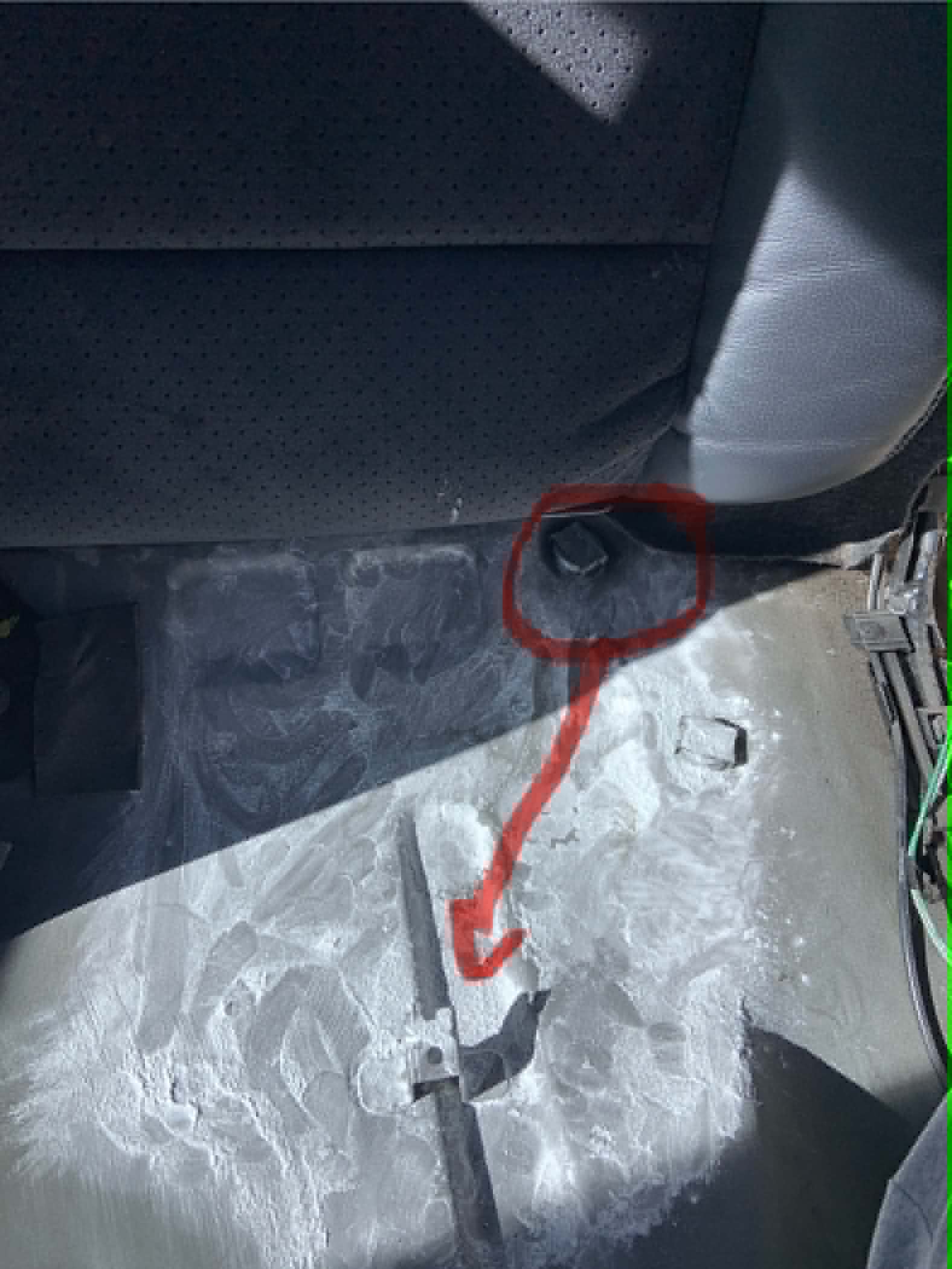

Appreciate this! Just wanted to add some extra info/context/background info to this thread for anyone chasing the same leak.

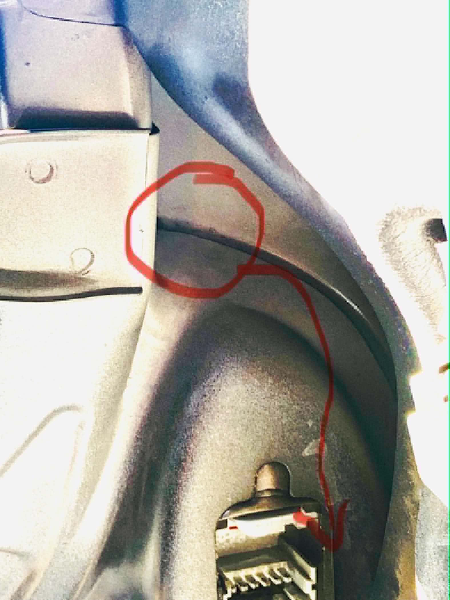

I was having the same symptoms as the OP. Originally found water under the back seat (LHS). Pulled the bench out, ran the hose and found water emerging from under the back seat/boot carpet (red circle), and then tracking down into the recessed void:
Next step was to pull the boot carpets out, remove all of the rear trims and repeat the hosing process. I was surprised to then see water appearing in the bodyline above the taillight. The water was pooling in the red circle, spilling over the edge, running down past the back of the light, onto the edge of the boot floor (I have a 172 so it has a spare wheel well), and then making its way towards the rear seat. It must not be 100% flat on the boot section as the water moved towards the seat pretty quickly (car was on a flat surface):

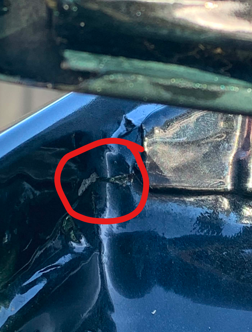

Eventually, thanks to Harvey's post above, I went over the back of the car with a magnifying glass and found a small hairline in the seam sealer at the join circled in the picture in post #10. Had a quick scrape with a steel pick and managed to remove some dead seam sealer which I guess has failed with time/water ingress:
Then, once I removed the gutter trim and looked from the top, I could see a tiny (but obvious) gap as well:
Cleared up both areas as much as I could, applied some POR15 as a precaution (even though I found no evidence of corrosion/rust), and then a fresh bead of Sikaflex 227 over the top. Sprayed some lanolin and cavity wax into the back side of the skins while I had all the trim off as well.
