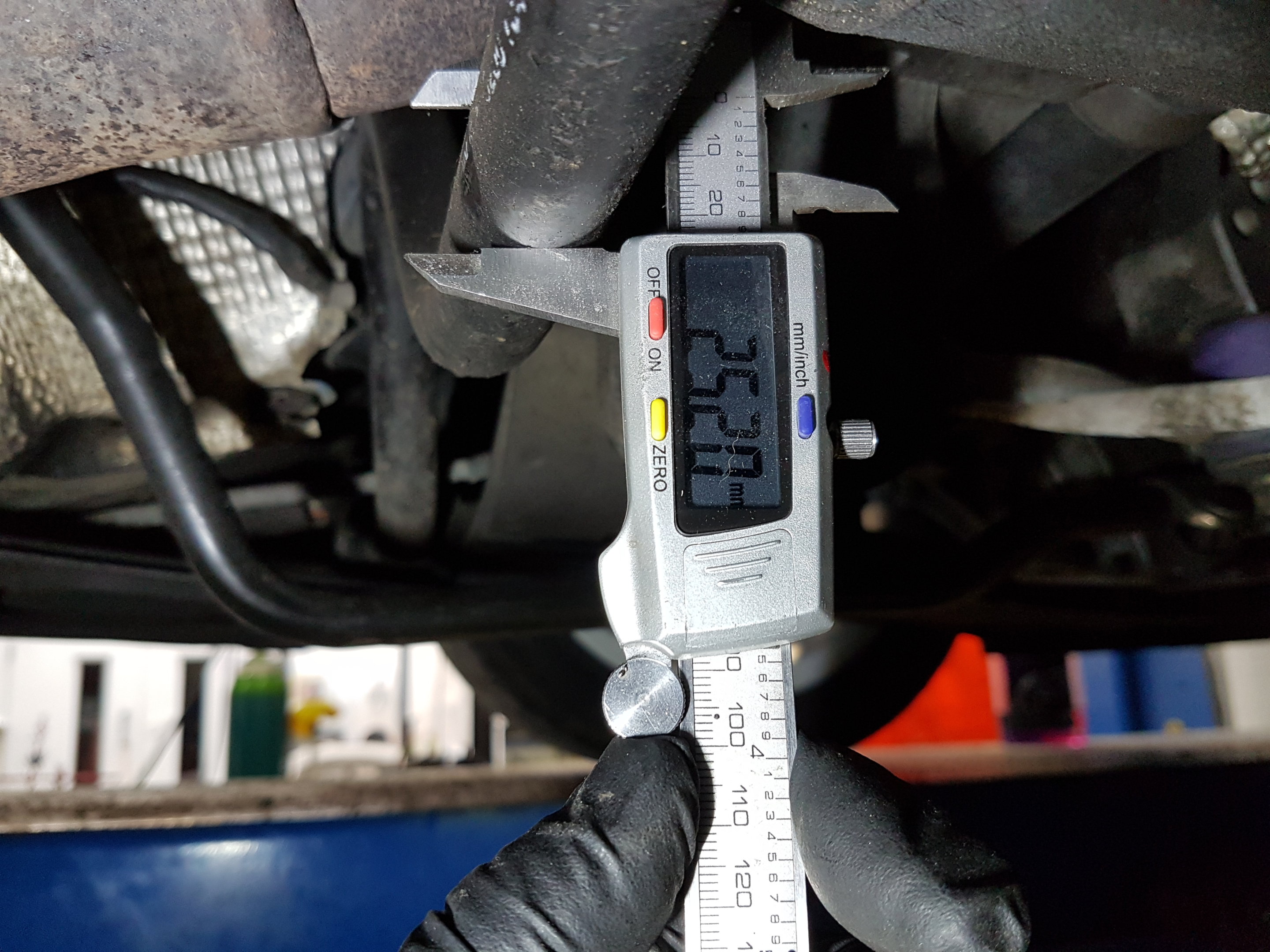

Can anybody recommend me the best place to buy road series anti roll bar polybushes clio my clio 182 ff.
I've measured the roll bar and it's 25mm so I've found a set of inners on euro car parts website. This is good as I can use a discount code and there is one branch that is local to me, however on there site it doesn't state the size for the outer ones.
Are the ones link the correct ones?
Inners:
https://www.eurocarparts.com/ecp/c/...f200fb5436b0a772f15773bc4f04f57bcbf5fa&000973
Outers:
https://www.eurocarparts.com/ecp/c/...0310e6c2e73c14f246b0b5470b70393f73634a&000973
Cheers, Mark.

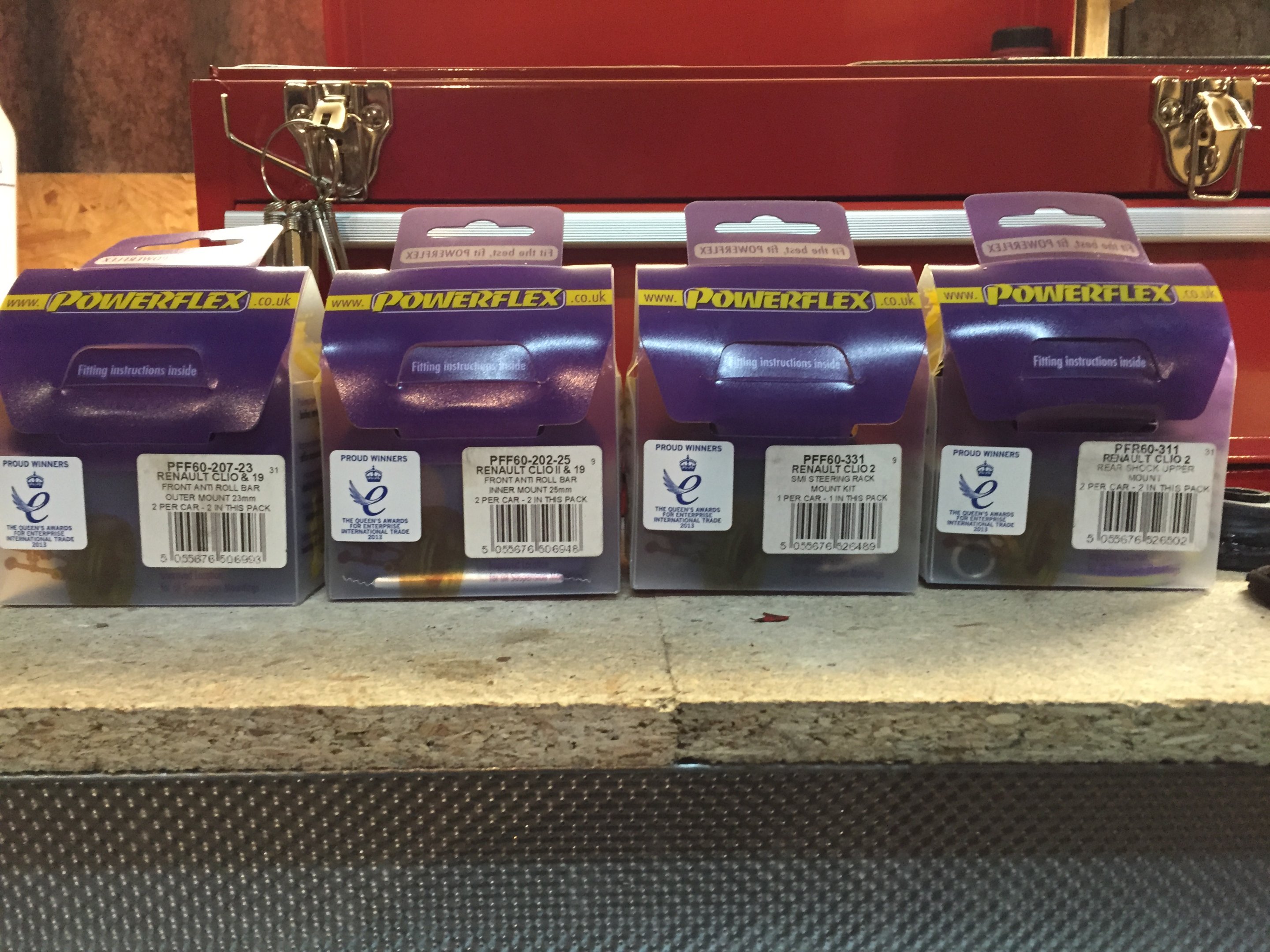

MarcB
  Too Many
Clio 182 FF & Trophy
Outer ARB 23mm - PFF6020723 (ECP Part Number - 973740061)
Inner ARB 25mm - PFF6020225 (ECP Part Number - 973740161)
Rear Upper Shock Bushes - PFR60311 (ECP Part Number - 973740271)
Dog Bone Mount - PFF60211K (ECP Part Number - 973740111)
Black SMI Steering Rack Bushes - PFF60331 (ECP Part Number - 973740281)
Black Front ARB Bush 23mm Outer - PFF60-207-23BLK (ECP Part Number - 973740065)
Black Front ARB Bush 25mm Inner - PFF60-202-25BLK (ECP Part Number - 973740165)
Black Rear Upper Shock Bush - PFR60-311BLK (ECP Part Number - 973740275)
Jekyll
I remember it loosely at the time and I remember giving you a PM at a later date but can't remember what it was over.
However, I know I got the wrong end as I acknodged fault and apologises and also, seen how much you do for members, whether it's with parts, charity or even with part number like the above picture.
:up::smile::kissingheart:
