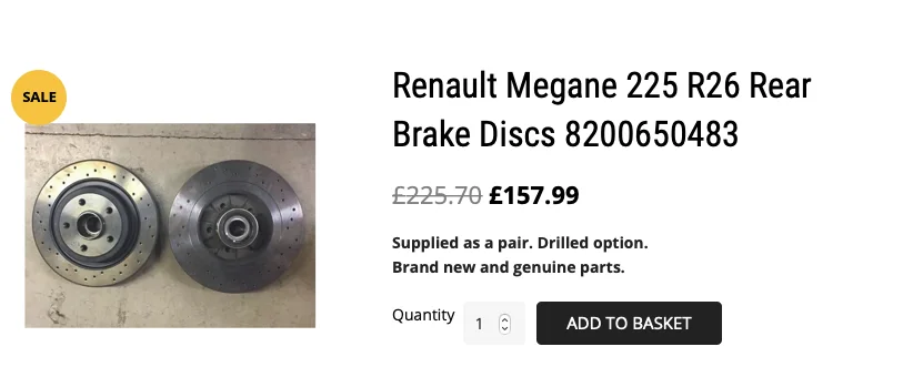

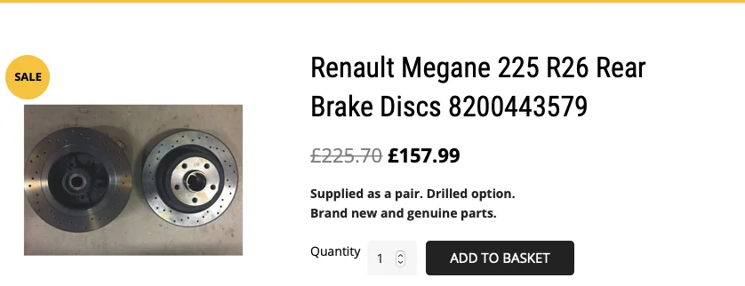

Reason for this is I will be buying Genuine Renault drilled discs from the 225/ R26 Megane but there is a choice.
(25MM BEARING) - 8200443579
(30MM BEARING) - 8200650483
if your near the car, if a 30mm socket fits on the nut its 25mm and if a 36mm socket fits its 30mm bearing
Clio 197 = 30mm bearing in the back discs.
25mm bearing is for the early 225 megane
