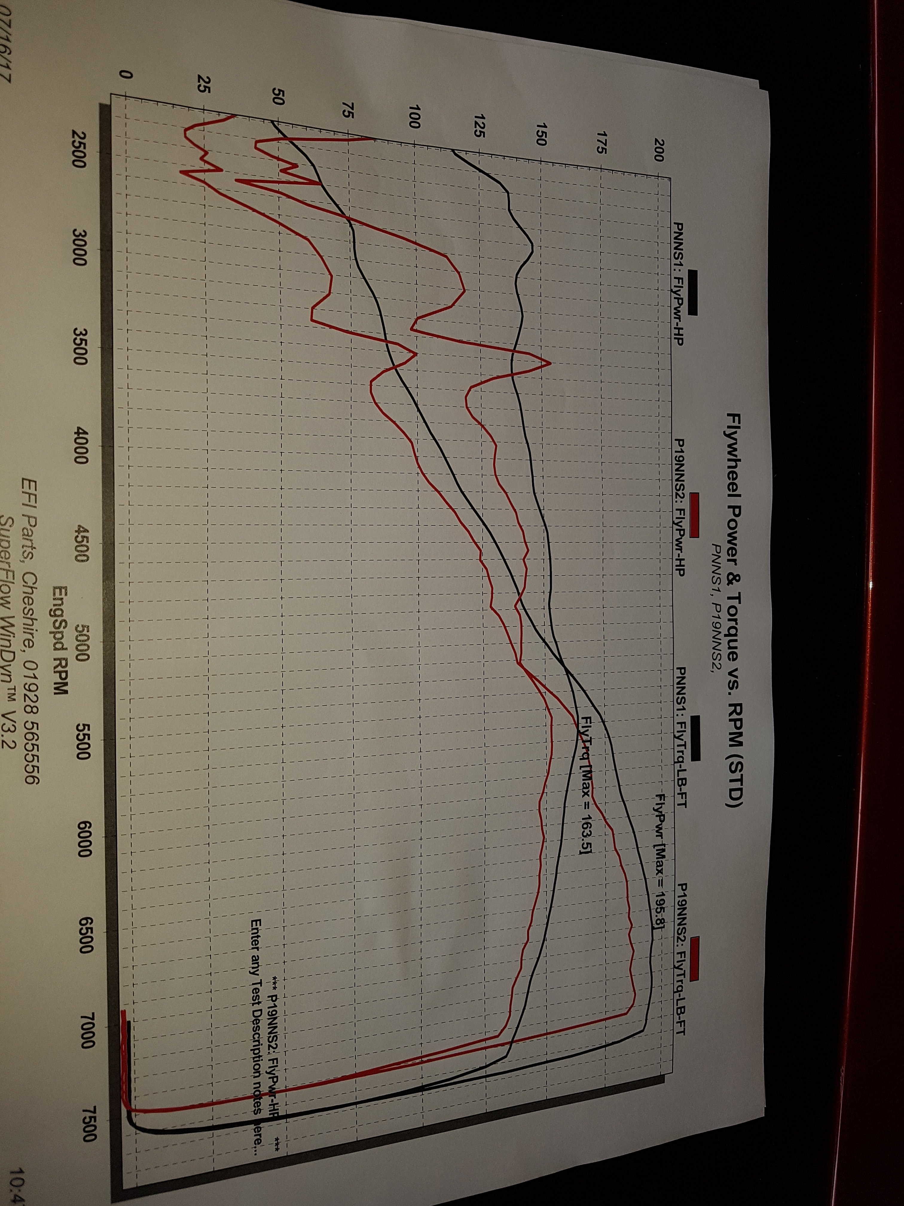

who's best for mapping in north east or Yorkshire ? Cheers.
had one done at efi a few weeks ago. the red was on standard map.
  Clio 200, BMW135i
Yeah it needs the EFI map - i still cant believe Renault made these cars with this fault!
