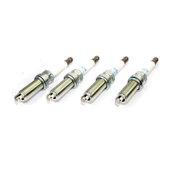

I had the spark plugs changed and also the aux belt and my car had done 62000 miles when I had them changed, I think the belt is around 70000 miles and spark plugs are less but I had no proof of them being changed. The plugs are expensive and the ones to use are these
