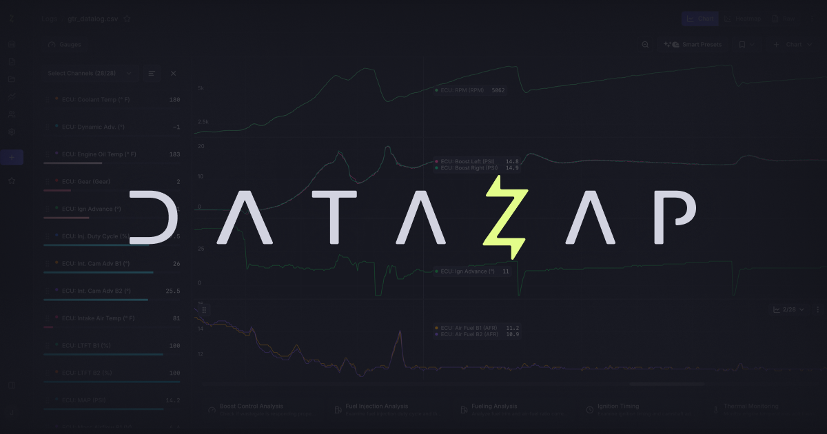

Here’s a data log of mine for if you want to see the fuel trims. I didn’t caputere everything I could though. Otherwise there would be too many PIDs. Data speed already wasn’t optimal. You can select PIDs when you click on them. Unfortunately i didn’t capture the time correctly. STFT and LTFT are a little less dramatic than how they were with the Hella map sensor. Everything you mention sounds very familiar.

Do you drive my own Clio ?! :LOL: It is exactly what I have.

Do you have a similar record with MAP also? Do you have the same MAP behavior: when you release throttle, MAP is ~20 kPa, but then it settles to >40 kPa in idle.

I can make a data log for you with that specific info. Just idle and then a couple of times a blip of gas? Or do i hold it for a couple of seconds? Engine warm, cold or both? Excuse me for the excessive questions, but i’d rather have the log be useful for you. Oh the life of working in tech haha.
If i’m going to make a data log anyway, do you have any other requests?

Here’s a data log after my drive home from work. I just let it idle and did one short blip at the end since you mentioned it. The MAP value started at about 39 and slightly got higher, but not more than about 42-43 as you can see in the log. I’m not sure if my car does what it’s supposed to do either. But all info is welcome at this point I guess.
I’m starting to think my injectors are leaking. I remember I did a fuel pressure test with my friend, and he said that it was good. But I remember that I thought it was ever so slightly underpressured. Maybe that and a combination of old cat being more ruined by that. Would totally explain the negative fuel trim too.
I’ll have a look at the log you made in a bit and see what your car does. Datazap is awesome indeed :) glad you like it.

Thank you for that.
It confirms we have the same car. When you release the throttle, the MAP goes down to ~20 kPa, which is normal. But when the engine goes back to idle, the MAP is >40 kPa, which is a partial load pressure... Yes, we can't say if it is normal or not, as we have 2 broken-down cars...
But your short term fuel trim is oscillating around zero! Mine oscillates around -30% in idle 🫠
Since the entire air intake system has been checked and repaired, I also suspect the injection system is faulty. I don't know if the mechanic performed the pressure test to exclude it, I think no. But I have noticed that the car takes longer to start after a prolonged stop (leaked fuel remaining?). And an injector leak would explain the fuel trim (especially in indle, and less significant in charge), the higher consumption for sure, sometimes the misfires...

Woah this is the first time i've actually seen the STFT work correctly on my car. I feel like the car sometimes feels a lot better than other times. And i can't really figure out under what circumstances. I see your STFT is indeed also very negative at idle, which is what mine usually kind of looks like too. I don't know why this happens now haha. I'm not sure if my STFT would be different if i did the same reading when cold. Want to check that later today. Thanks for making the log! It's so helpful to finally be in contact with someone that has the same car, the same issue, is willing to make logs and is actively responding.
So we both agree on the possible injector leak issue. I don't think i have any problems with the air intake too. And i'm glad you checked it so that we can both rule that out.
One thing that could also be happening is something with fuel return/vapor purge. Which could make it run a bit rich if it bleeds to much fuel vapor into the air flow. But to me that also counts as a fuel issue. But i think it is less likely. Just mentioning it as it's not ruled out definitevely. I changed my evap purge valve and tested it so i know it seals and works correctly but still the canister could be saturated. But i will first put my energy into the injectors since that is really the main culprit. I can also hear the injectors ticking a bit, but considered it kind of normal since i've posted a vid into a clio chat where everybody seemed to recognize the sound.
