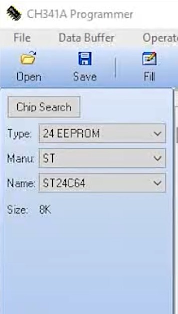

Did you use the guide that's floating about from Facebook to do the RS monitor? I've got the stuff to do mine but not got round to it yet
  Renault Clio 1.2 TCe
Yeah used that one, make sure you get the chip and clip they link to, I started with a cheap eBay knock-off which turned out to be a load of shite. And the bug thing the guide didn't tell you is that when you go to read the chip off the car you have to make sure you have the correct chip selected on the software 👌

Ahhh I bought the cheaper eBay versions, are they no good then?
Can you remember which chip it was?
Yeah just checked, so when you're on the CH341A programming software and you're plugged in etc, select 22EEPROM for chip type, ST for 'manu' and ST24C64 for name. I didn't clock this for weeks so took me much longer than it should've hopefully you can do it quicker than I did 🤣
