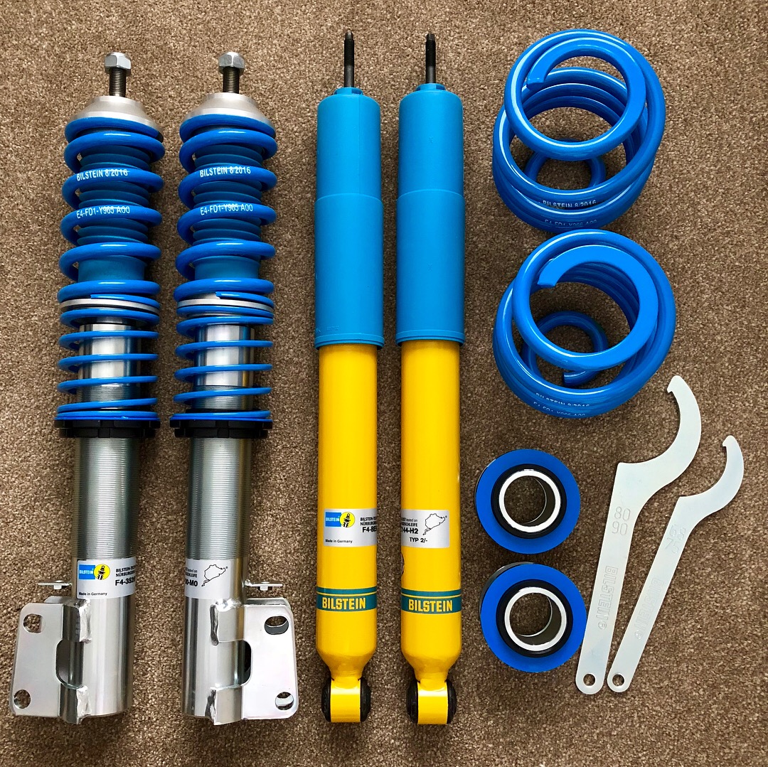

Fitted a brand new set of Bilstein B14s last week and have done around 300 miles with them so far. The problem is I'm finding the car extremely bouncy and the car never really settles down. I've run coilovers (Tein, BC racing and HSD) on my previous cars so know the difference between them feeling harsh.
They didn't come with any setup instructions so I've set them to 335mm front and 345mm rear from hub centre to wheel arch. I transferred the rear boot/bump stop and top mount from the rear shocks and put new top mounts on the front along with the gaitors that were supplied.
The best what I can describe it is that it feels really under damped which from the reviews makes me feel something isn't correct? I can't feel whether it's the front or rear as the car is so unsettled.
Any ideas please before I fire an email off to bilstein?

Did yours come with all of these parts?
They aren't rock solid like a lot of dampers, they are a little firmer than cup springs/shocks but the ride quality is miles better

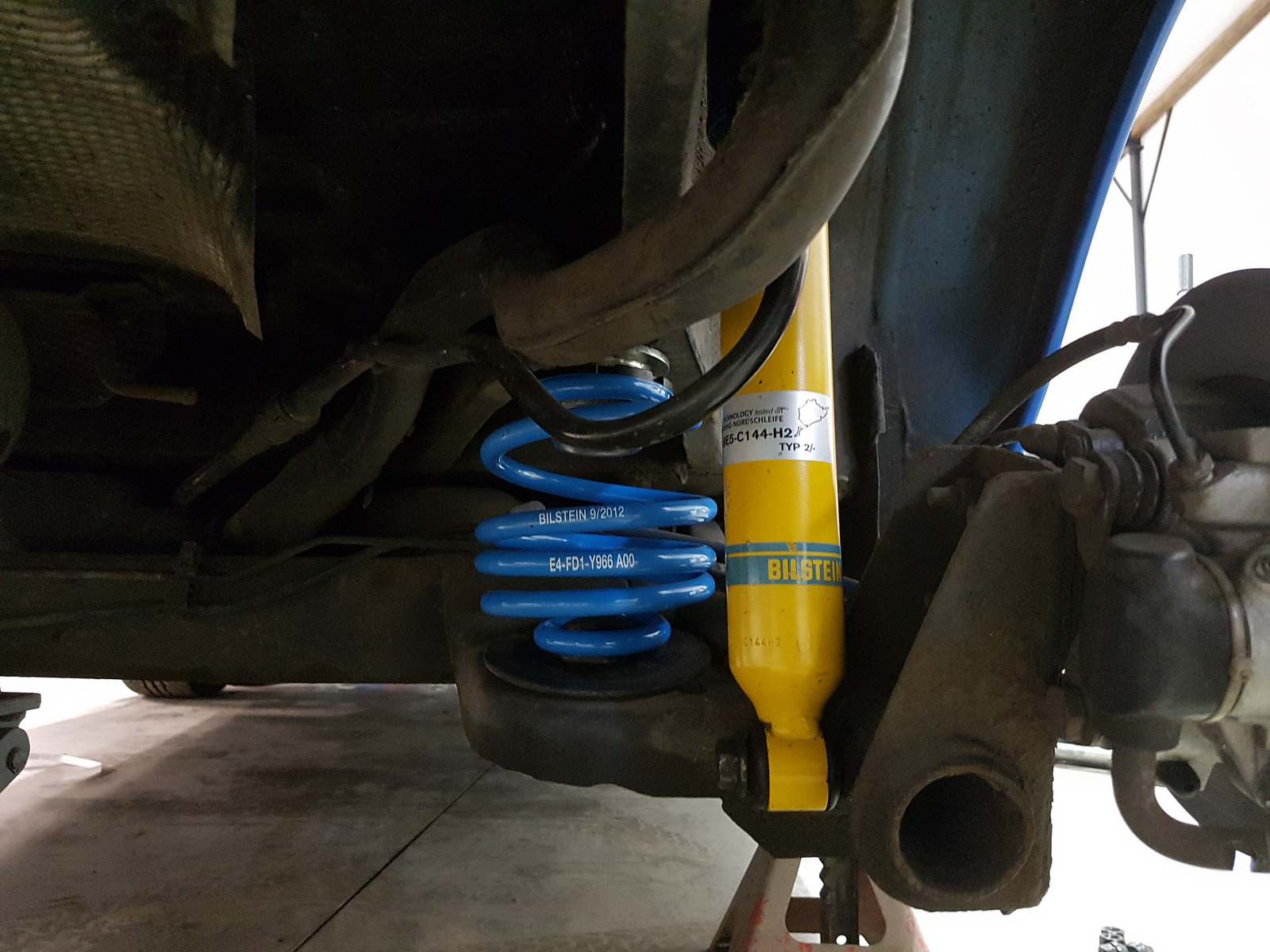

Mine were fitted upside down when the previous owner had b14’s fitted. Think he had the same problem. Writing on the springs were upside down and noticed by another member. Swapped them and fixed issue.
Thanks for all the replies.
I've definitely got the springs the right way round. The adjusters are on the top and the flat part of the spring is in contact with the adjuster. I'm going to try and raise it up an inch when I get some time as I feel it may be riding on and off the bumpstop?
