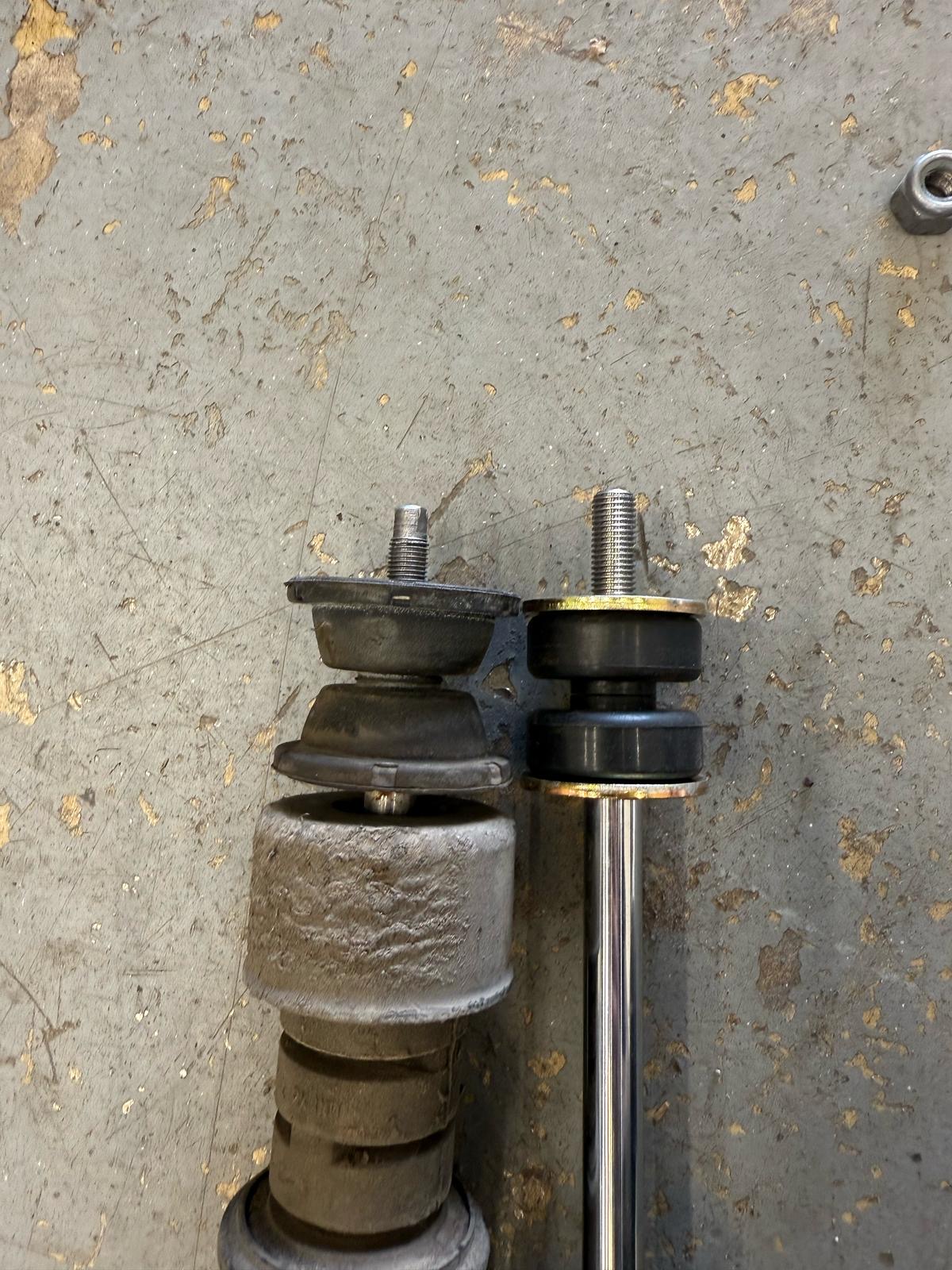

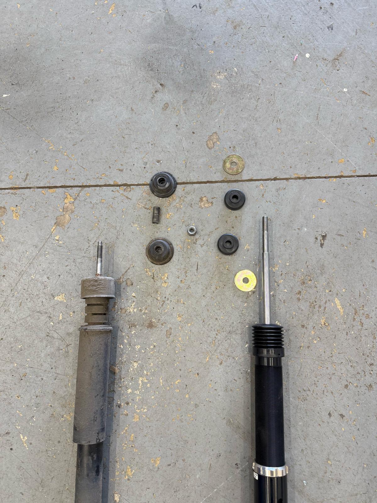

My 182 is currently at a garage having BC coilovers fitted. The garage is a specialist in suspension setup and tuning including British touring cars so I am assuming they know what they’re doing, though they don’t do many Clios.
They have fitted a set of BC coilovers but on test drive there is a knocking from the rear.
They think the issue is the top mounts but can’t resolve it.
Is there supposed to be spacers for the BC coilovers? As you can see from the pictures they sent there’s a difference in the size and design of the standard vs BC top mounts, but they can’t just use the original mounts due to a diameter different in the strut.
Thanks for any help, leaving my car there until it’s sorted!

If you have the metal spacers installed on the springs to raise the ride height, could it be these knocking?

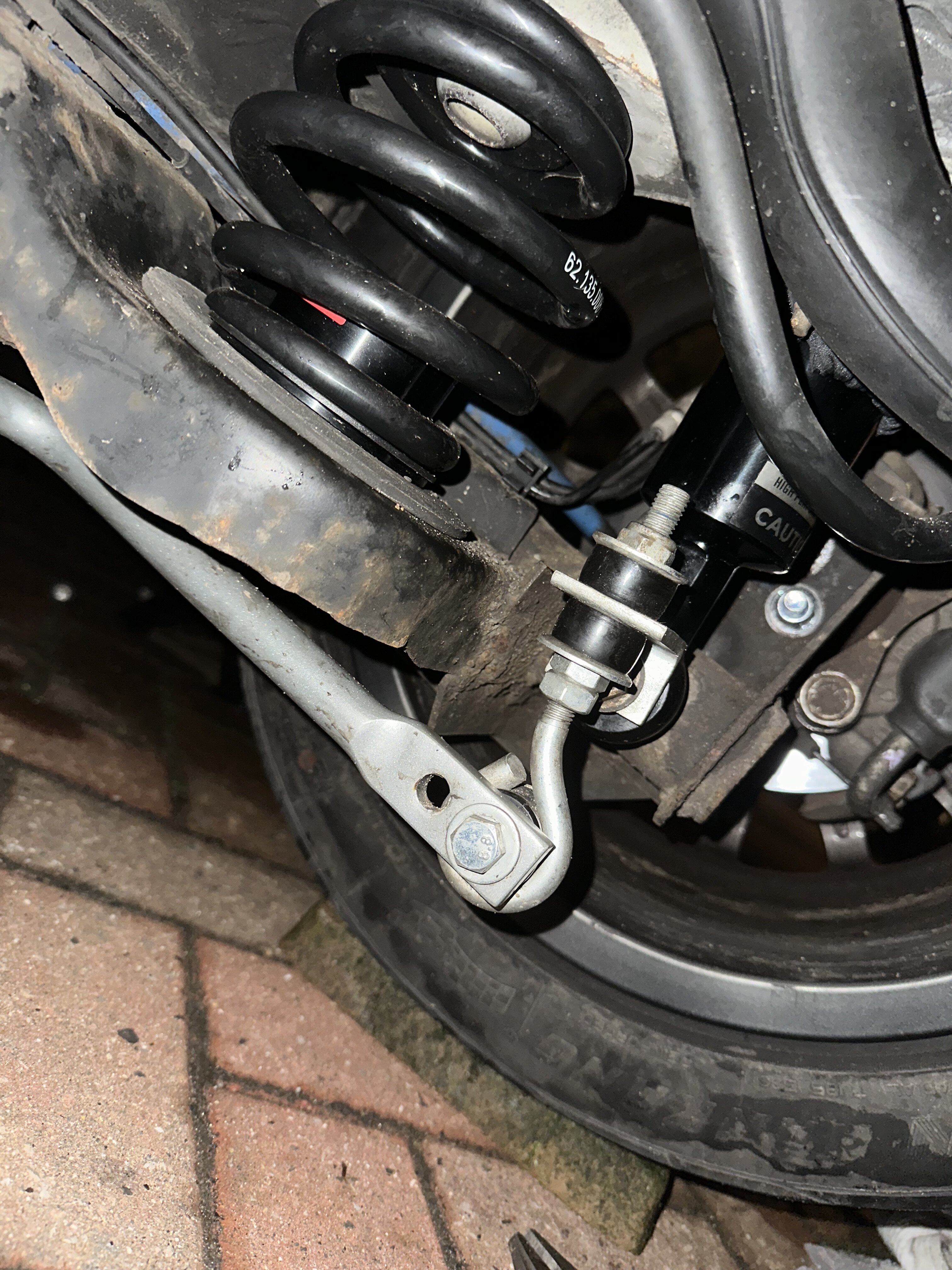

I’m having the same issues after fitting BCs on the rear of mine. A knock from the rear over sharp bumps.
Got the springs fitted with the bc supplied rubber spring locator on the top of the spring with the oem rubber isolator and the adjustment cup on the bottom.
Seems to be worse the harder the dampers are set

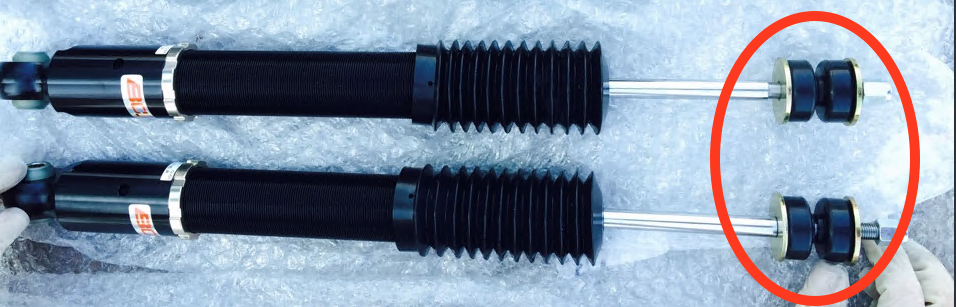

I am starting to think that it might be the rubber top mounts that came with the rears. The shaft body is slightly wider than OEM so the standard rubber top mounts don't fit [I know some folks drill them out to suit] and BC supply the top and bottom rubber mounts for the rears. However with the OEM mounts, there is a metal sleeve that sits in the middle and as the BC's are slightly wider, this sleeve doesn't fit [so I don't have this in place]. I am starting to think that given the top nut compresses only the top and lower part of the rubber, it might be causing some knocking given it doesn't clamp down onto the inner sleeve part.
This of course is only a theory but I have no idea where I would get a sleeve that would suit as I'm led to believe that even the likes of the powerflex mounts would come with an OEM sized sleeve and wouldn't fit the BC's. The part in the middle of the picture below.

Have you been able to tighten the lower shock bolt properly, they can be a pain with the Whiteline ARB in the way.

The bit circled in red below. BC supply the upper and lower but there is no metal sleeve that sits in between. So when you tighten it down, it just compresses the rubber.

Ones i've done were fitted as supplied by BC.
They do compress a bit.
Worth noting/checking that the rubber lip is sitting in the hole.
Yeah I’ve torqued it up to 105nm but might try it without the whiteline arb and see if that helps.
When you fitted the top mounts how tight did you tighten them? I ended up bottoming out the thread on the top mount as the rubber compresses so much.

Tightened until it stops.
