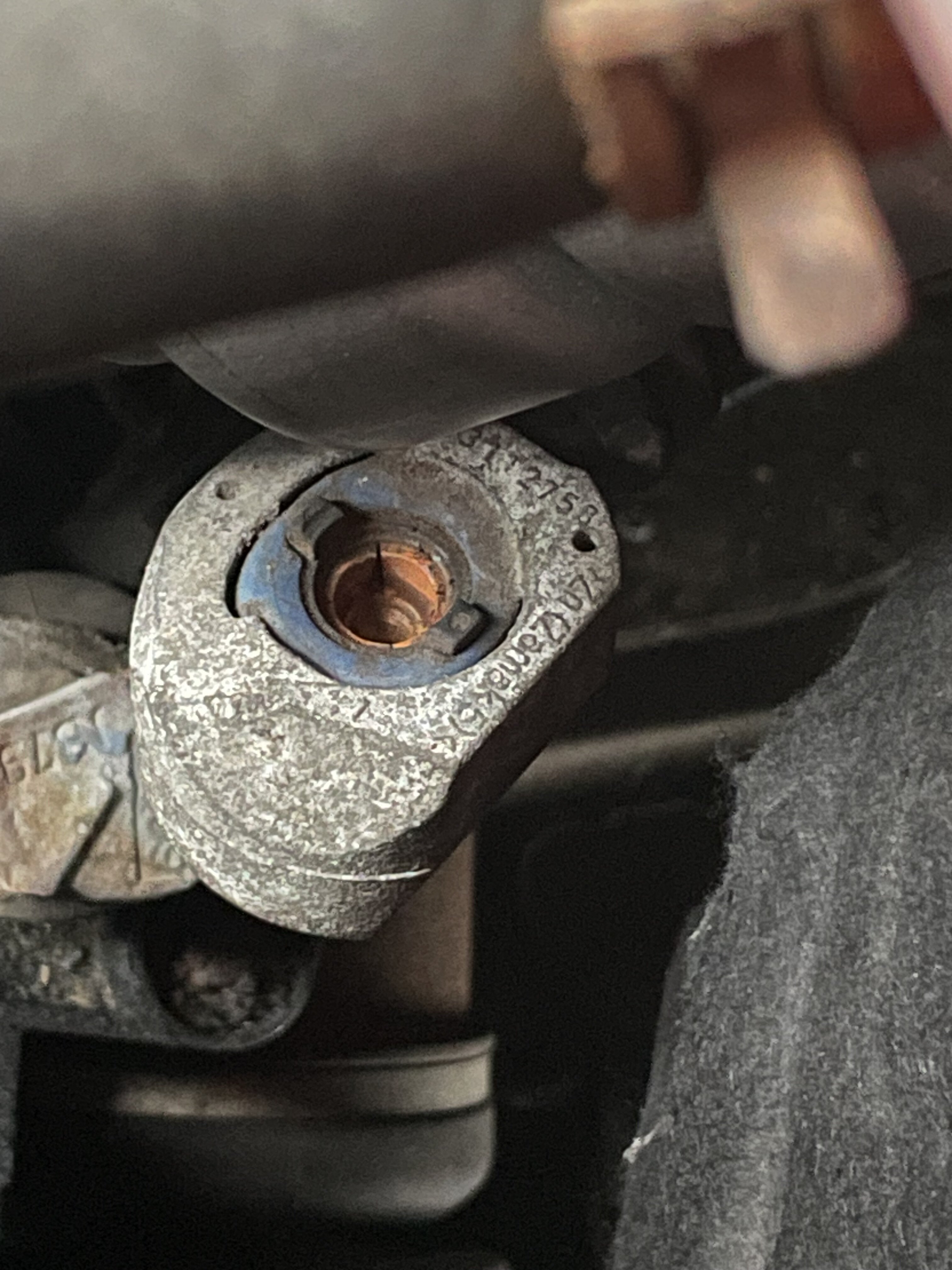

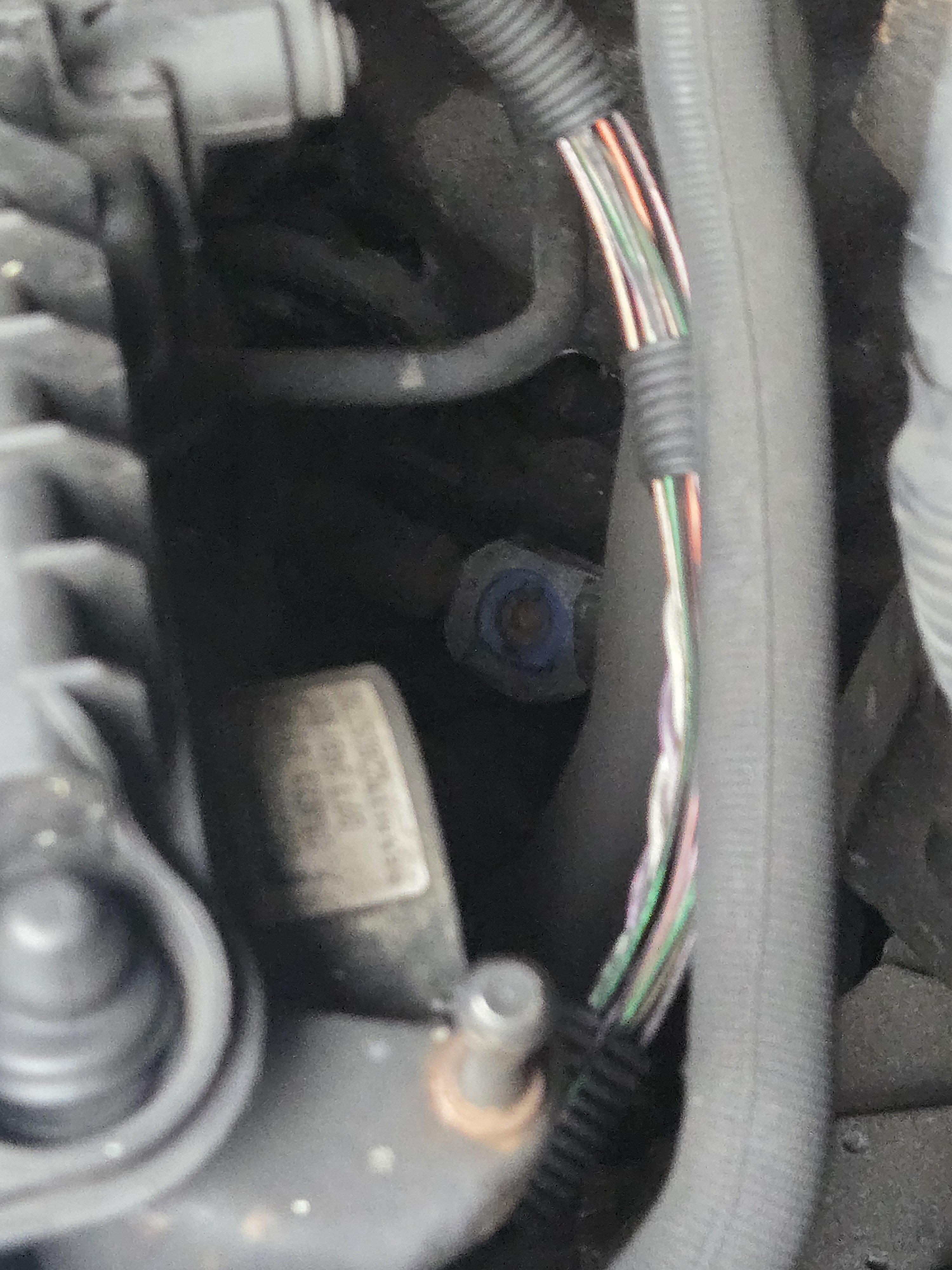

Car was fine when I set off home from work, pulled off the A1 and the gearstick was floppy and had no resistance. Can only get it into 3rd/4th which wasn’t fun in stop start traffic.
What would cause this to happen? Easy fix?
Krarl
Aye they're easy to pop back on. If it's a MK2 dCi 100
Look down behind the battery and ECU and you might spot it hanging there. After so many years the cables do fray and just all of a sudden go loose. I doubt that will have happened to the side to side cable though

Hero! Popped straight back on.
-KarL-

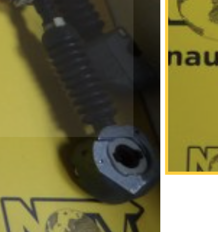

How bad is the plastic?
Theres some push tabs that usually break off but you can pop the plastic end out and push a new one in
Got a link for the clips? Not a clue what I’m looking for and Google throws up all kinds of s**t :ROFLMAO:
-KarL-
Will try and cable tie it on tomorrow, not bothered about it being perfect as i only use it to got to and from work.
