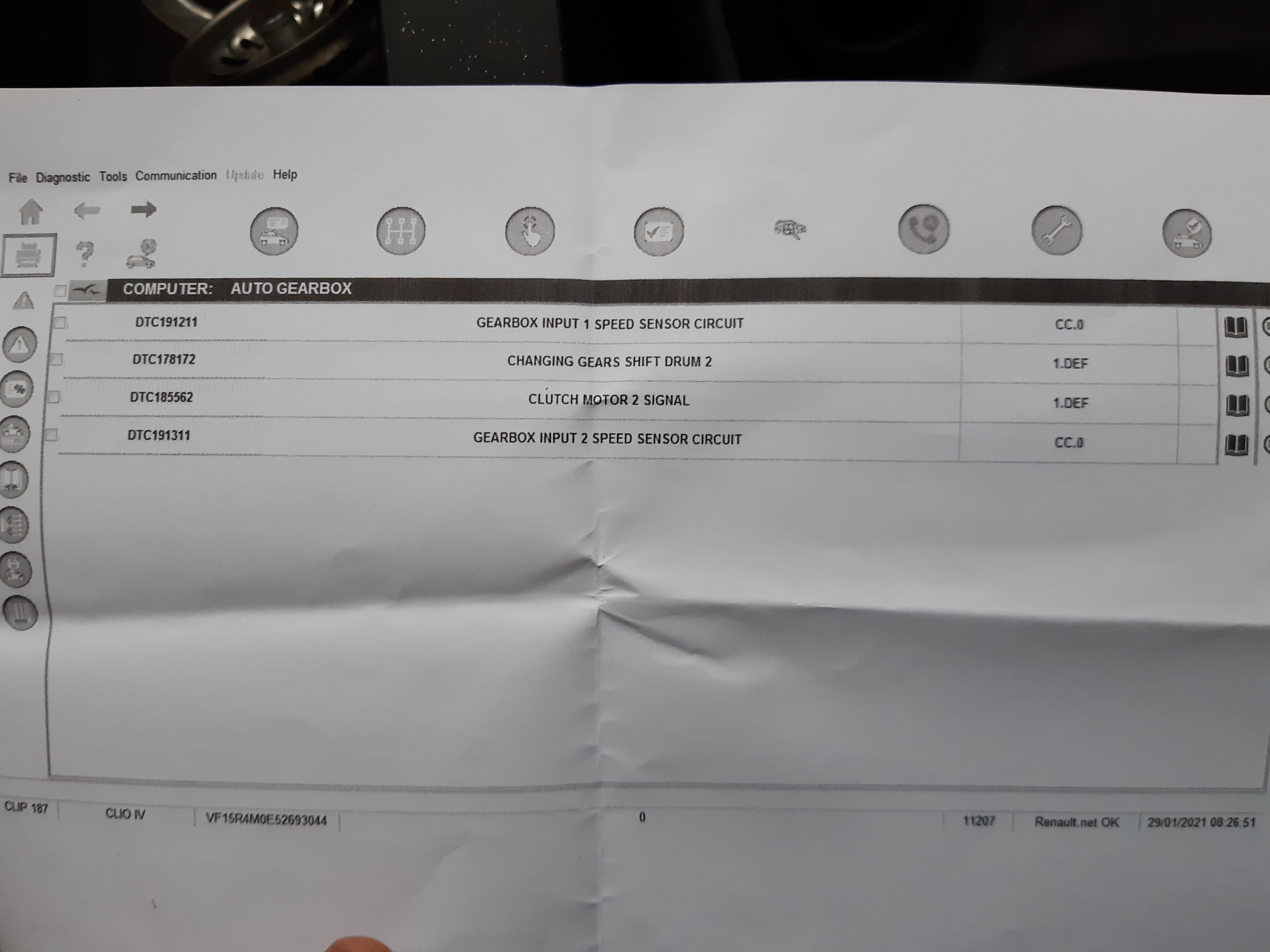

Hi anyone had these codes from gearbox and could a software update sort it or is it new clutches it only started after bad snow we had breaks at back were a bit stuck on . Seen some post saying they replaced battery and never had it come up again I tested battery its 11.8v engine off .
  Clio edc
These are codes

They are very fussy cars if the battery isn't strong.
I've seen so many reports of Wierd faults going away with a new battery fitted so I'd say that's the first task.
That sounds low. Should be 12.5 - 13.5v really. Get someone to start the car whilst you measure the voltage.
As Daz says, a low battery causes some very strange faults, and from what I've seen batteries are only lasting 3-5 years ish. So if yours hasn't been replaced then I'd defo go with that first

Mine was on the face of it a healthy battery but kept pinging up gearbox fault (especially on cold days!) changed the battery and it’s been good since.
