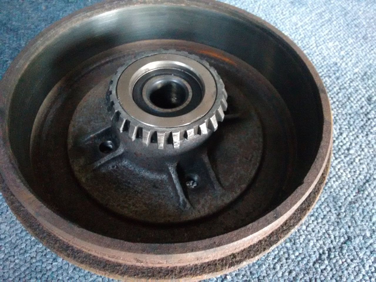

So one of the wheel bearings on the rear of my Clio isn't the best so I was going to change it before the MOT next week, so I bought some 2nd hand drum with a decent bearing to fit. Problem is some of the teeth on the ABS ring are chipped is this going to cause an issue with abs throwing up errors or will it be fine? I don't want to put it on just to take it back off again.
here is an image of the ring,
any advice welcome, thanks

That will cause a problem IMO.
No idea why you’d buy used drums, why didn’t you get the new bearing pressed into your own drum? It’s a 5 minute job to take off/refit.
