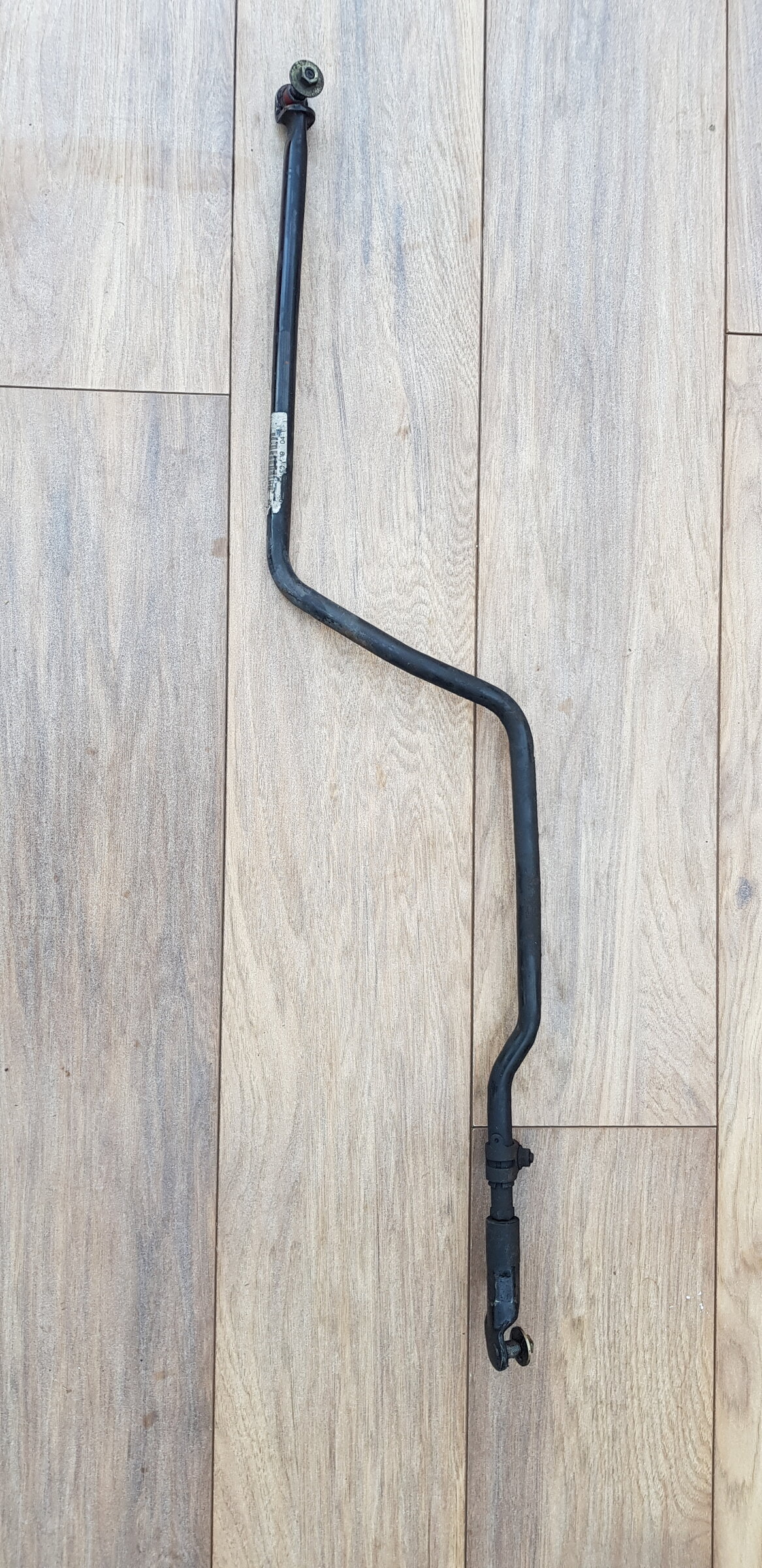

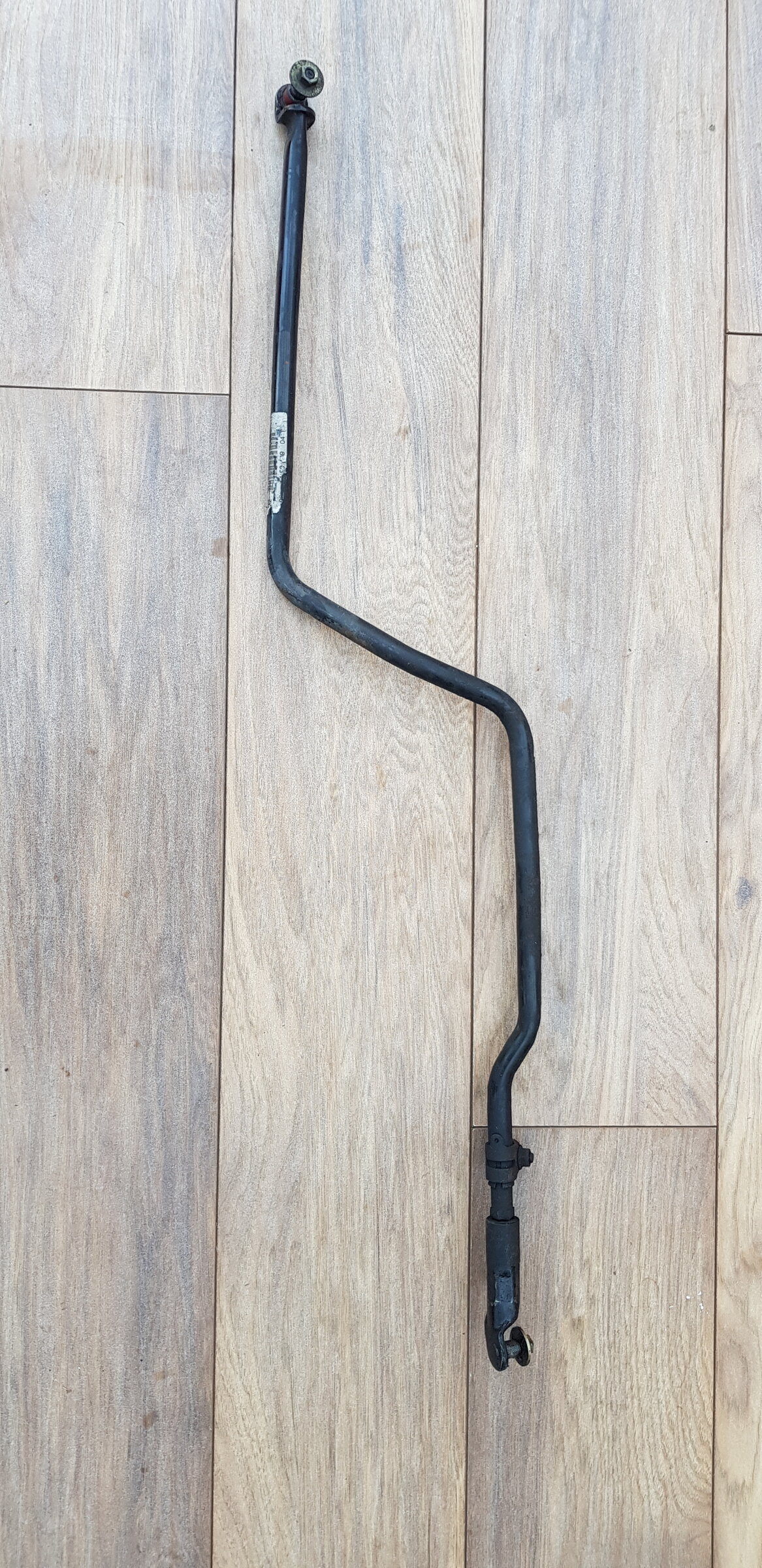

I have three spare linkages from Clios I have broken. Is it the part pictured below? Where are you based? I am assuming if the linkage is broken then it's just stuck in gear as can't be changed, hence when you depress clutch it can still be rolled.
If you get underneath and wriggle the linkage at the gearbox end it should go into neutral, unless there is another problem. I have never heard of the linkage snapping. It could have just come apart as the two ends slide together and clamp up. Hope that helps.

Yes that's definitely the part in the photo. We were hoping we would just have to replace that. The mechanic has tried to wriggle the linkage at the gearbox end it doesn't go into neutral.

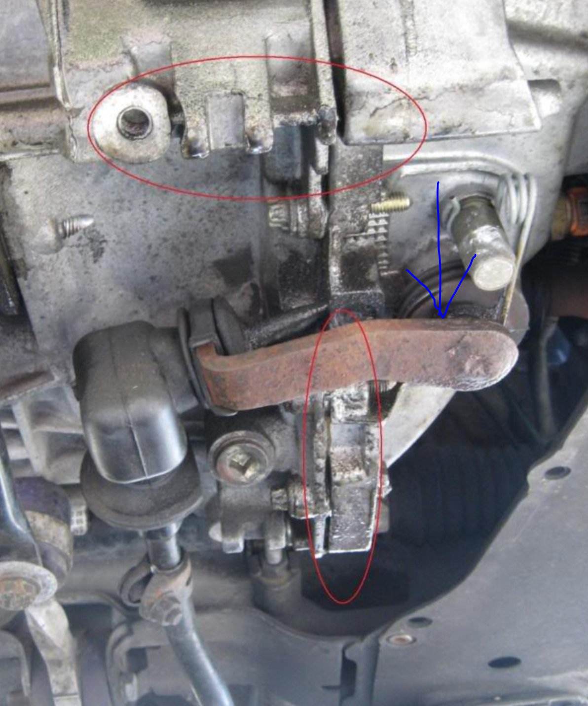

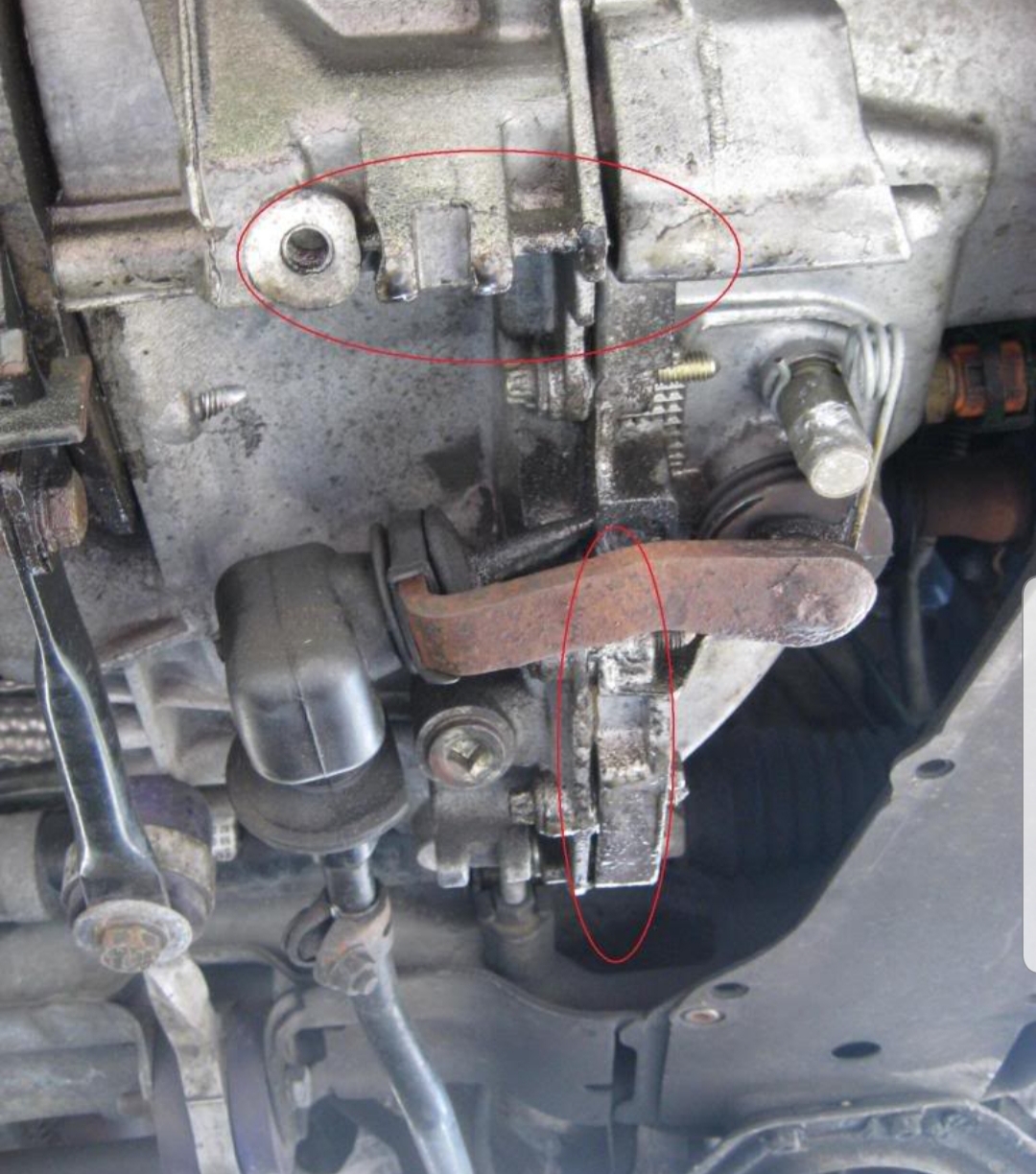

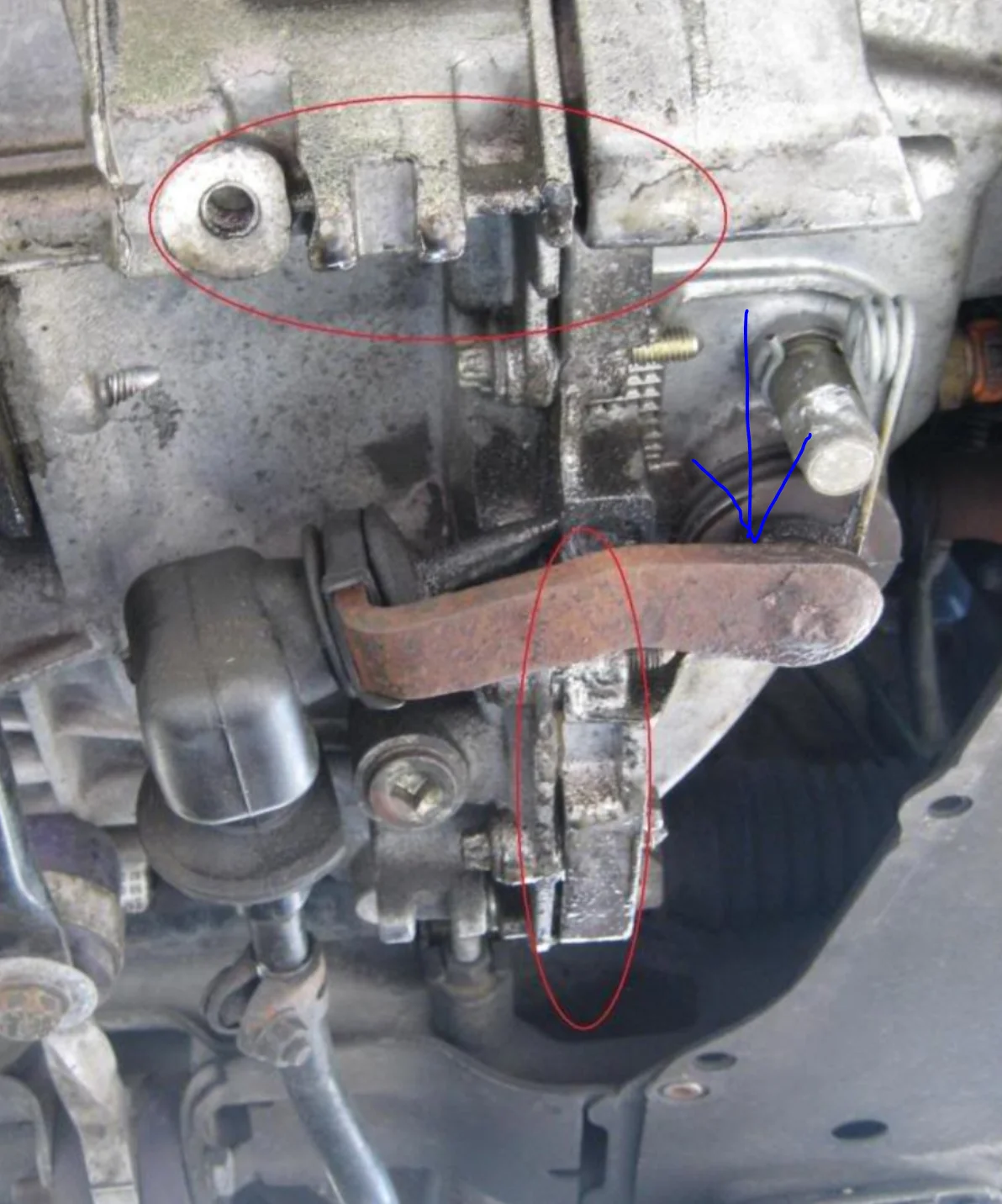

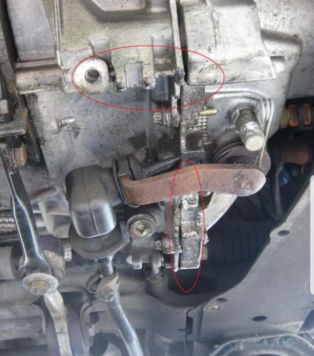

He was trying to hammer the rusty piece in this photo forward and back, not into the gearbox (up and down)?

He was trying to hammer it where the blue arrow is. So the motion was going towards the front of the car........but it wouldn't move.

That is what you would move, but not with a hammer!! I wonder if it has got jammed in 1st, 3rd or 5th and as your son has changed into 2nd or 4th it has pulled the linkage apart? Did the car not make and strange noises or lock the wheels?

The longer part of the linkage is connected to the gear stick end. The shorter part is the gearbox end.
