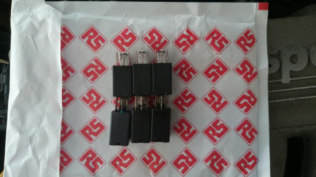

I took a look at the 3 black relays behind the passenger headlight and the connections were like a bluey/green colour. I cleaned them up and put them back in and the car fired up but cut straight out. Cleaned them more, same thing. Swapped them around and it fired up and ran but the revs dropped a bit now and then and it cut out once. I'm assuming it's a faulty fuel pump relay?

I received my relays from RS and swapped them over. Car starts and runs okay now, so far. (fingers crossed)
Here's a pic, old and new.
