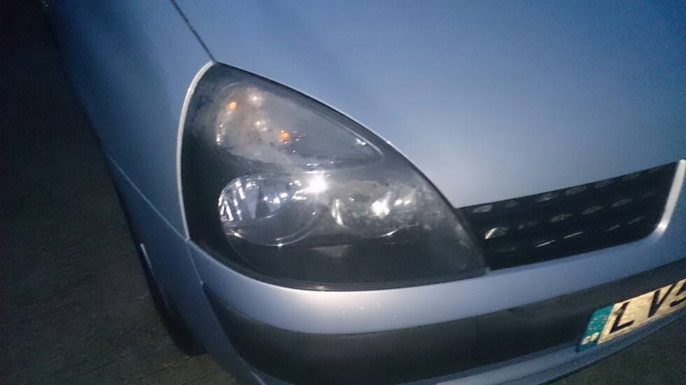

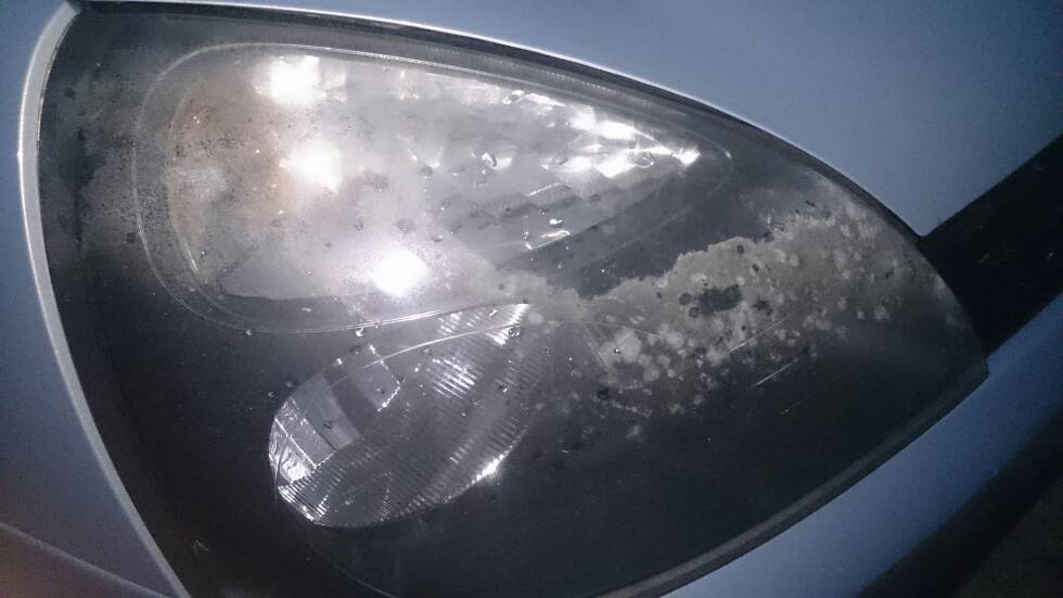

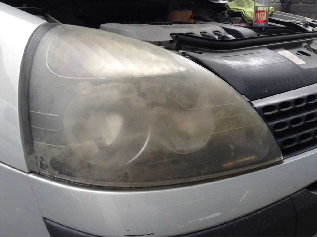

Hey guys,
Just wondering if anyone has any ideas how to get rid of light clouding?
This is my headlight below but the other side looks brand new :-(

Looks like moisture on the inside?
Check the seals, dry it out and make sure the seals are refitted properly
if it's hazing it needs sanding and polishing. Where are you?
  Mk 2 Clio 1.4 16V
Hello knuckles,
It's not moisture it's just been raining haha and it's hazing how would I sand and polish it? I'm next to Cambridge

Knuckles has it pretty much spot on, re; the seals.
Typhoon
Gangsta
  TT
Dry it out with some hosepipe and a hair dryer. See if that makes it any better.

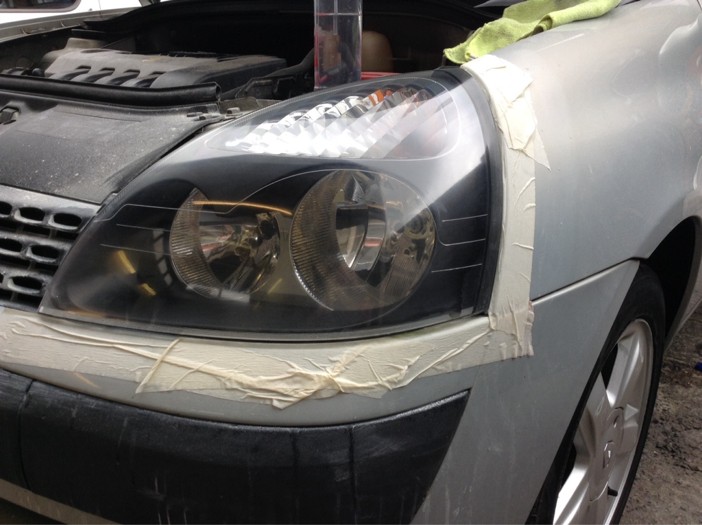

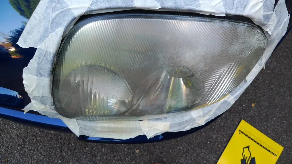

There's a few guides on restoring these. Most of the stuff you need can be bought from halfords too.
P1200-p2500grit wet and dry and meguires scratch x I believe is what people use
Daniel
  Whichever has fuel
Masking tape all around the headlight.
800 or 1200 wet and dry paper and keep going and going and going until the whole face of the light is smooth and not patchy.
Get some Cutting compound (heavy polish) on a machine polisher and use plenty of water as the plastic gets mega hot. If you burn it you'll have fucked it.
Then use some Auto glym Super resin polish on a soft pad on a machine polisher to finish.
Seal it or wax it regularly to increase lifespan of it happening again.

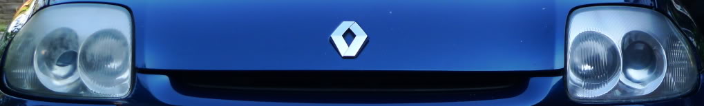

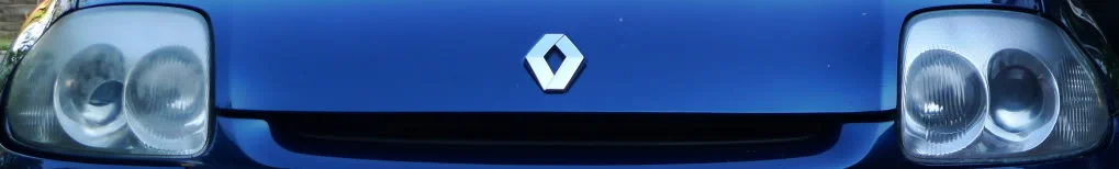

It should look like this before and afterwards...
cat171
You don't need a rotary, you can do it by hand. Plus if you've wet & dry'd it enough the compunding should be minimal.
I have to disagree. I've yet to see a set done by hand that don't look crap. Either that or they weren't bad enough to warrant a heavy sand and then machine polish.

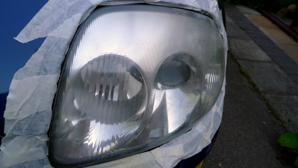

They look like new now :) and they were bad tbh. It took me about 90 mins to do them from start to finish.
I even did one of mine a few weeks ago as it had a couple of little scabby bits on the top, Ant had been over it etc, but I figured I could make it better :cool:
  Ph1 172.
On my Phase 1 I wet sanded them with 800, 1200 and 1500 then hand polished mine using Meguiars Scratch-X
