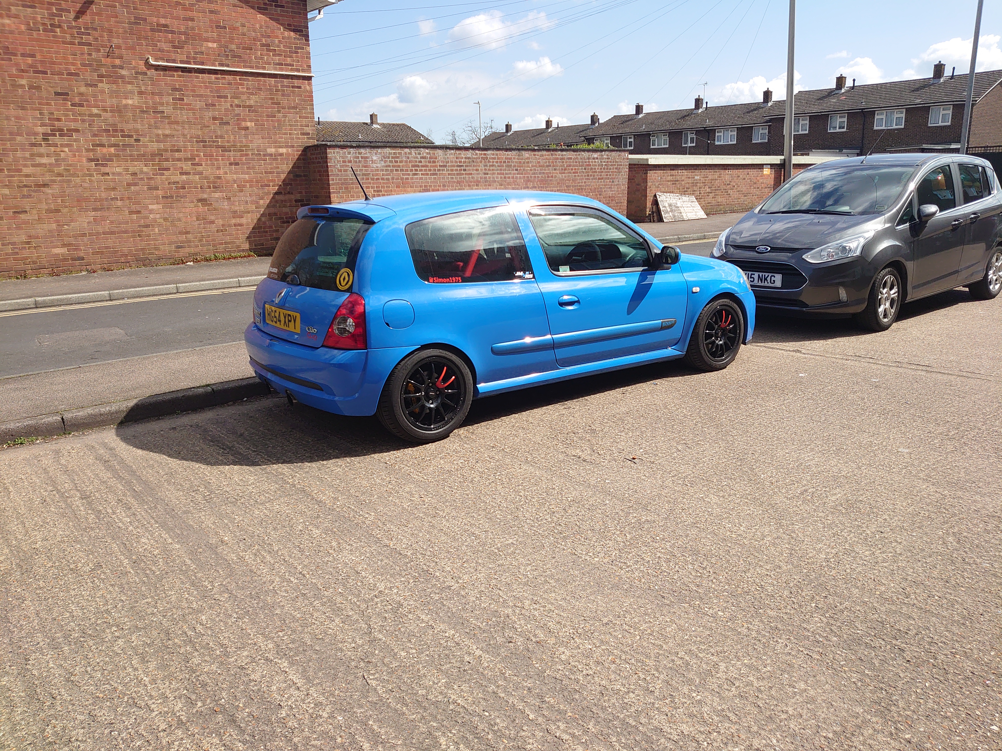

Just had BC DS fitted to my 182 Cup, to previously on Grams springs. A lot stiffer now and feels a lot quicker in the corners although not tested them on a track yet. Sits nicely on them and isn't horrible to drive.

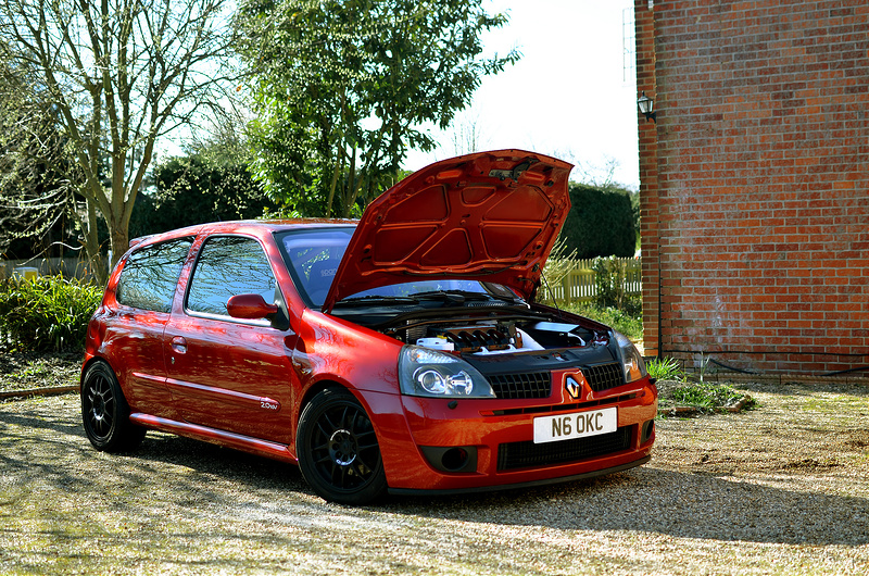

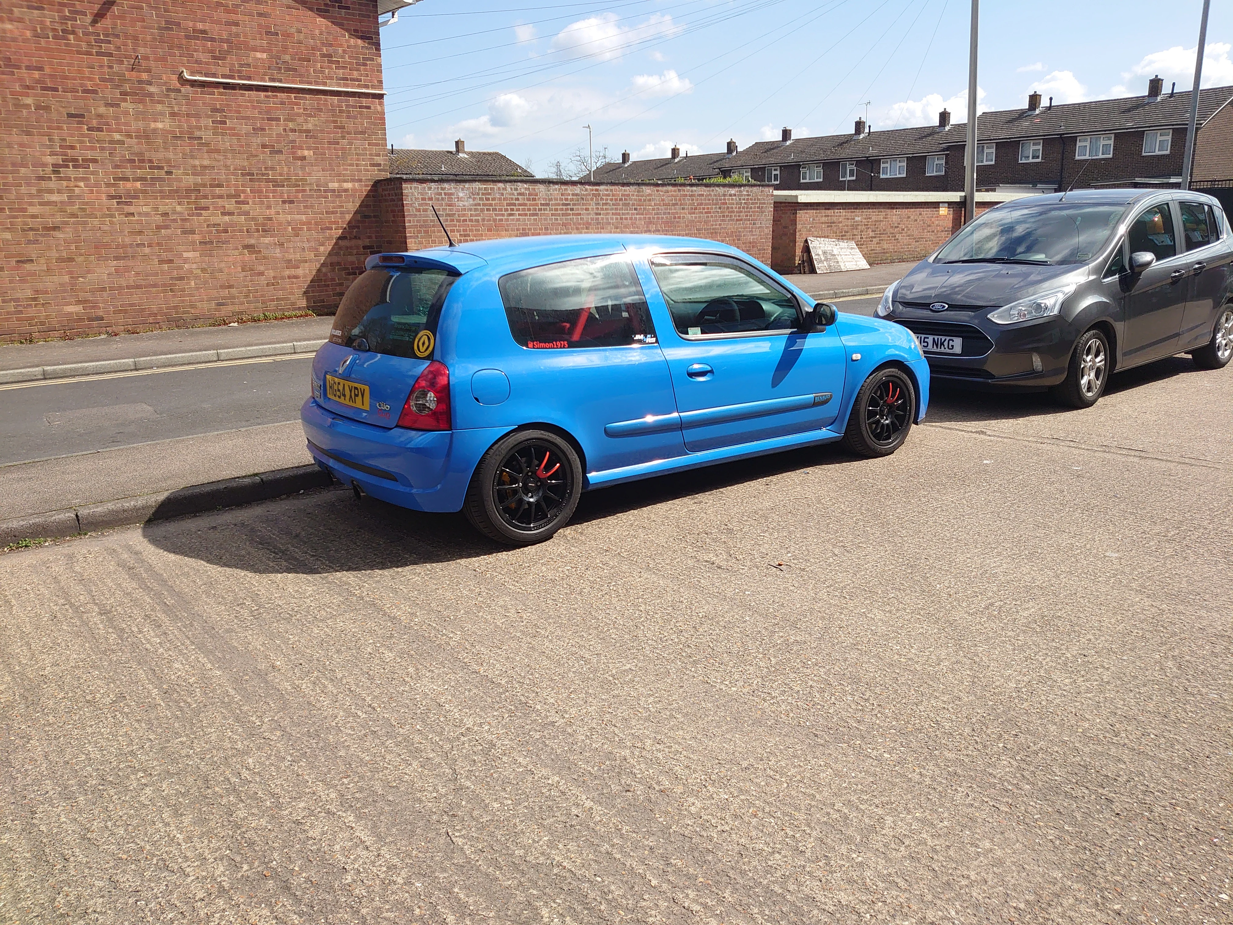

As @Daniel and others have said, if it’s predominantly road focused, you can’t beat bilstein B14s imo. Here is my old flamer sat on them;

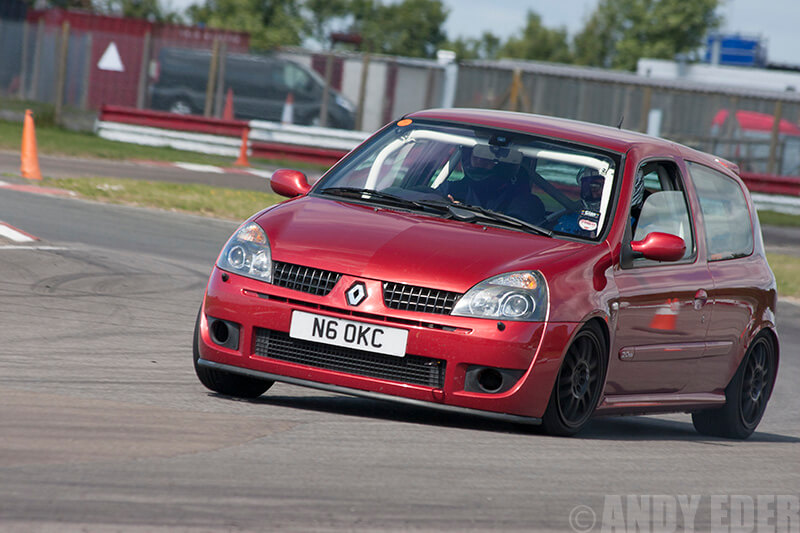

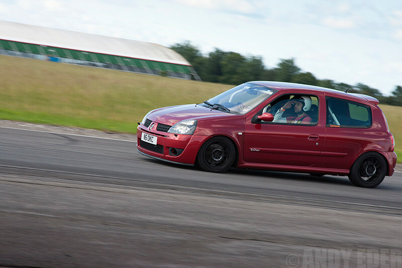

I swapped them to ASTs when the car became purely a track car because they are a little soft on track. As you can see from these photos on track, the compression is quite visible and they started rubbing when I pushed the car very very hard.
