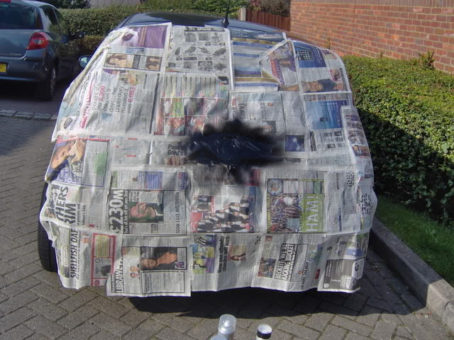

tis really easy to do m8y just plastic primer, your colour you want and laquer all done o yer plus some 1200 course :)

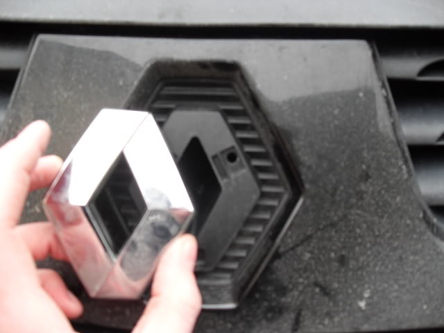

Front one pulls off, it has three 'prongs' which clip into their respective holes.

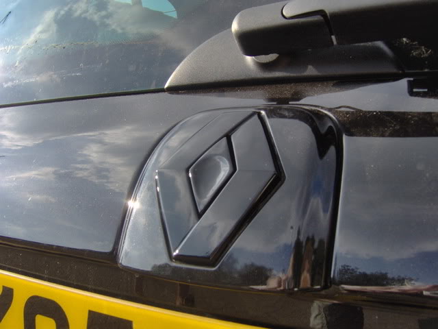

The back one is a lot harder, you have to take the entire boot lock off. Do a search, this has been posted before, with step by step instructions :)

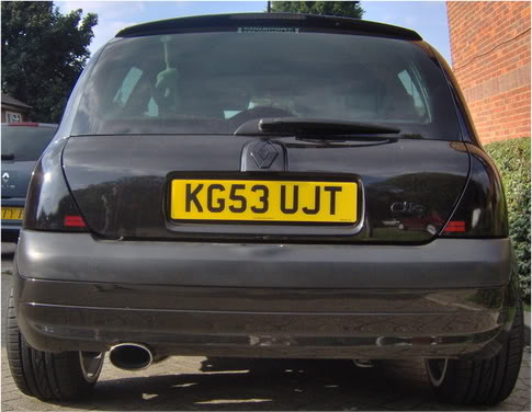

as said three clips m8y:
That may help show you the one you can see there one the other side and one at the bottom of the diamond. Use i small flatheaded screwdriver cover in some cloth so you dont scratch nothing. Just take your time and it comes off quiet easily m8y :)
