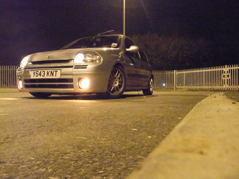

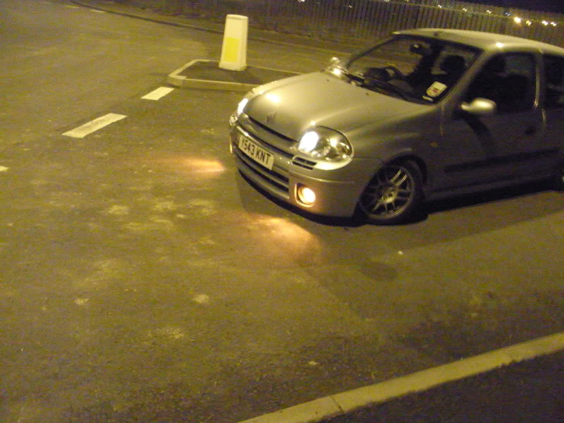

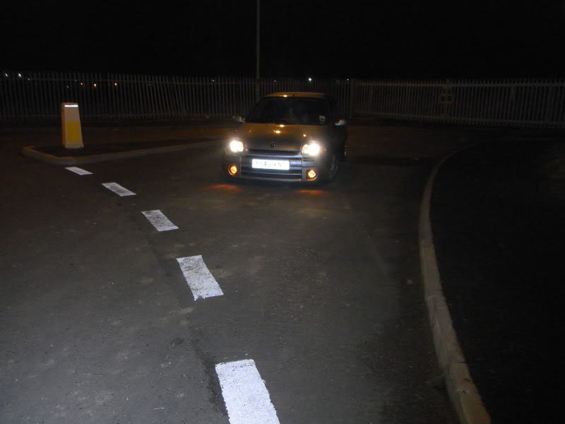

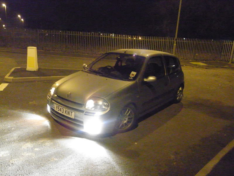

this is how it will look. easy to do aswell
fogs on
fogs off

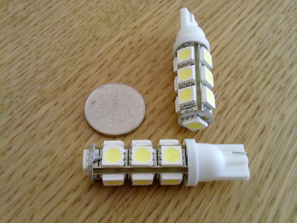

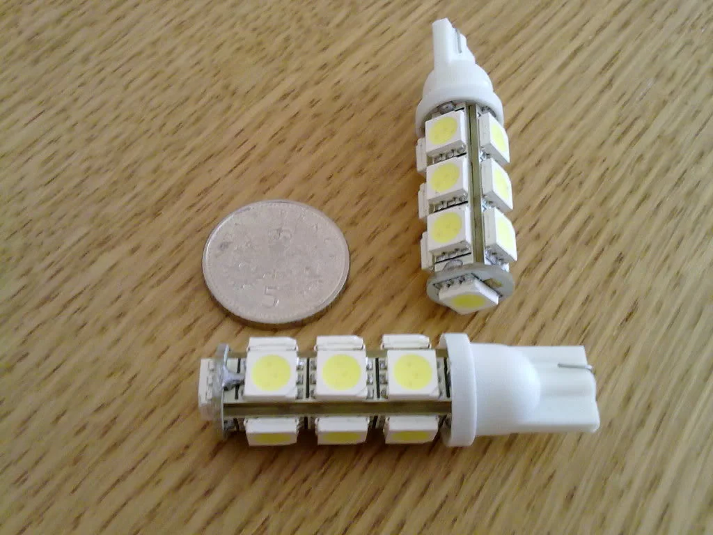

If you are going to do it then use these smd led's and you're on to a winner. standard halogen bulbs will look s**te. I might have to do this myself

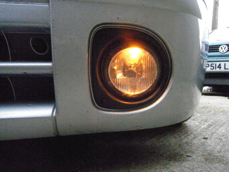

ok. so here it goes,
remove both your fog lamps. you dont need to take them out of the brackets though.
get your drill with a 12mm drill bit (perfect size for the clio bulb holder)
drill though the top of the lamp directly above the bulb but youl need to do this at a 45 degrees angle or the bulb holder will catch on the crash bar when you refit them to the car and they just wont fit,
you need to take it slow when you get to the metal reflector because when the drill grips on the last bit youle end up going through the bulb and the cap and make a big mess.
i decided to squeeze some sealant between the lamp and bracket, to make sure its water tight, let it set before you put your bulb holder back in though or itl be a strugle to change the bulbs in the future.
i havent done any pictures for the wiring, because thats streight foward, just cut into the side light wiring for the headlamps, or you can do it in the fuse box in the engine bay. look for the light loom and find the 2 blue wires. there both power feeds for the side lights.
now put them in
