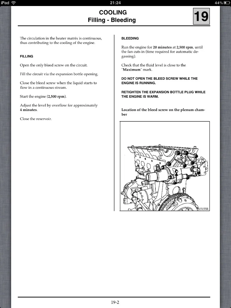

Here you go
Take the bottom hose of the rad then just fill the expansion bottle up also worth doing the thermostat while your dumping the coolant
As GTi6steve said do the thermostat aswell its hugely overlooked and never changed, also consider changing the cts
I drain the coolant, cut pipe and fix new pipe to oil heat exchanger, fill coolant up until it pours from the bleed screw. Tighten bleed screw start engine top up as required put cap on header tank. start engine and run until fan cuts in. check all at max, retighten cap.
Job done.
