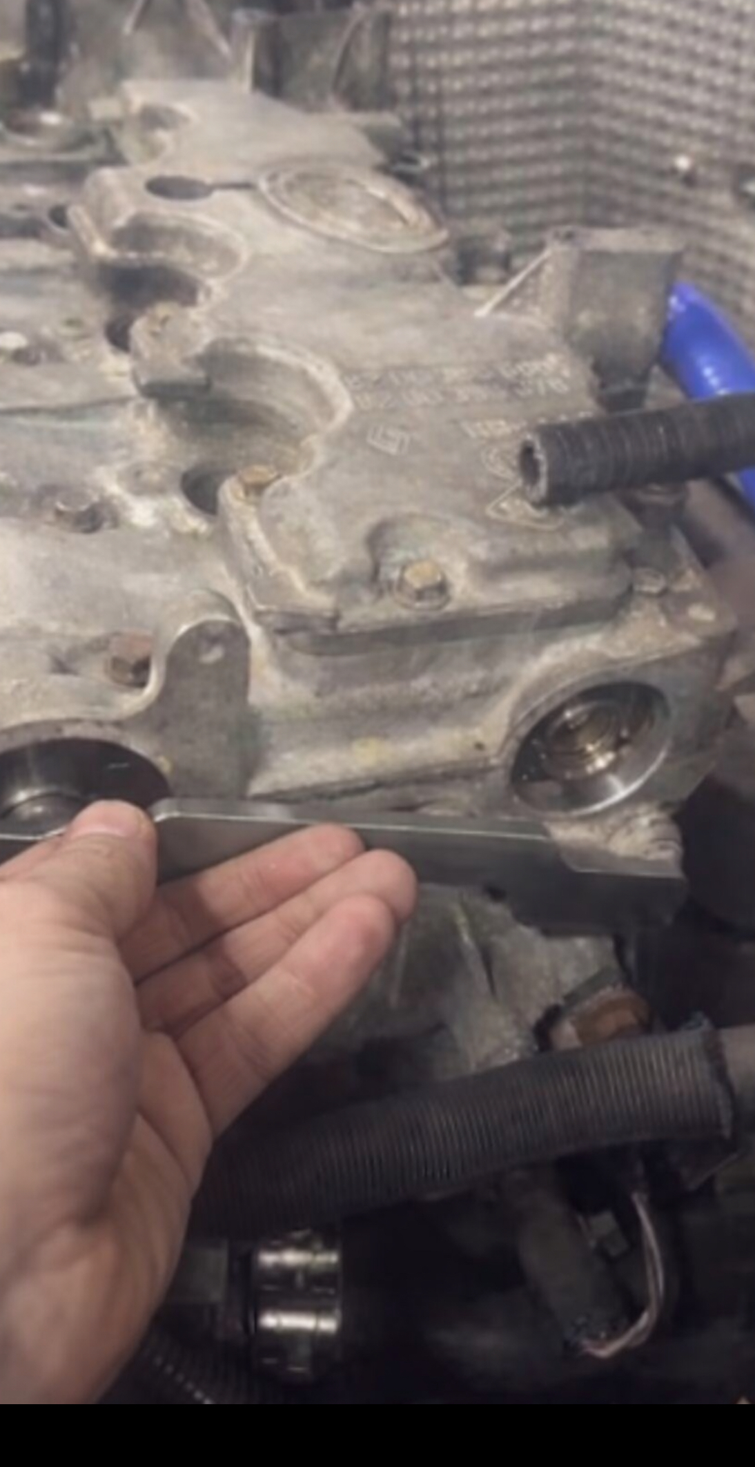

Not the best picture, thats with the 7 degree horseshoe. I have checked with a boroscope and theres no signs of contact. Tensioner seems all good aswell. Going to retime it and see what the figures look like then

did you replace the dephaser? were the exhaust cam and dephaser fasteners torqued correctly?
that's significantly out. have you got a keyed bottom pulley? you need to check if the tensioner has slackened off or if the bottom pulley has spun, but it's not looking good.
I didnt replace the dephaser as it was only done last year, did exhaust to 110nm and inlet to 100nm, the tensioner still looks good the mark lines up. i tried it with the standard horsehoe tool and it almost fits, the exhaust pulley has moved one tooth and the inlet which was at 7 degrees is basically fully flat? maybe not torqued up enough
Think they should be done to around 125Nm so maybe just wasn't quite tight enough! Hopefully you've avoided any serious damage. Here's a list of the torque settings for the belts and pulleys, if you haven't already got it:
