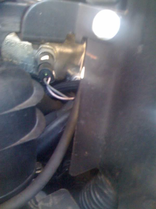

Is this the sensor (picture taken from where the battery usually sits)?
All looks ok if it is :S
Can Anyone shed some light?

My car was struggling to start, idling high etc and I replaced the coolant sensor and now its fine.

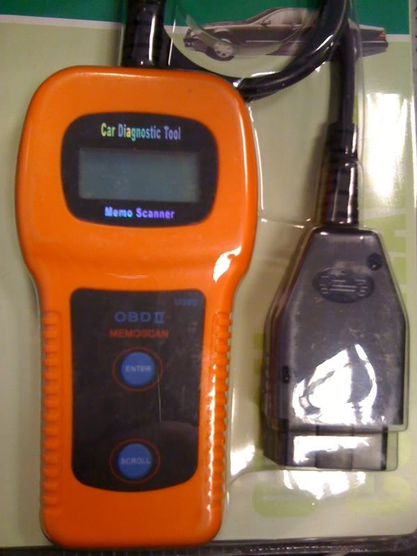

Oh well.. this arrived today and should hopefully verify that my coolant sensor is jiggered - I'm 99.8% sure that its the same one as that on the K-tec website -
(The only difference between mine and theres is that the bottom button says scroll instead of clear & the text across the top reads memo-scanner instead of auto-scanner) - Same model number, so surely its the same reader??
Could someone point me in the direction of where the ECU plug is to plug it in?
The plug is under the ash tray holder
Plug it in turn the ignition on but dont start the car

Thanks for the heads up - i'd have never found it under there!! Had planned on looking around the ecu in the engine bay and behind footwell panels (a'la my old fiesta!).
Interestingly no faults came up when i plugged it in! (However the last day or so the sensor has been fine, climbing and reading as it should.. so maybe its a loose wire!?)

I took my ashtray out and just leave my rstuner plugged into that.
What stuff can u do with that then?? Turn off a few lights and basic diagnosis I reckon???
Will the ecu even show a fault for temperature sensor? I wouldn't think that it would as it will just think the waters getting hot and cold.
Also you will not loose much water swapping the sensor if your quick and get a finger or the new sensor straight in the hole.
You can't do alot with it really, just brings up fault codes and your able to erase them that's about it, as above though, it didn't bring any faults up on mine.

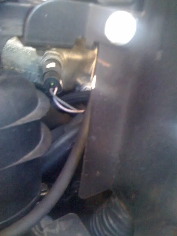

received my new sensor today (thanks Da) and noticed that theres a green wire that looks like its been chopped off - you can see it in the picture protruding from the back of the sensor, is this correct or should there be a third (green) wire?
No thats fine the green bit is just a rubber plug sealing plug, its only a 2 wire sensor.

Righthand side of the engine as you're looking at it, on the thermostat housing.
^ I took the picture with the battery removed - however in practice you only need to remove the airbox to gain access
