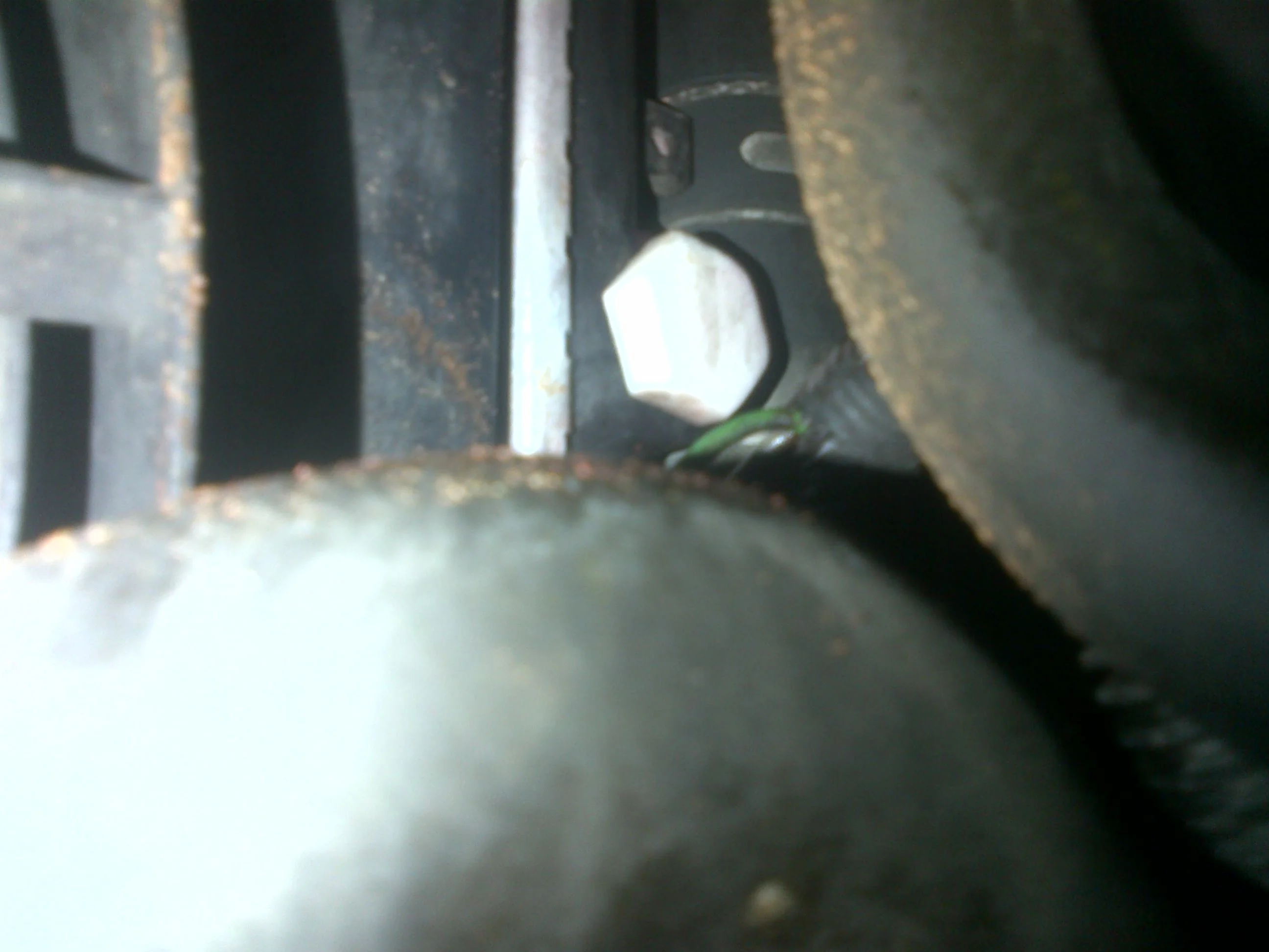

Pulsator Car Monaco 172 Ph2 Sep 3, 2012 #1 Can anyone help me out and tell me what this white plastic bolt looking thing next to the radiator is please ??? Thanks.
F Fred@BTM Car Lionel Richie Sep 3, 2012 #2 that me boy is a non genuine radiator with a blanking plug, take it out, silicone it up and whack it back in
Pulsator Car Monaco 172 Ph2 Sep 3, 2012 #3 Well i know the guy before me had the radiator replaced with a non genuine one as have the receipt, which doesnt really bother me - or should it :s ?? Any particular silicone sealant ie. high temp - or will just standard be fine ?? Thanks
F Fred@BTM Car Lionel Richie Sep 3, 2012 #4 yeah high temp, you can buy a new plug from GSF etc for a few ££ should have a new O-ring with it
Struggler ClioSport Club Member Car Ph1 track 172 Sep 3, 2012 #5 could find someone breaking a 172 and pick up a genunie rad for cheap!
Pulsator Car Monaco 172 Ph2 Sep 3, 2012 #6 Would you recommend buying a new plug and siliconing it before i fit it ??? And cba getting a new rad fitted tbh lol
Pulsator Car Monaco 172 Ph2 Sep 5, 2012 #7 Thanks for the help guys - couldnt find one anywhere from any motorfactors, in the end had a brain wave and went to a plumbing merchants and picked up a brass flange thingymibob for £1.20 perfect fit, Happy days
