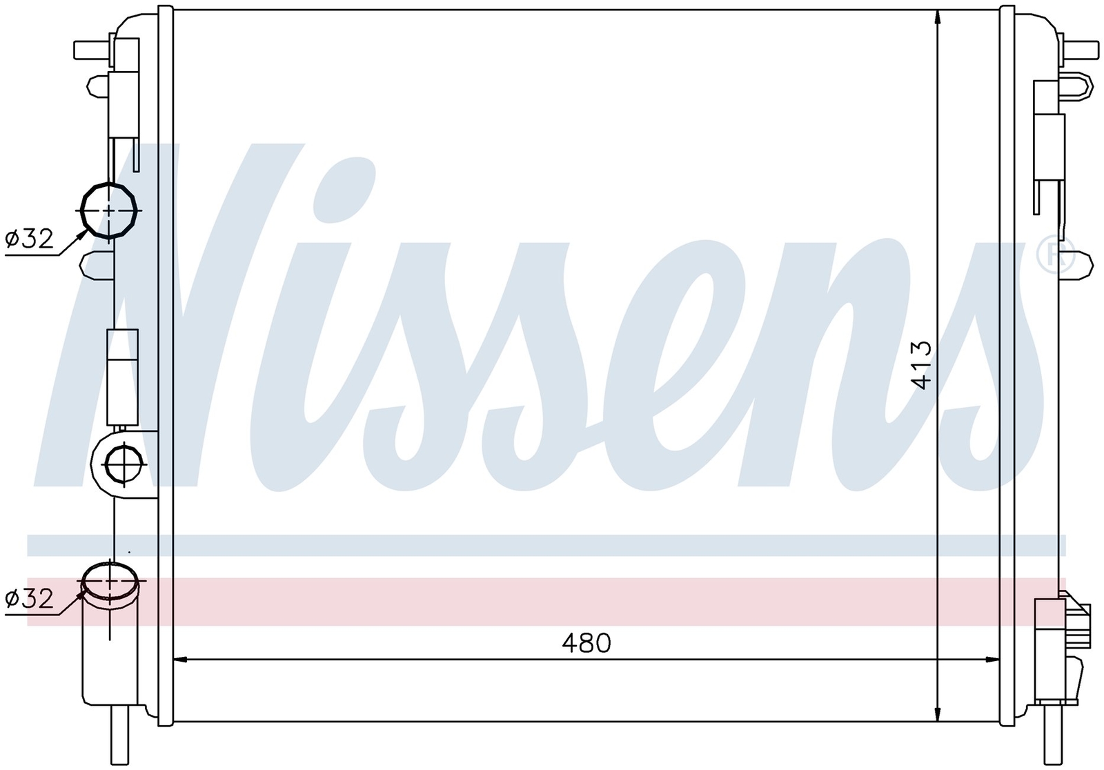

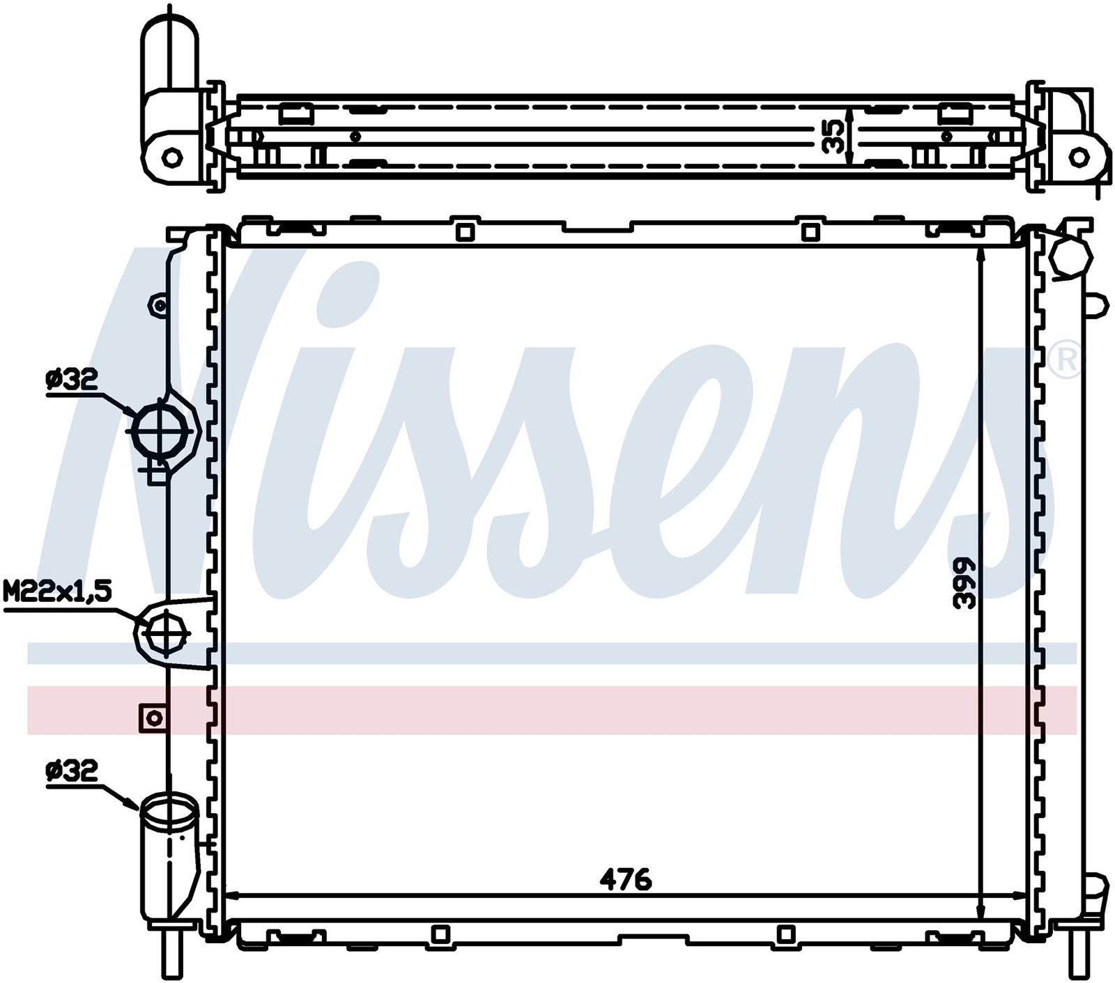

So I went ahead and ordered a Nissens 63768, the company I ordered it from messaged me asking for my reg and if I had air con or not. They replied saying this radiator was incorrect and would not fit, so wouldn't sell it to me.
They then said that the part number for the radiator I need is 7700428082 they have it in stock but apparently there's too variants and they need to see photos of my radiator before they'll send me it.
It's one of these 2 apparently, mine is still in my car and it'll be a while before I can get it out, I wanted to do a straight swap when I had the new one.
Don't suppose anyone on here could identify the right one from these pics? Someone on here must have bought a replacement radiator for a 172 cup.

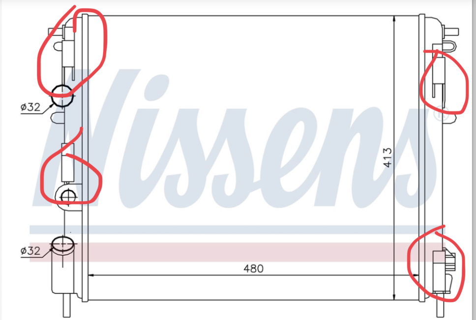

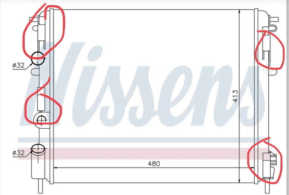

Looking at this thread again I can say that the Puremotorsport Cup rad is the correct one. Also the top picture above Is the correct one for a Cup. The difference is the hangers for the rad fan as I have circled. The other difference is where the 2 brackets push fit at the top where it bolts to the slam panel. I hope this helps
