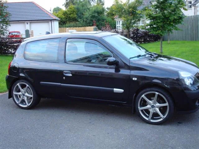

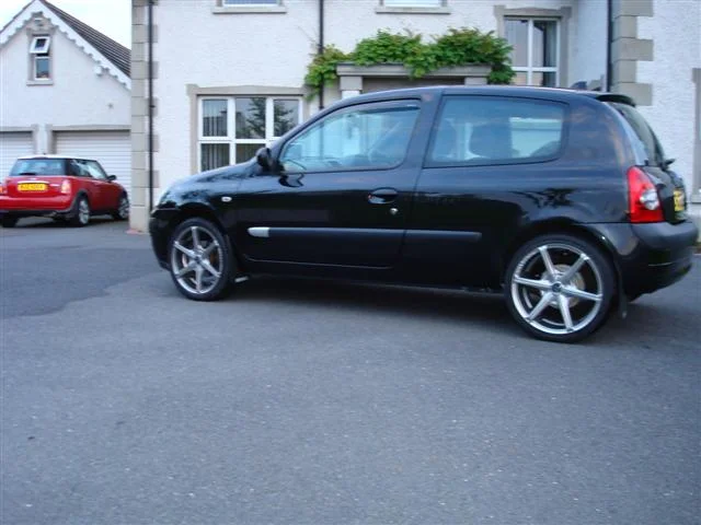

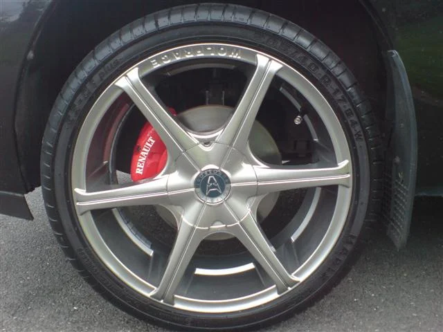

Hi,
When I purchased my car there was a set of 17" Wolfrace alloys on it with low profile tyres.. Great I thought, but now I am beginning to believe that the size/weight of the wheels are affecting the reading of the speedometer...
This is slightly worrying as I believe its illegal to have a unaccurate speedometer. (unsure)
I did a simple test, I drove the car at what I thought was 50mph (didnt feel like 50mph) and my mum followed close behind but her Mini which has a digital speedometer and that said she was doing 38mph! Meaning my car was saying I was roughly doing 12mph more than I actually was.
Has anyone ever come accross this problem on their Clio before? and what can I do about it? A few other people I have asked say its the wheels, does anyone else have any suggestions? Can it be fixed?
I really dont want to have to go to the expense of changing them!
Thanks for your help.
