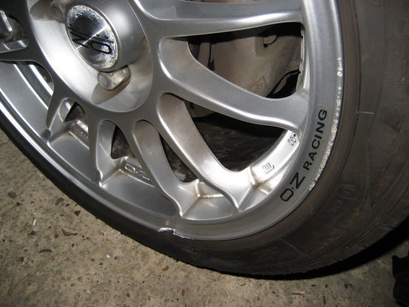

Could this superleggera be refurbed?
Car  6/468 17poo
yeah it could i had somethig much worse on my smart cars 17" wheels (i'd of replaced them but as mine was the only smart with 17's in the country at the time)

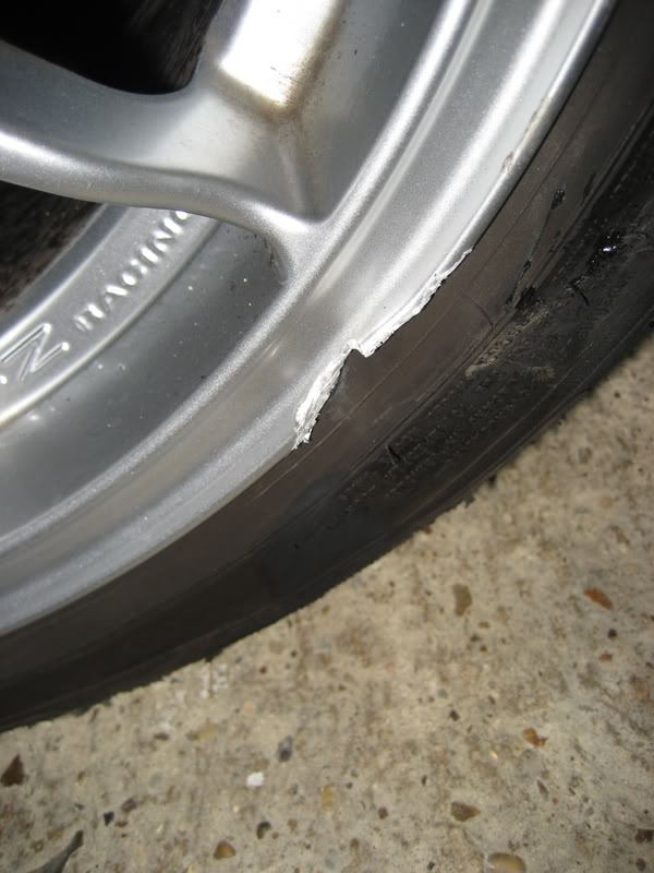

I certainly wouldn't drive on it afterwards.
The only way that could be Safely repaired would be by alloy welding a new piece in and machining it. By the time you've done that it would be cheaper to buy a new rim.
The minor bits are within the scope of "cosmetic" repair but a bit pointless if the rest is cream crackered.
Well im takin it to a renouned wheel refurber, so hopefully he'll tell me the deal!i would buy a new one but cant find a supplier for s**t as the ultralegs came out!
a bloke in essex done cupra r rims for my b/f and one was just like that he fully alloy welded it and refurbed all 5 18" alloys all for £225
Yeah thats repairable. I took a similar chunk out of one of my turini's on a late night run in Wales last year and got Spit And Polish to refurb it....came back better than new.
